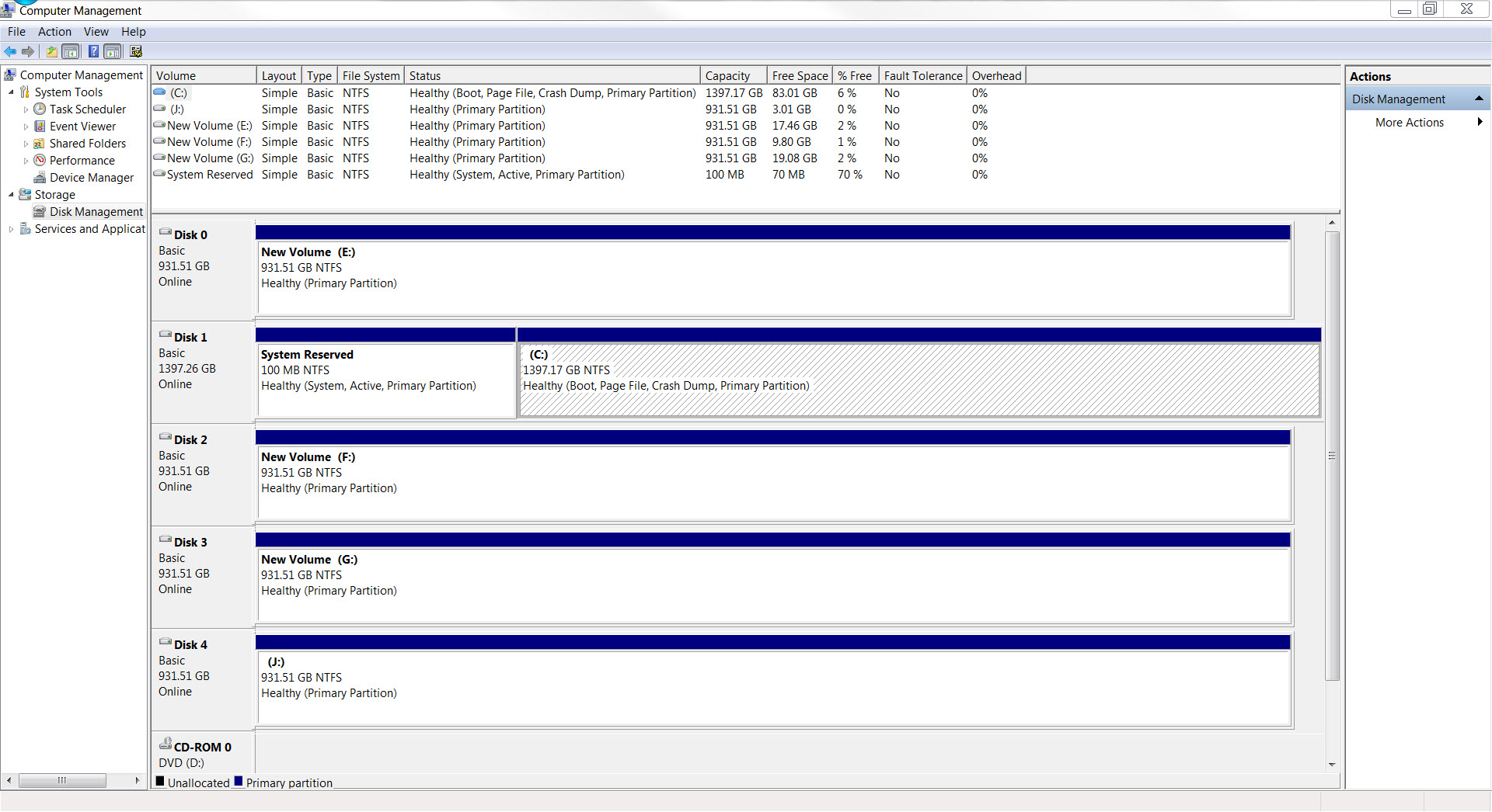

The issue is possibly being caused by the lack of available free storage space on the HDD/s, please see my canned text below;
Please note that you must always have a minimum of between 15 and 20% of a HDDs overall storage capacity available as free space or you risk the data on the drive becoming corrupt or in a worst case scenario mechanical failure of the HDD itself.
The above can render a computer inoperable if the HDD concerned has the OS on it due to the MBR (Master Boot Record) becoming damaged/corrupt, please see information @ http://pcsupport.abo...sterbootrec.htm
Go to Start then to Search
Now I need you to take an expanded screenshot and attach it to your next reply.

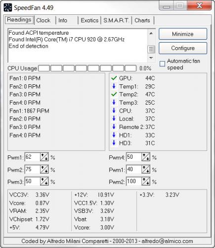

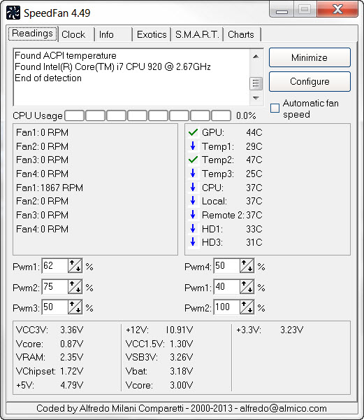

Download Speedfan and install it.
Once it's installed, run the program and post here the information it shows. The information I want you to post is the stuff that is circled in the example picture I have attached.

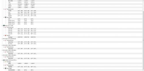

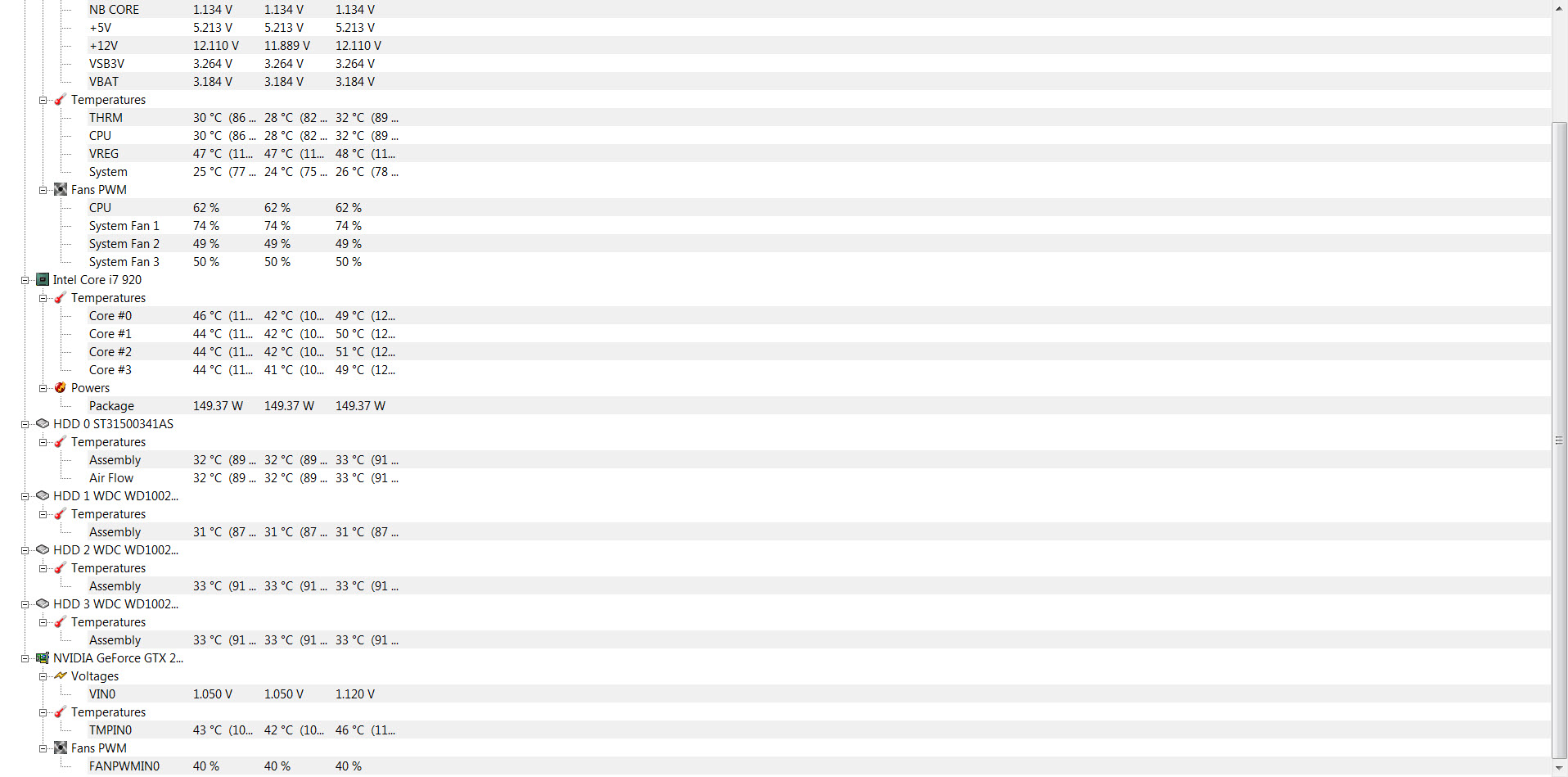

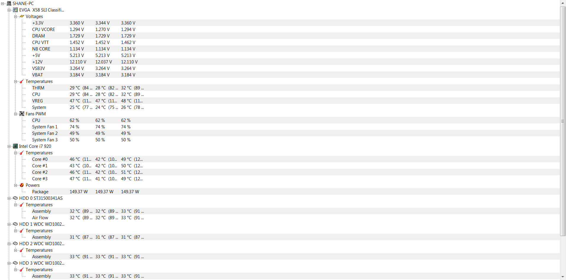

I appreciate all of the help with this headache that has been plaguing me. I have attached a bunch of screenshots. I downloaded the CPUID software and uploaded the txt files from the software and also took some screenshots of what I was seeing as well. Again thanks for all the help. If you need anything else please let me know.

  • 24,786 posts
Hello shane007f - thanks for the comprehensive update :thumbsup:
Everything in Speedfan with the exception of the +12V rail on the PSU looks ok, Speedfan does sometimes show an off reading or two hence suggesting running a second program for comparison which you have done and the HWMonitor reading is ok, these readings can change dramatically though when you are gaming etc.
The low storage space on the C: drive needs to be addressed first as Windows needs more space to copy data to and from or it will corrupt, you can make a start on this yourself by uninstalling any unused programs such as games that you no longer play, if a program has it`s own uninstaller use that but if not it is ok to use the uninstall a program option in the control panel/device manager.
