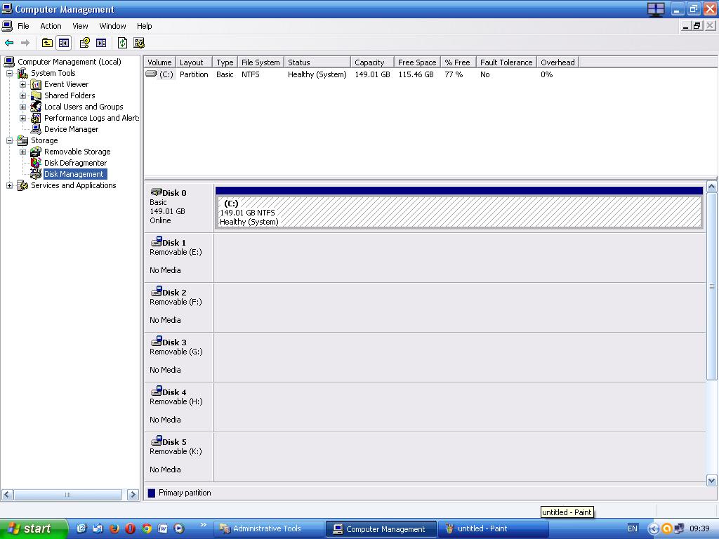

Do you want the good news first?........ No, actually I will let the screenshots tell you the current state of play........
This is my computer right now: -

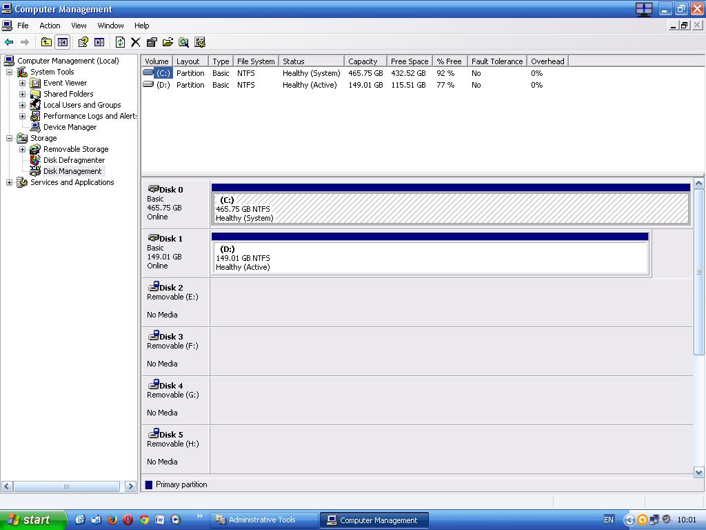

I know..... it doesn't look amazingly promising! But this picture - from 5 minutes ago - looks a bit more
interesting: -
This would be great news - indeed it is wonderful news - but for the fact that the second screenshot was taken before the first. When I turn the larger drive back on, that becomes Drive C and the smaller drive reverts back to Drive D.
There is no way that it is going to let me change the title letter of drive C; it just tells me something to the effect that the letter of the drive with the system files on cannot be changed!  :bashhead:
Any ideas?
Still, it is very good news..... I have actually made some progress at last!!!! :) :)

The problem that you will have with the drive letters is that as long as you have XP on the larger HDD and the drive is enabled Windows will automatically allocate it the drive letter C:, this because it is deemed as the primary/master drive by having the original XP installation on it and by the motherboards BIOS by the drive most likely being connected to SATA port 0/1 on the motherboard (not all MBs use a port 0 identification number but begin with port 1 instead).
The plan from the outset was to use the smaller HDD for XP and the larger HDD for data storage only and that is why I have suggested that you leave the larger HDD disabled and boot from the smaller HDD, this is to make sure that you have no issues with your cloned XP, once you are 100% happy that all is well you can try cloning to the external HDD again but this time do it from the new smaller C: drive, once done you can format the larger HDD and allocate it an appropriate drive letter.
Understood. The larger drive is indeed connected to port 0, whilst the smaller one is connected to port 2. This confused me a lot when I was making my first cloning attempt, as I (very stupidly) assumed that if the larger drive was connected to port 0, the second drive must be connected to port 1. :(
