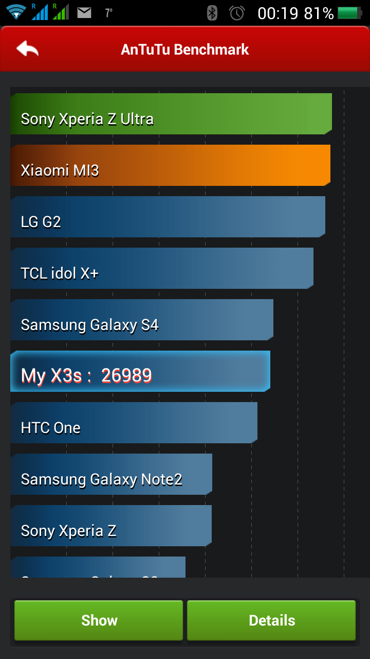

Benchmarks:
Nenamark v2: 57.7 fps
Antutu (from Playstore) score: 24654 (with CPU limiter set to ON in battery options)
Antutu (from Playstore) score: 26989 (with CPU limiter set to OFF in battery options)
http://peecee.dk/upl....8-00-19-22.png
