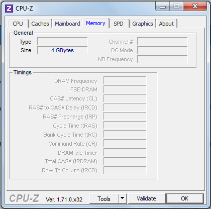

Download then run CPU-Z, click on the Memory tab, take a screenshot of the results and attach it to your next reply, CPU-Z here

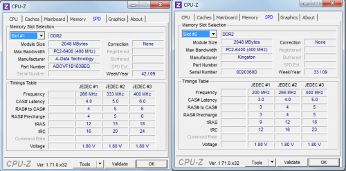

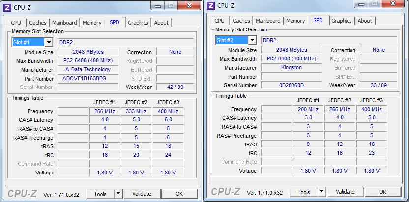

I dont think You will be satisfied about the result :D Take a look on attached picture :) Maybe there is a problem with my ram?
EDIT: I added something more, second picture where is something more writted about my ram

Hi Wojtek, like Phill says in post 70, software wise not much more can be done, though Avast, your antivirus is now known to be a bit top heavy and a less resource hungry antivirus could be used instead.
Otherwise, the hardware is now a bit of a bottleneck, the hard drive is a slow one as also the RAM being of two different makes might also be adding some time. Without going back, I don't know if the motherboard specs have been mentioned so don't know if it could take DDR3 instead of the DDR2 that it has at the moment, or even if it can use more than the 4GB. We would need the full name and model of the motherboard to find that out.
Otherwise, the information from CPU-Z shows nothing more different than the Speccy result way back on page 1 post number 8.
To recap, what you are seeing at first start up with the high CPU use is nothing more than the Windows system taking everything it needs from the hard drive to put it into the RAM so it can run, a slow responding and running hard drive, coupled with slow responding RAM, may well be the problems now.
A suggestion if it can be afforded is to change the hard drive to a faster one, or better still a similar sized SSD (Solid State Drive) and faster operating RAM, the second one of course depends on what the motherboard can use.
As an example, my system was around two and a half minutes to get to being usable from first start, I installed a SSD drive recently and it is now less than fifty seconds, though I do have DDR3 fast RAM installed already.

:oops:  missed the updates!
