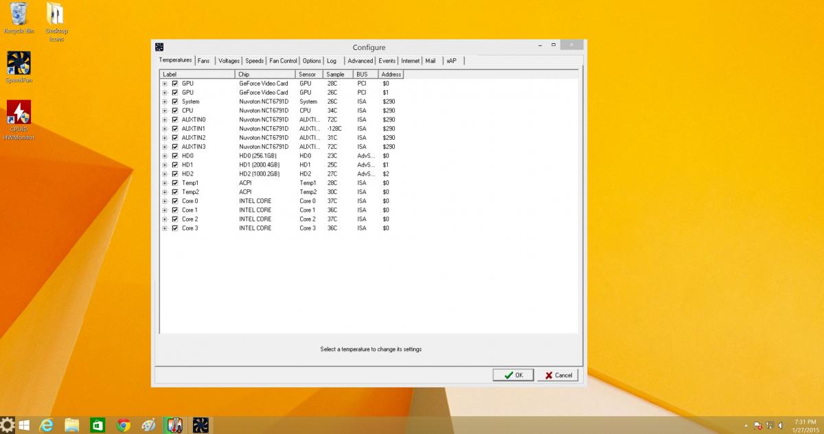

Download Speedfan and install it.  Once it's installed, run the program and post here the information it shows.  The information I want you to post is the stuff that is circled in the example picture I have attached.

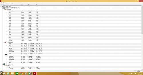

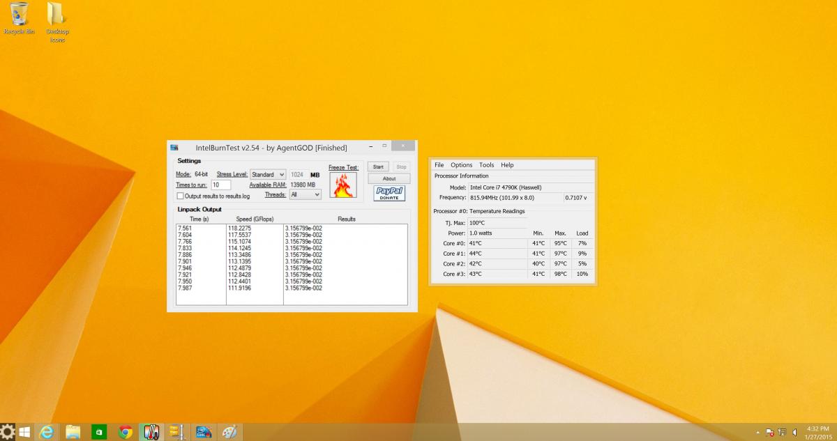

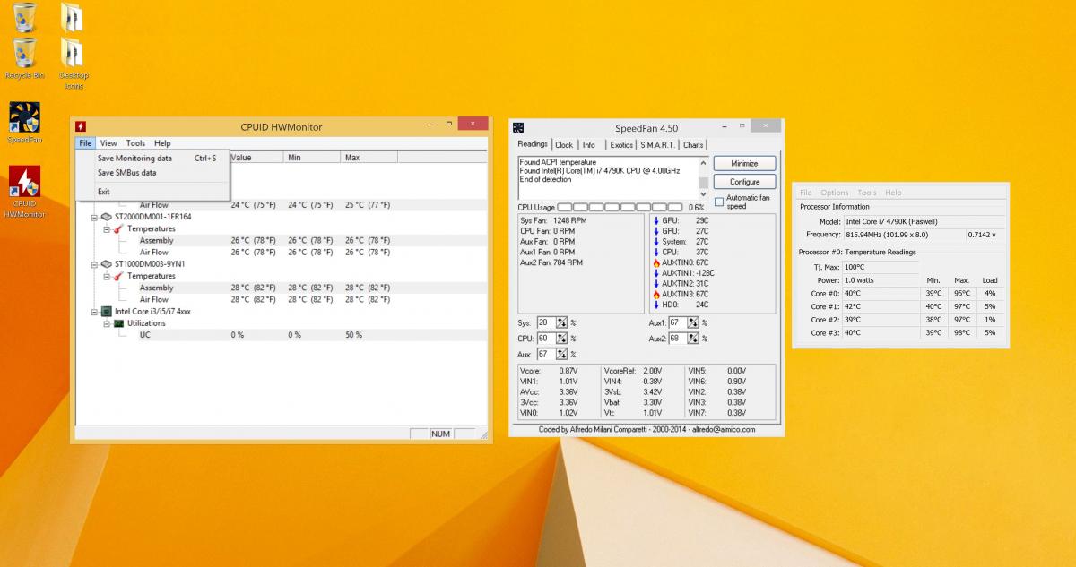

ok I checked bios no settings to change shutdown temp. next I ran intelburn very scary computer got very hot without shutting down as you will see in pic. then I ran speedfan and hwmonitor here are the pics

Missing a lot of the HWMonitor information, can you provide individual expanded screenshots of HWMonitor + Speedfan and as detailed in my reply #36

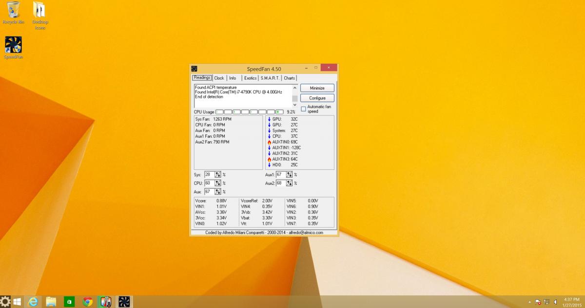

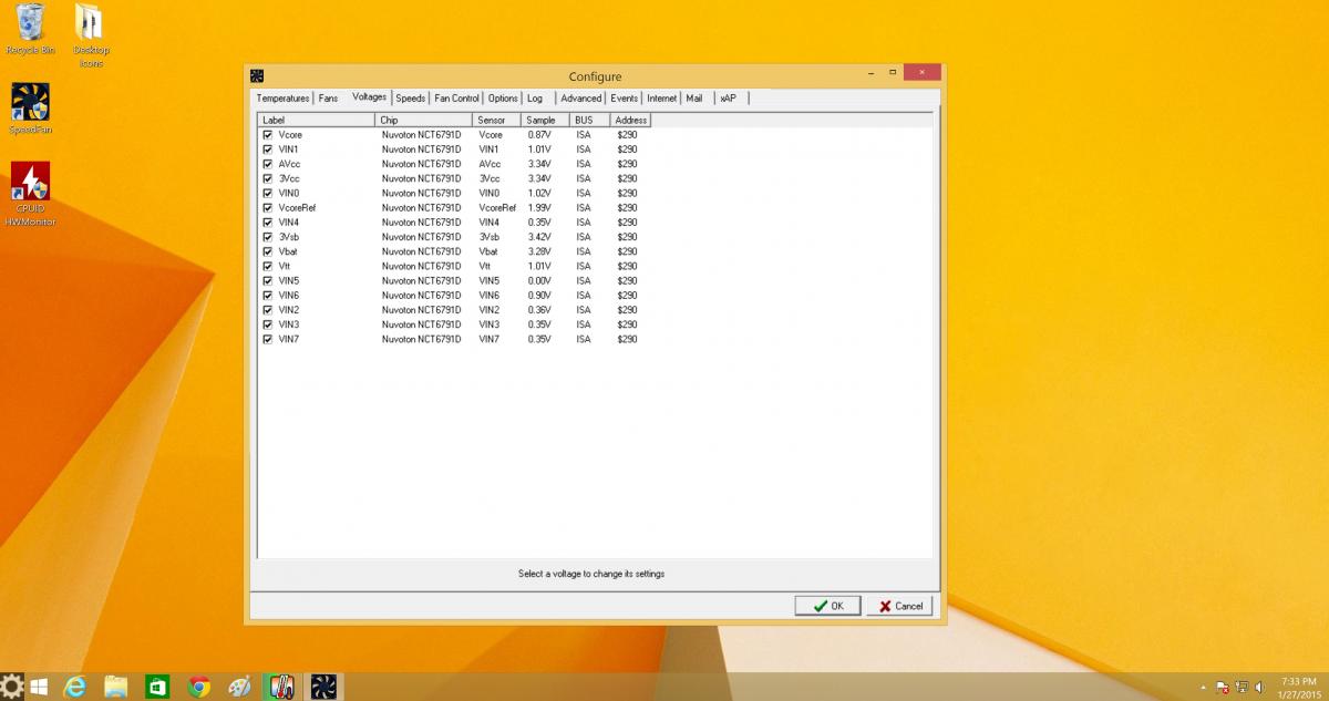

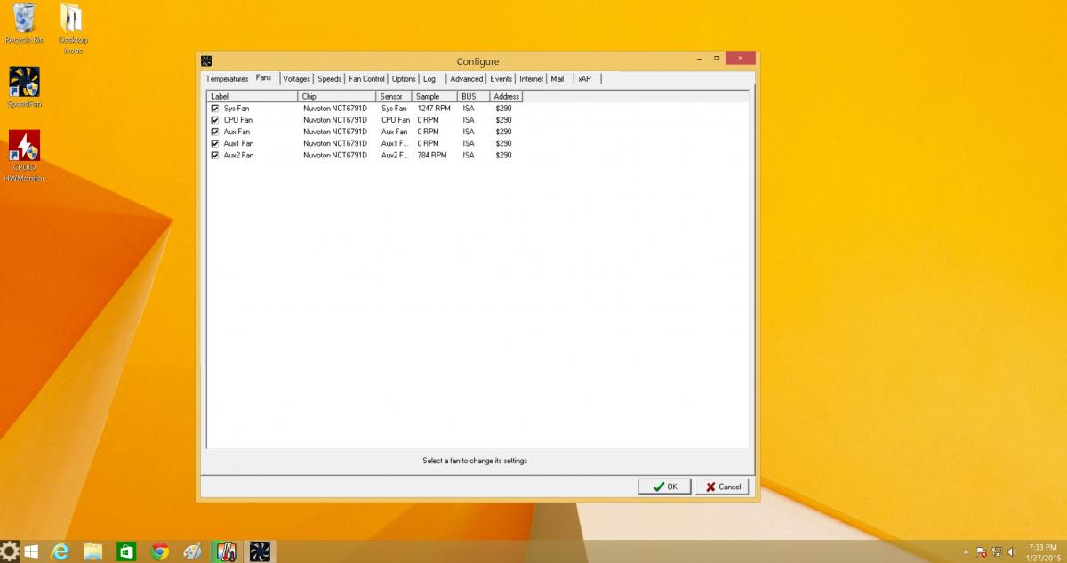

hope this is what you are looking for here is speed fan

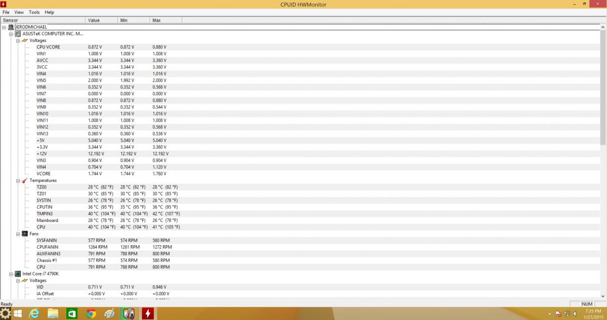

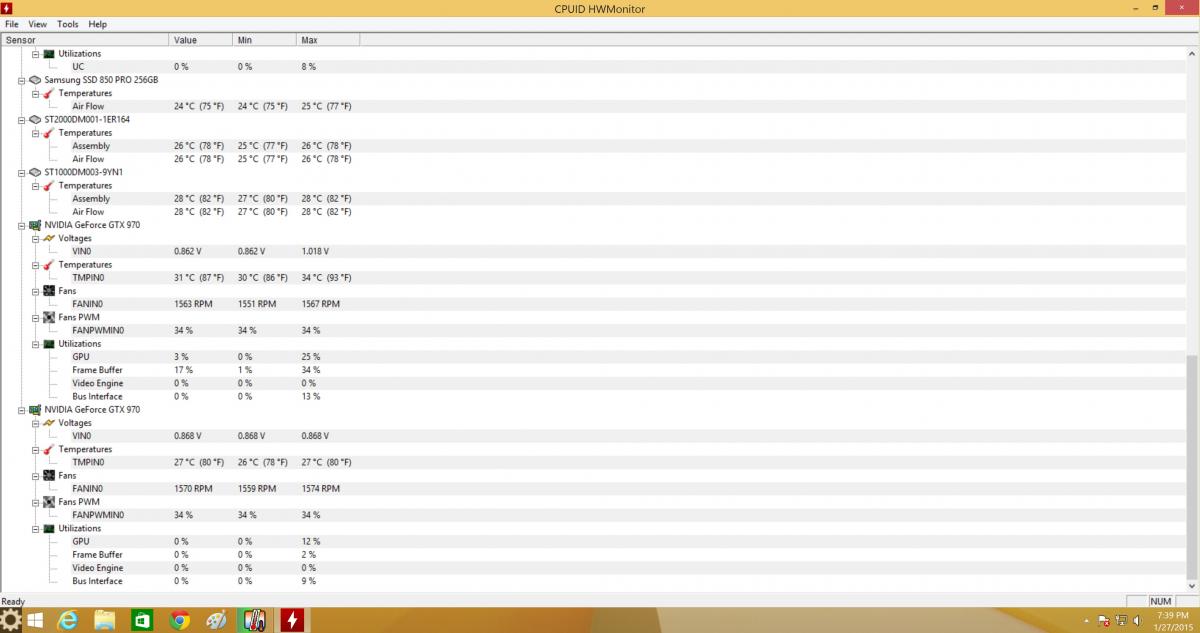

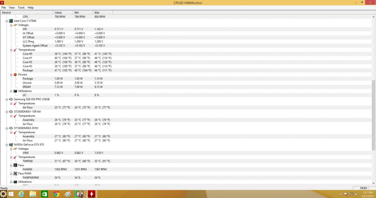

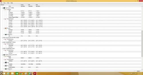

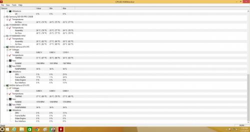

hw monitor

temps and everything is fine at normal load, so i'd say your case cooling and build itself is good, the only problem is the stock heatsink is not up to the job of managing the temps when the cpu is stress tested at 100% load,
people rarely, if ever, run their cpu's at 100% load,
even when gaming i'd be very surprised if it got anywhere near that 100% load and reached those sort of temps again.
only time i can think of when the cpu is run under that much load, is when you run a distributed computing program like folding at home or are actually running a stress test program like prime 95 or some benchmarks.
i think thermal shutdown is 100C for intel cpu's
the only cure to keep the temps lower when cpu is stressed is to fit an aftermarket cooler.
run it as you normally would, keeping an eye on the temps, and i think you'll find your temps will never reach anywhere near those highs again.

Temps and voltages are fine and for your planned use you will only see an increase in these if you do decide to overclock the CPU.
FWIW the max TDP for CPUs differ and Intel state a maximum safe operating thermal temperature of 74.04°C for your CPU and CPU World peaked it at 72.72°C, see here and here
See how you go with the stock cooler under normal usage and if you do consider OCing the CPU check out the Intel OCers warranty.
