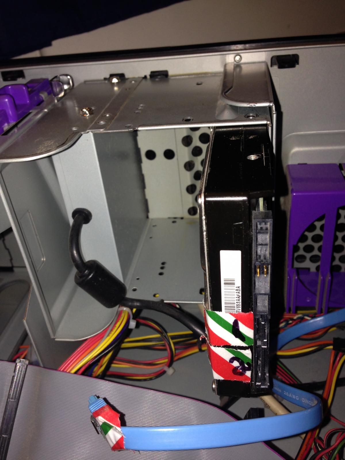

IMG_0262.JPG Last night for the heck of it I went ahead and tried to reinstall the OS, but it came up that it couldn't access the hard drive cuz there was a driver missing that allows you to access it.  Have you ever heard of that? If so where do I find it?  Also I tried to remove the hard drive and I cant figure out how to do that.  I am attaching a pic and maybe you could tell me..Thanks again.  I am going to Best Buy this morning to get a new hard drive.  Here is the picture.  Thanks             Colleen

now to get your hard drive out, sorry to say depends on each case and how many screws were used, usually though you need to take both sides off the case to gain access to the screws on the opposite side of the drive, when all screws are taken out it should just slide out easily.
by the looks of it in your case you may need to either remove the whole drive cage to get to the rear screws (near front of case.) because of that metal bit on the bottom or somehow remove it to gain access, that's if the builder even used screws behind that bit but usually you'd either expect 4 screws to be used or none at all depending on if the drive was in a tool less drive bay (which of course yours is not.) .
so sorry no instructions except trial and error and don't force anything, if you need a lot of force then usually your not doing something correctly.
