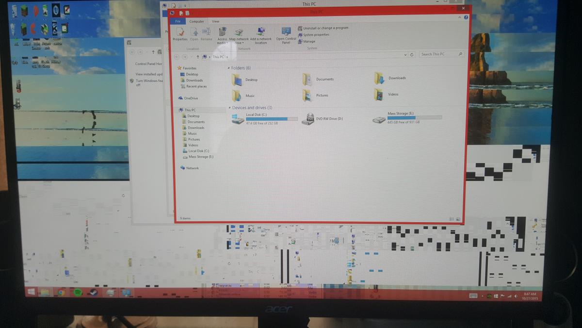

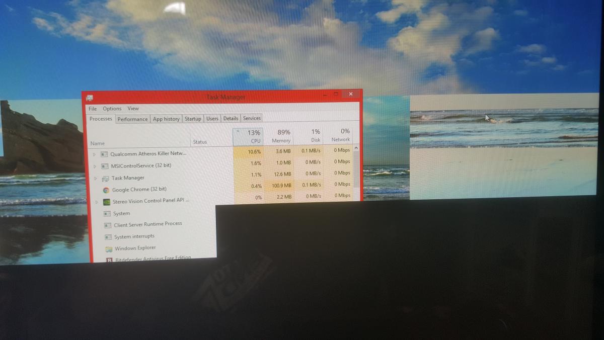

Okay, so I built my computer about a year and a half ago with the help of this forum. It has been really trustworthy and not had too many problems or issues, and they were all minor problems. But this one I think might be hardware related. The problem is that when I go to sleep, or when I leave it idle for an extended period of time, it seems the computer blackscreens and won't respond no matter how long I wait, and requires a hard restart. It can also freeze when performing any activity, whether it be gaming, or just sitting at idle. Seems to happen randomly and always requires a hard restart. This has led me to believe that it is a RAM issue, but i'm not sure if it could be conflicting programs or something of that nature. Happens at least once per day, and the one time I was able to get it to respond in some way was when I got the computer to wake up, but the desktop background was black, pretty much everything was black, except for a dialogue box that stated something along the lines of "Not enough System resources," when I tried to Ctrl, Alt, Delete, to get into task manager. I also don't think it is malware related because I have Bitdefender and Malwarebytes installed, and am REALLY careful not to go to any "risky" websites, but if you think this might be the case then say so. I want to save reinstallation of windows as a last resort kind of deal. Thanks so much everyone! Also there is one more thing I could mention. Sometimes my RAM usage spikes to 80%, and when I go into the task manager or even the resource manager, the amount of data doesn't even begin to equal 80% of 8 gb, so I'm not sure what is eating the RAM and if that may be the problem. When I first boot up, it uses about 30-35% until it randomly starts using 80-85%.
Specs:
Cpu: i5-4670k
Gpu: gtx 760
Motherboard: MSI Z87 g45
RAM: 8GB Corsair Vengence
Edit: PSU: Corsair CS650m

I tried to update windows through, windows update, but it said that I had the latest version and that there were no updates available to download.
Also, I made it to where my computer screen would never go into sleep mode, and got this after leaving my computer on for an extended period of time (Overnight).
These were taken on two separate occasions, so tell me what you think.
Edit: This is what happens when it crashes. The screen was flickering, and if you try to do anything it just locks up. Also everytime it crashes it makes me put in my most recent Microsoft password.
Edited by Jake85r, 28 October 2015 - 01:29 PM.
