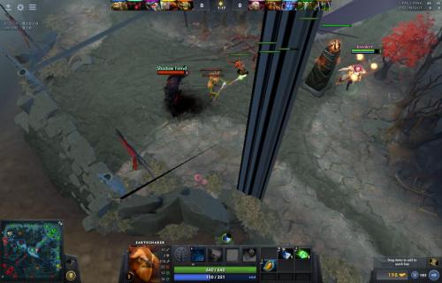

lanznoob
lanznoob
  • 10 posts
I'm having a problem when I use my computer for 2-4 hours and the result is in the photo. I don't know what part of my computer that's causing or maybe my applications, drivers and etc. I'm asking for your kind help thanks everyone.

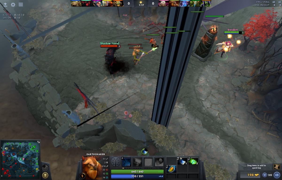

lanznoob
lanznoob
  • 10 posts
These are my specs:
Processor: Intel core i3 CPU 530 @ 2.93Hz
Memory: 4gb ddr3 (single)
Graphics: NVIDIA GeForce GTX 560 ZOTAC
OS: Windows 7 Ultimate 32-bit
Edited by lanznoob, 08 August 2017 - 06:41 AM.
  • 24,731 posts
What does Speedfan say the temps are?

  • 24,731 posts
Hopefully that is not correct.  Is that the latest version of speedfan?  http://www.filehippo...nload_speedfan/
Get Core Temp and see what it says.  Follow the instructions here as it comes with "optional software" that we don't want.
https://www.howtogee...-is-running-at/
