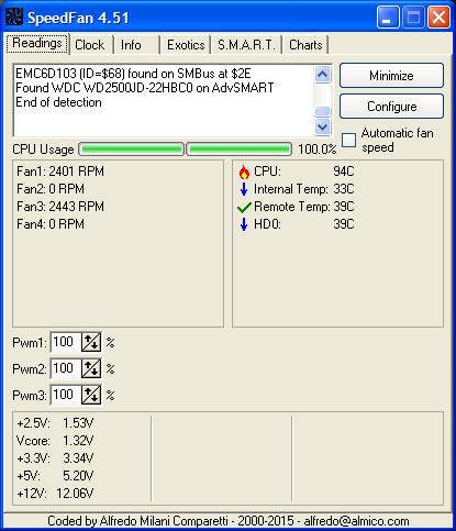

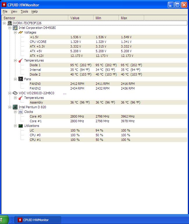

Here is the new version. I took another screen shot of Speed Fan.

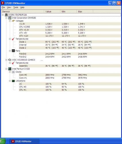

  • 25,142 posts
Speedfan shows the CPU as being maxed out usage wise and smoking hot, not too sure how reliable the readings are as your computer should shut down when the temps reach the CPUs max safe operating temp which is 64.1°C, the only time that it would not shut down would be if the thermal cut out setting had been disabled in the BIOS.
Some of the HWMonitor info is missing, grab another screenshot for us but this time make sure that all of the + signs have been checked so that it expands the sensor readings, the Intel Pentium D 820 for instance is shown to not be expanded in the screenshot above.
If HWMonitor shows the same high CPU readings as the Diode1 and the CPU temp in Speedfan something is seriously wrong, your voltages are shown to be fine btw.

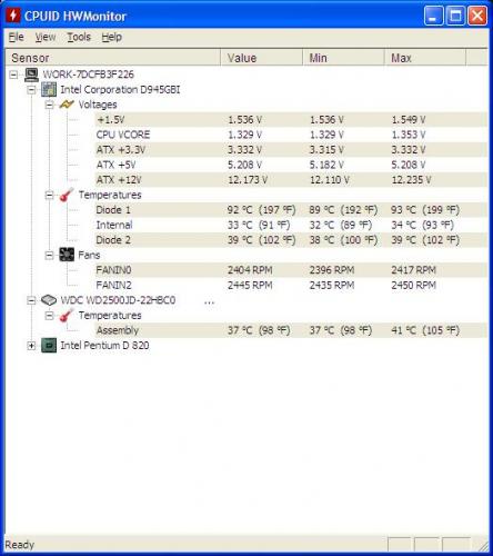

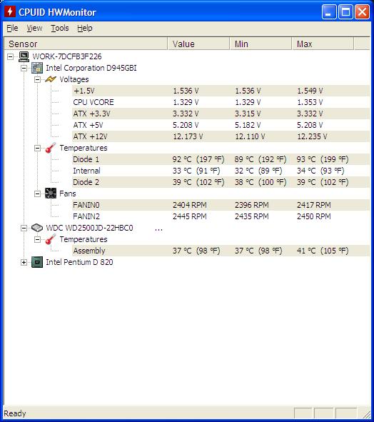

  • 101 posts
  • 25,142 posts
HWMonitor also shows the CPU to be maxed out at 100% usage - have any settings in the BIOS ever been changed.

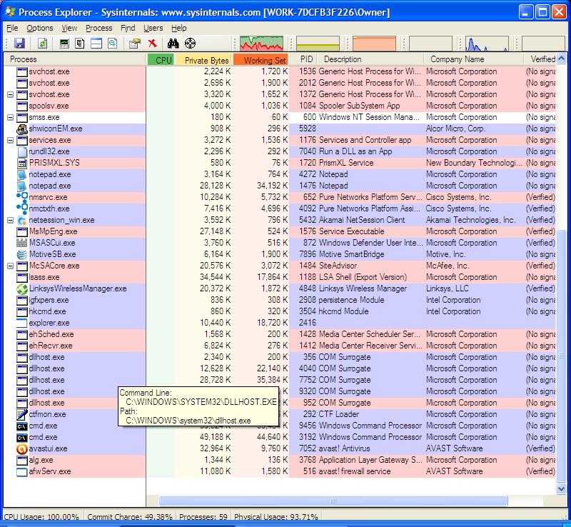

#40

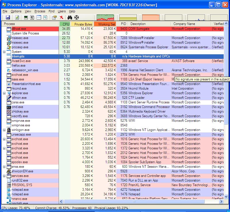

klockdoc
klockdoc
  • 101 posts
I took 2 screen shots because there was other things running below the window view
#41
  • 25,142 posts
✓  Best Answer
Apologies for the delay getting back to you klockdoc, been rather busy elsewhere I`m afraid  :(
Not saying with 100% certainty that you are but it is entirely possible that your computer is infected with malware, the 34.85% CPU usage of dllhost.exe 32 COM Surrogate is most likely what is ramping up your temperatures, similar problems experienced by others here please disregard any suggested fixes at any of those links and allow the GTG malware experts to take care of the issue for you if needs be.
Please follow the GTG malware redirection information below;
I suspect that you have some malware on your computer causing issues that we are not able to solve through means we can use here in the Tech Forums. I suggest you read the 'Start Here' topic found here. With these self-help tools you have a high chance of fixing the problems on your own. If you are still having problems after following Step 3 of the guide, continue with Step 4 and 5 and post in the Malware Forum. If you are unable to run any programs, Please create a topic stating what you have tried so far and that you are unable to run any programs. Also, Please do NOT post the logs in this thread.
If you are still having issues after the malware expert gives you a clean bill of health, Please return to THIS thread and we will pursue other options to help you solve your current problem(s).
NB: There are also two instances of Windows installer running with one showing 22.73% CPU usage, again this is not right and will be causing problems,
