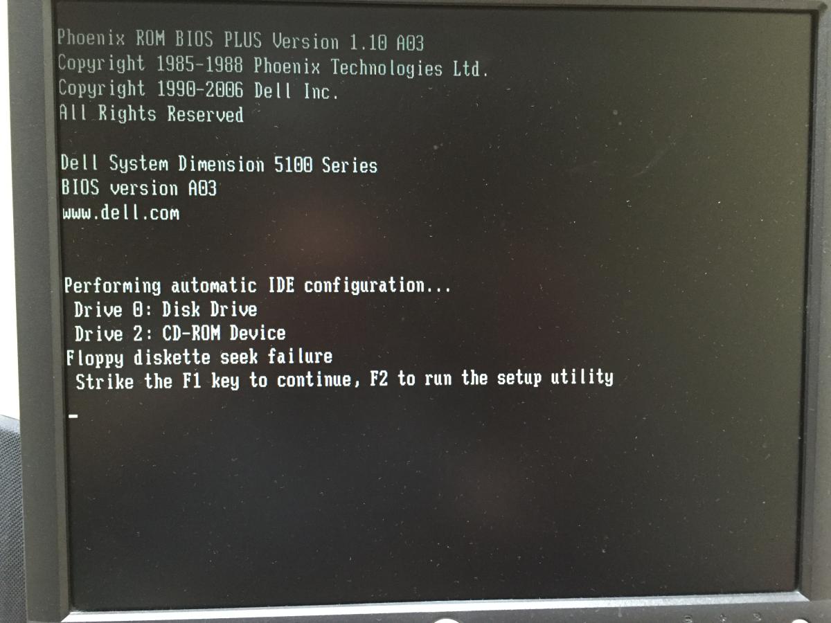

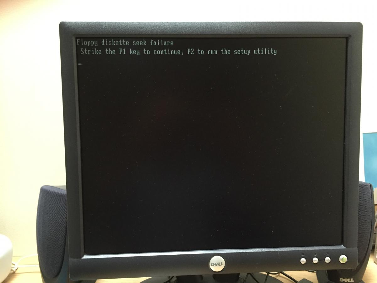

Hi again guys,
Tried step 1 and got the attached screens (first 3 pics)
I then tried step 3 and got the attached screen ( pic no4)

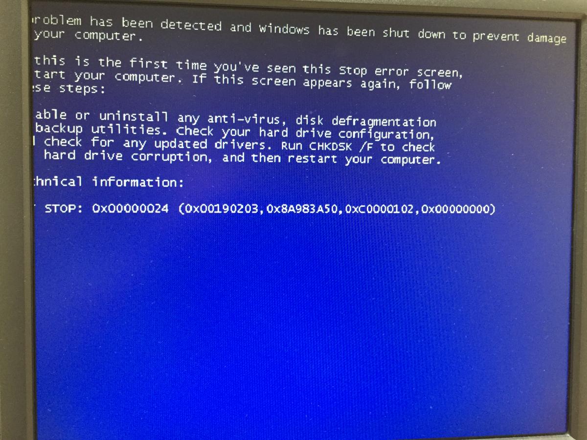

You performed step #1, SSD installed and looks like not detected.  Step #3 with the HDD installed still failed.
1.   Start the computer, > enter Setup, > go to drives tab, > select Diskette drives,
> select USB, > set to Disable
> select Internal, > set to Disable
The first top entry should display off, if not, > select it and turn off, > go Exit Menu  > Save setting, > Confirm, Press Enter.

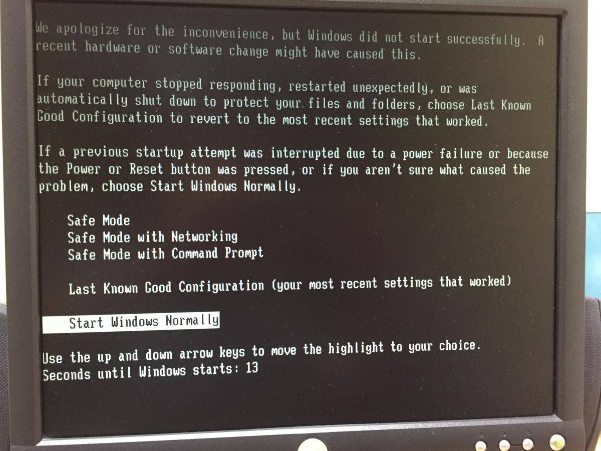

If you get the error screen#1, Press F1 to continue, If you then get the next Error screen#2, select Safe Mode with Command Prompt. > press Enter,
If the CMD screen opens, type chkdsk /f > press Enter.
follow any prompts displayed.

Hi guys,
Don't worry about the time getting back to me, I appreciate all the help you guys are giving me!
I got to diskette drives and set it to off.
Seems to be booting up OK now with no errors or fan failures coming up!  :yeah:

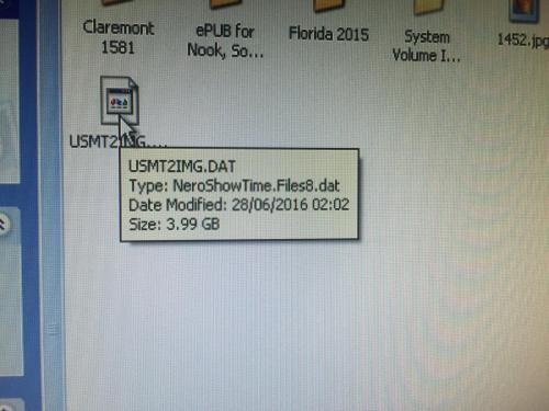

IMG_1734.JPG Hi ,
I cancelled the operation as it wasn't letting me transfer any data to anything, I also tried disks.
I tried looking on the USB stick to see what it had saved bu couldn't get into it. It saved as picture attached.

Don't know why you got images instead of folder.   Just tired it on this old rig, worksOK.
There is know way I can see to see the size of selected files before the write process starts.   letgs's try a differnt way of selting.
in the window that op[ens after you have selected the destination, USB stick,
In the window that opens, > tick the box, "Let me selct custom,,,,> click next.
> in the left side of the window that open, left click Accessibility, > In the right window, > click Remove.
perform the same actions for the other entries except,
Internet Explorer Settings,
Outlook Express,
My Documents,
My Pictures,
> click Next.
