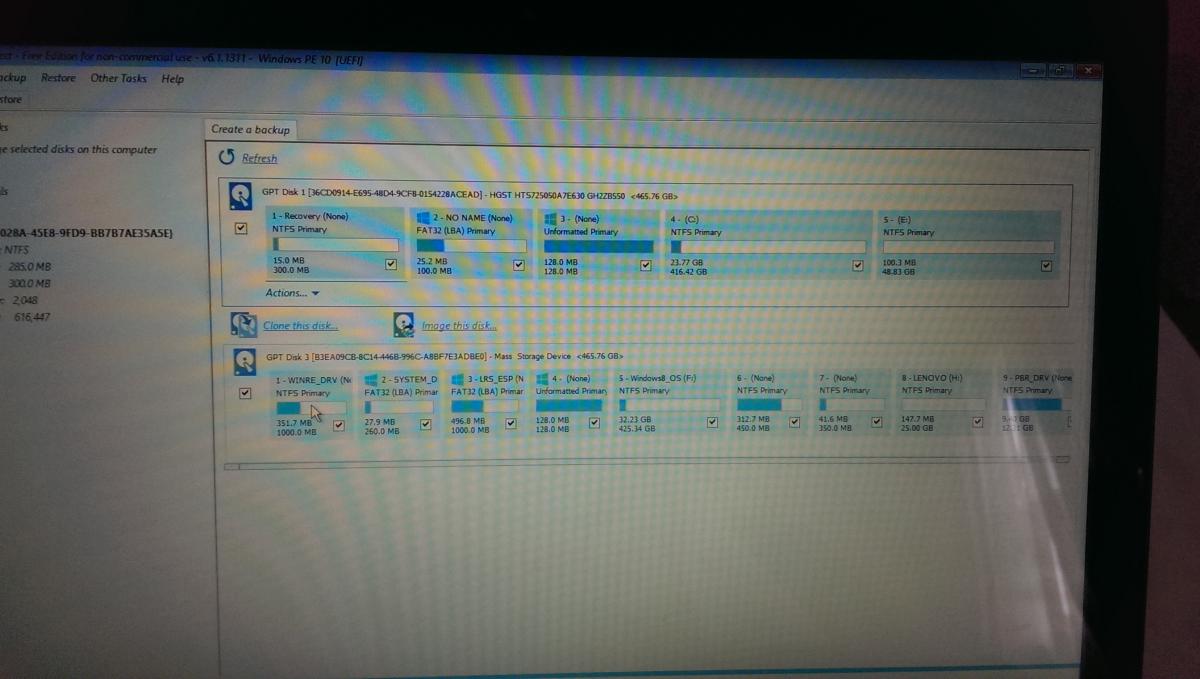

Done everything, I believe it sees the other hdd yaay

The GPT Disk 3 in the image is your old HDD connected by USB?

Erm... Yeah, I connected it and this came up .... Why? :-)

I was expecting to see the external USB disk not the old HDD, that's ok, now I know what needs to be copied.
Let's hope the 25GB free space you have on the external drive is enough to do a full backup of the old HDD.
Next
- remove the new HDD and install the old hdd inside the laptop
- boot from the Macrium Rescue and create a full backup image of all the partitions to a folder on the external USB drive (this isn't the new HDD)
- remove the old hdd and put the new one on the laptop
- restore the image stored on the external USB drive, delete all the existing partitions on the new HDD using the Delete Option available during restore.
