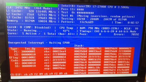

Hello again, sorry I took my sweet time setting it up.
I randomly took one of the rams out and left 1 in. However this happened (see included pic). It wouldnt continue so I assumed it couldnt continue. So I took this one out and the other one is running currently!
I dont know what this picture means though :$
Edit: did this on mobile and indeed forgot to attach it20160630_113758.jpg 20160630_113758.jpg
Edited by MarcianoG, 30 June 2016 - 04:35 AM.
  • 25,142 posts
No pic attached, after Choose File did you click on Attach This File.

Edit: The other ram was good. After this I put the 'faulty' one back in to see if it would happen again but now it has passed the point where it previously failed

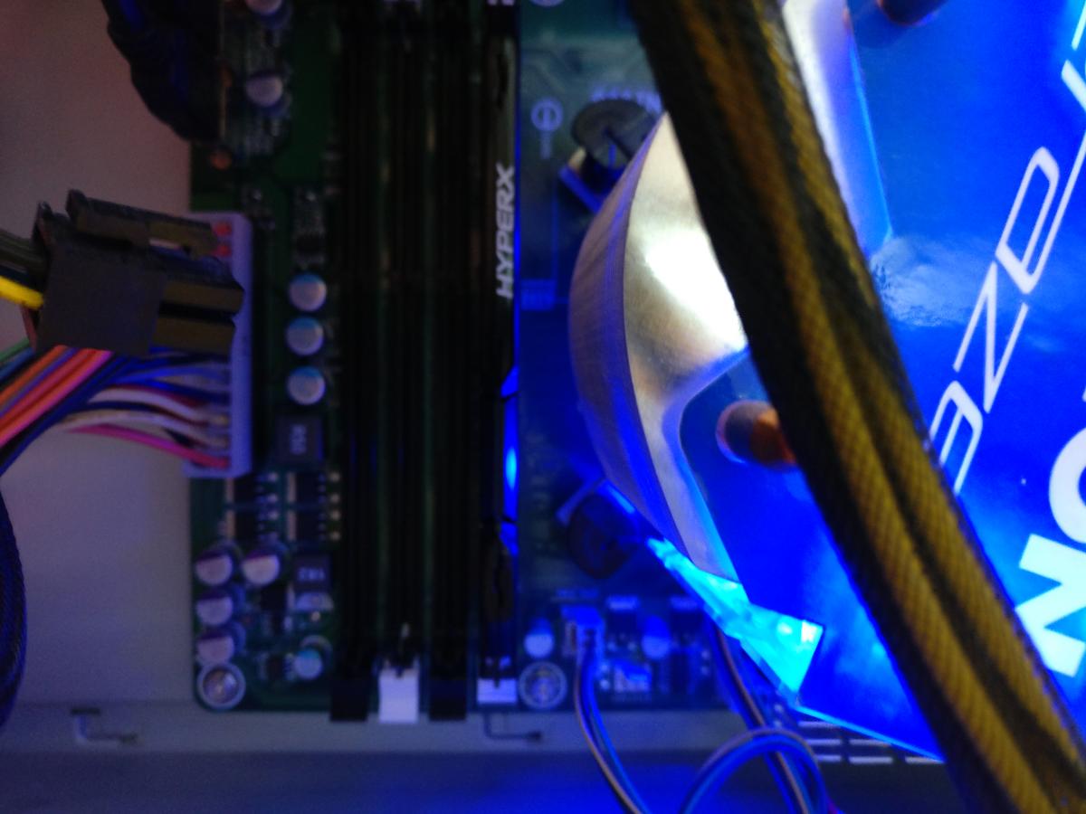

MarcianoG
MarcianoG
  • 36 posts
Okay confusion is coming over me. I put the ram stick that gave the error code in the same slot of the one that didn't give an error code, and it passed the test.
What I am thinking now is that one or multiple of the slots are broken so I will do a memtest on each of the slots.
I added a picture the one slot that the ram is currently in is tested by both sticks and passed. I will call this number 4 then going left counting down the far left is 1 will do testing to see which fails.
  • 25,142 posts
Below is my canned text for properly testing RAM;
How to physically test your Ram, this may take some time to complete but is a more accurate test than running any software while all memory is in the board.
The following checks require the computer case to be opened so take the following safety precautions 1st, disconnect the power cord from the wall socket  and take anti static precautions before touching anything inside, you can do this by touching a bare metal part of the case.
Have a pencil and notepad to hand.
Remove each stick of Ram and blow out the memory slots.
Insert the first stick of Ram in memory slot one, reconnect the power and in the case of a desktop computer the video to screen cable.
Power up the computer and see how it goes.
Make a note of the results.
Repeat the procedure until the first stick of Ram has been tested in each memory slot and the results written down.
Remove the first stick of Ram and put it to one side on top of a piece of paper with the number one on it for identification purposes.
Repeat the procedure with all Ram until each stick has been tested in all slots, the results written down and the sticks identified numerically.
Please note that some MBs (motherboards) will not boot unless there is Ram in slot one, in this instance check each stick in slot one and then leave a stick in slot one while the sticks are tested in the other slots, be sure to replace the stick in slot one with another so that can also be tested in the other slots.

Okay. I am doing this but instead of just booting up I am doing the memtest. Up until this point I have this
Stick 1: passed slot 1,2,3,4. Very first attempt it failed in slot 2
Stick 2: passed slot 1,2,3,4
Edited by MarcianoG, 30 June 2016 - 08:44 AM.
  • 25,142 posts
Memtest should be run at least 5 or 6 times on each stick and because it is so time consuming it is best left to run overnight,  as you are already aware RAM can pass one time and then fail the next + running it a few times identifies if there is a pattern such as a stick passing 5 out of 5 tests in three of the slots but failing 2 out of 5 in one particular slot.
