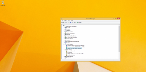

Hello, my WiFi has worked in the past on this PC, however when I installed windows 8.1 pro I could only connect to Ethetnet.
Model: HP Pavillion 23-q055na

We need to identify the wireless card to install the correct driver.
Right click the Network Controller with the yellow triangle then click Properties > Tab Details > On the Property box select Device Instance Id
Copy & Paste the values on the box to your Reply

Couldn't find anything in property boc that said Device instance ID, so I noted down anything that had ID in its name:
Device Instance Path
PCI\VEN_8086&DEV_08B3&SUBSYS_80708086&REV_83\34E6ADFFFF99B64B00
Hardware Ids
PCI\VEN_8086&DEV_08B3&CC_028000
Compatable Ids
Base Container Id
Container Id
{00000000-0000-0000-ffff-ffffffffffff}
 UI number
00000003

Sorry its the Hardware ID, the name changes depending on the Windows version.
The HP web page containing the drivers for your machine is here
The driver for the Intel wireless card from the page above is http://ftp.hp.com/pu...000/sp72777.exe
