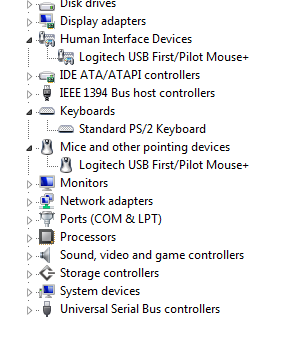

I think I should clarify, since I forgot to mention it earlier. The wireless mouse that was part of the HPWC setup broke several months ago (the right button stopped responding, likely a mechanical fault) so I removed it and installed an older USB-wired Logitech mouse while continuing to use the HPWC keyboard. Right now I'm instead using an old PS/2 Dell keyboard, and the Logitech mouse.
I'll be AFK a few days visiting my parents, but I'll try to find a different mouse to test like you said after that.
Speccy link: http://speccy.pirifo...nmh5G3zj1E3GJvU
Drivers and snapshot attached.
  • 25,127 posts
Aye was aware that you were using a Logitech USB First/Pilot Mouse+ and not the HP mouse that was shipped alongside the keyboard, the DXDiag log in your OP told us that + you advised us of this in your reply #4, we do read what you post you know  :P
What I was getting at is that the Logitech mouse itself could be faulty and the problem nothing to do with the USB ports, do any other USB devices have problems when you put them into any of the USB ports, btw, you should avoid using anything so old in USB 3.0 ports and stick with the USB 2.0.
Have you or can you try the Logitech mouse on another computer, a notebook would do.
Device Manager and Speccy not showing any issues, the list of drivers look ok and tells us that you are using Windows own generic mouse drivers from back in 2009, the latter is normal as Logitech stopped providing third party drivers for the Logitech USB First/Pilot Mouse+ after Windows XP.

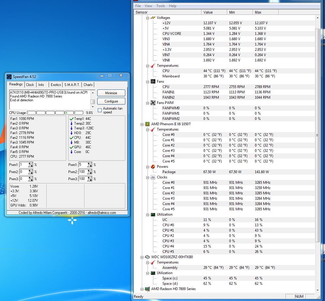

Download Speedfan from here and install it.  Once it's installed, run the program and post here the information it shows.  The information I want you to post is the stuff that is circled in the example picture I have attached.

Well, here's the requested screenshot, in case it helps any. (I personally prefer the Snipping Tool for making screenshots - it's much faster and easier than pasting it into MS Paint.)
That said, I feel confident that the issue is resolved. After restoring the BIOS to default settings, I haven't had any freezes at all, and that was six days ago. Things are running smooth and nice. As such, I think I can mark this issue as solved and close it.
Thank you for your help and support. If I have any future issues, I know where to go.

Temps and voltages all look good as well.
