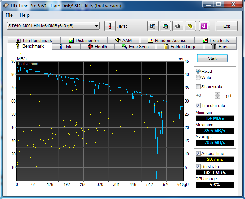

  • 55 posts
I found it on the web...
HD Tune Pro: ST640LM001 HN-M640MB Benchmark
Test capacity: full
Read transfer rate
Transfer Rate Minimum : 1.4 MB/s
Transfer Rate Maximum : 85.5 MB/s
Transfer Rate Average : 70.5 MB/s
Access Time           : 20.7 ms
Burst Rate            : 182.1 MB/s
CPU Usage             : 5.6%
#67
  • 24,731 posts
Sorry, thought we had already run HD tune.  I don't really like the big drop in yours and the speed is low.  Sometimes running defrag will help  Close all programs.  Pause your anti-virus.   Open Computer and right click on the C: drive then Properties then Tools, Defragment Now, Make sure the C:\ drive is select and Defragment Disk.  Don't touch the PC until it is done.  Once it completes. run HD Tune again.
