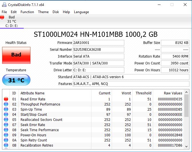

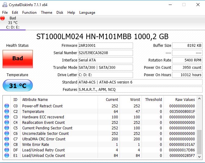

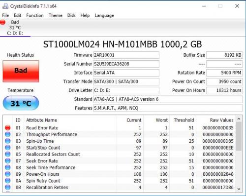

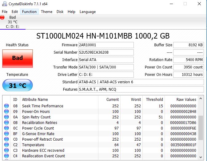

Check the HDD with CrystalDiskInfo 7.0.0 Standard Edition which you can download from here once done grab a screenshot (possibly two) of the results and attach to your next reply for us.
Click on the ALT key + PRT SCR key..its on the top row..right hand side..now click on start...all programs...accessories...paint....left click in the white area ...press CTRL + V...click on file...click on save...save it to your desktop...name it something related to the screen your capturing... BE SURE TO SAVE IT AS A .JPG ...otherwise it may be to big to upload... Click on the Upload a File tab then after typing in any response you have... click on Post Reply like you normally would.

for the crystaldiskinfo I ran it and it's bad..I don't know what to do at this point
