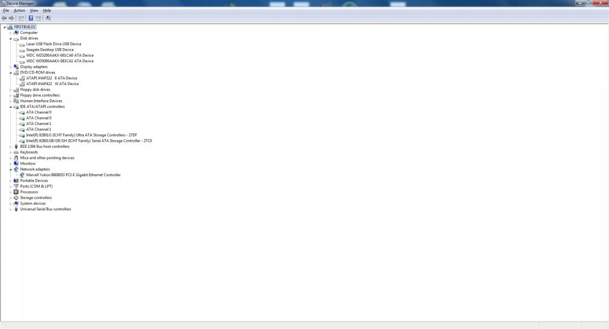

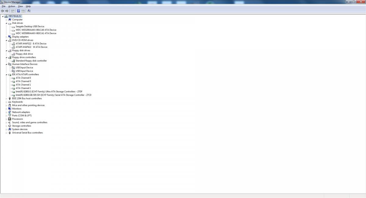

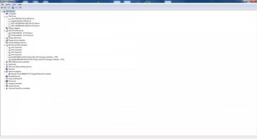

When I did Windows 7 update, part of the update were the drivers.  I don't recall if an audio driver was one of them.  (I used to have Realtek HD Audio Manager with ALC882M audio Codec.)
Attached is a screenshot of the Device Manager with the new Windows 7 installed.

You cant rely on Windows to install the correct drivers and need to install them yourself, some of Windows generic drivers are fine for some devices such as for the mouse and keyboard but Windows does not have generic drivers for every single device, it would be impossible for them to do for one thing and another is because it is not the responsibility of Microsoft to develop drivers for other companies hardware, this is potentially the reason why you have no audio, if you check your previous XP Device Manager screenshot  and your current Windows 7 Device Manager screenshot you will see that you are missing any Sound, video and game controllers, Windows has no generic drivers for the Realtek device so the device is disabled, the procedure was explained to you btw  :P
From my reply #2;
2: Before you begin, download and save the Windows 7 version of drivers for all of your hardware, after installing Windows 7 you should next install the chipset drivers for your motherboard.
and reply #4;
The latest drivers available for your MB are for Vista, download them from here and save them to a thumb drive, your mouse should be fine but the printer will need to be installed using the appropriate drivers from the manufacturer
Boot into Safe Mode only (no networking) try installing just the Vista chipset drivers first, restart and test, if still no audio device, repeat the Safe Mode only procedure to install the Vista Realtek Audio drivers and again restart and test, this will hopefully get you sorted.

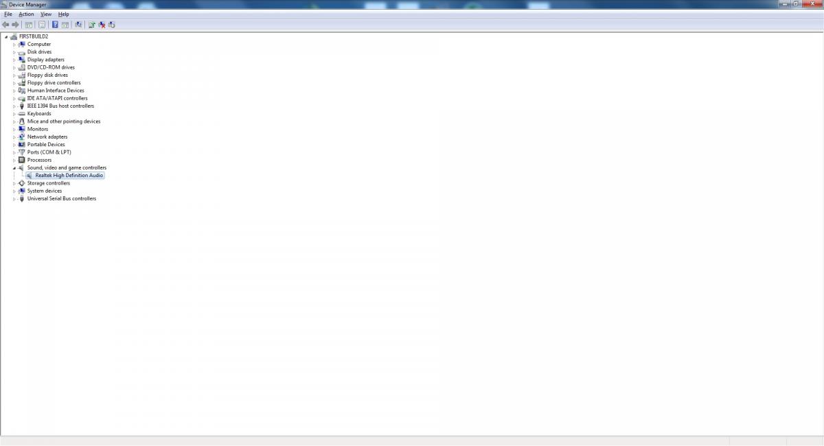

I installed the Vista chipset drivers and then the Vista Realtek Audio drivers as you indicated above.  Lo and behold, I not only have sound now, but I also have the Realtek HD Audio Manager (if I want to do fancy audio things like install a 7.1 speaker system, for example.)  A screenshot of Device Manager is provided below.
I apologize for not listening to you at the outset.  I think that when Windows 7 installed without problem and I say various drivers to be installed as part of the Microsoft update package, I jumped the gun and figured that everything was going to be OK.

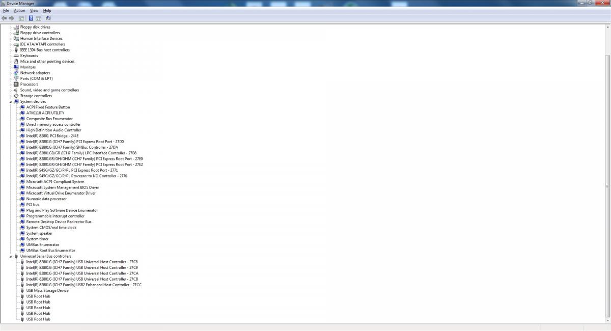

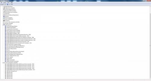

I had to post 2 screenshots of Device Manager so you could see the details.

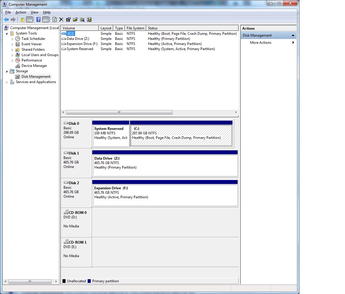

  • 25,144 posts
Can you post an expanded screenshot of Disk Manager for us
Disk Manager please Jack

  • 490 posts
Here it is.
  • 25,144 posts
I am seeing CD ROM/s D and E in your screenshot!

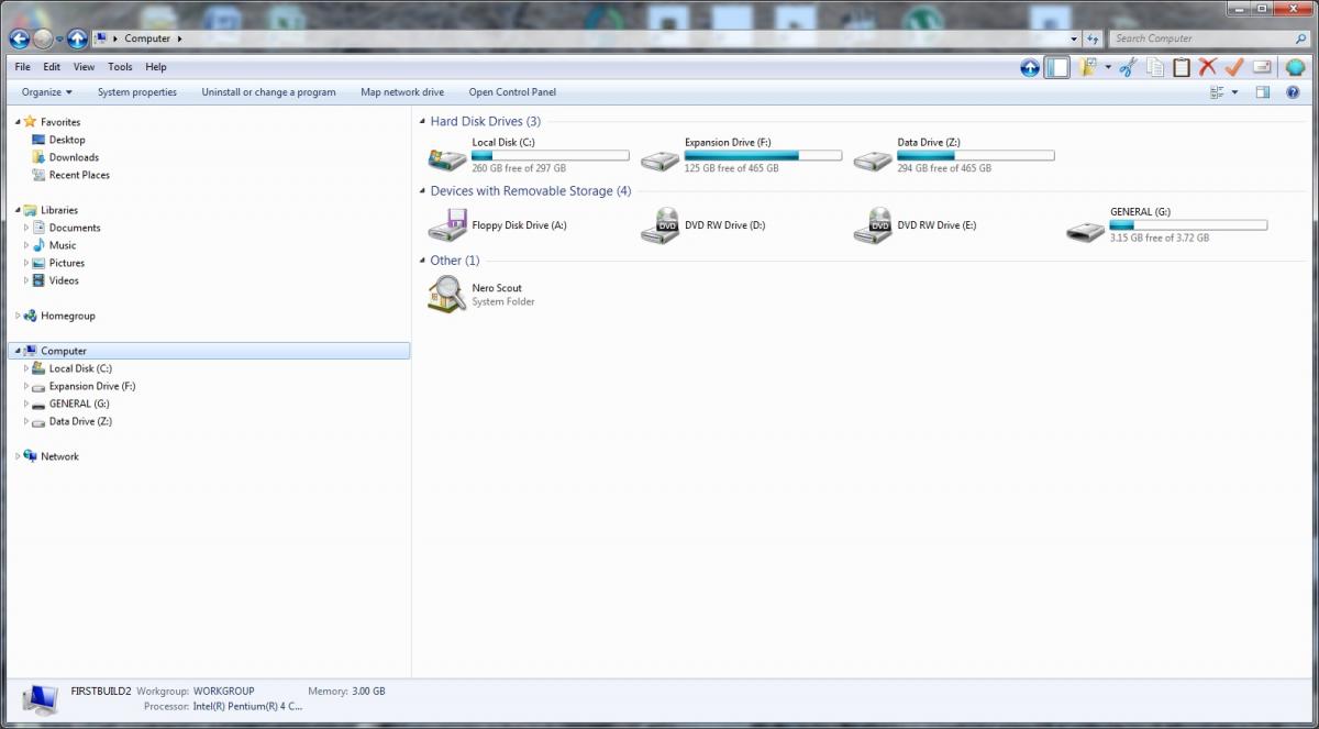

  • 490 posts
Windows XP always showed CD ROMs D and E in Windows Explorer under Computer.  Windows 7 doesn't.  Is that how it's supposed to be?  I wonder why G drive is shown, since that is a removable storage as well.
I guess it doesn't really matter if those two drives are not shown under Computer (because they are both fully functional), but if there is a way for them to be shown there, I would like to do it.

  • 25,144 posts
From memory as long as there is no disk in the drive yes that is how it is meant to be, same as my Windows 10, you can always create a shortcut for each drive on your desktop.
Sorry but not sure what you mean, what type of device is the G: drive, looking at the storage capacity it gives the impression that it could be a a USB or SD device.
