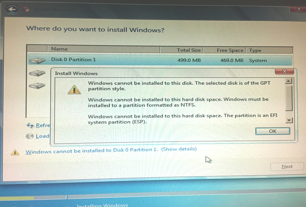

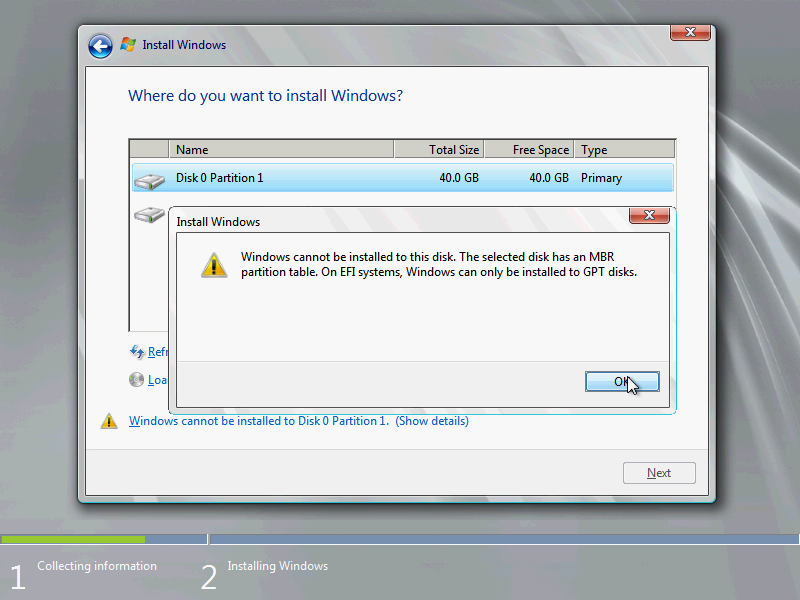

Then again this error, please see image below;

Your screenshot suggests that the HDD has not yet been formatted, if wanting to do a clean install of Windows 7 on the HDD you need to wipe the entire HDD and then when installing Windows 7 create a new partition of between 150 and 200GB just for Windows 7.
In answer to your question;
For computers that have UEFI as opposed to legacy BIOS, to disable secure boot and change UEFI to CSM Boot, not all computers and BIOS are the same, please refer to your user manual if you have one as the following steps are only one such example.
Restart the computer, Windows 8 and 8.1 from the Start or desktop screen move your mouse pointer over the upper or lower right corner of the screen, when the Windows Charms appear click the Settings Charm, click on Power and then the Restart option.
While the computer is re-starting,you will need to continually tap or hold down the particular key that will allow you to access the BIOS on your computer, we will use the F2 key as an example here;
After restarting the computer, when the screen goes black, press and hold down the F2 key, wait for the BIOS to load.
Select Security -> Secure Boot and then Disabled.
Select Advanced -> System Configuration and then Boot Mode.
Change UEFI Boot to CSM Boot.
Save the changes and Exit the BIOS, commonly F10.
Edit to add:  Some info on formatting a HDD here before proceeding with any format, be sure that it is what you definitely want to do and that the Windows media that you have for the clean install is all good, a genuine Windows install disk is for example likely to install without issue whereas a burned copy/ISO may not.

Hello,
@phillpower2, thanks, I was able to find that boot sequence but I did not touch it just yet.
Sorry I will correct myself. When I post this, I was at the office and I don't have the screen shot, I just search a screen shot from google thinking they are all the same. My mistake, sorry.
Below is the real screen shot with the problem which I eventually will face "if I want, if not too much complicated or will not mess my laptop".
Thanks and again sorry for the first screen shot.
  • 25,141 posts
✓  Best Answer
Hello JoMalig,
No problem as no harm done.
No need to elaborate on the contents of your actual screenshot as your plans will erase the partitions that are presently on the HDD.
Because you are wanting to install Windows 7 you must format the HDD and do a clean install, see Doing a clean install of Windows info at the link here
Please note that before proceeding you must have a valid Windows 7 licence key that is not or if an OEM licence has not already been in use on another computer and you should check that your Windows 7 installation media is good.

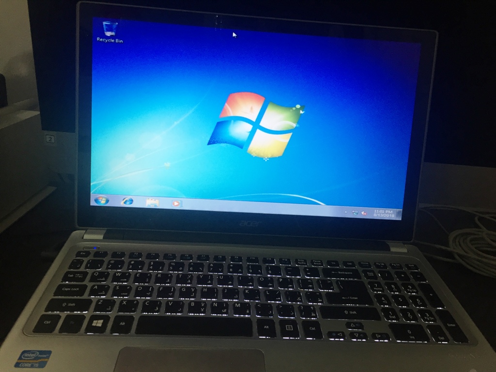

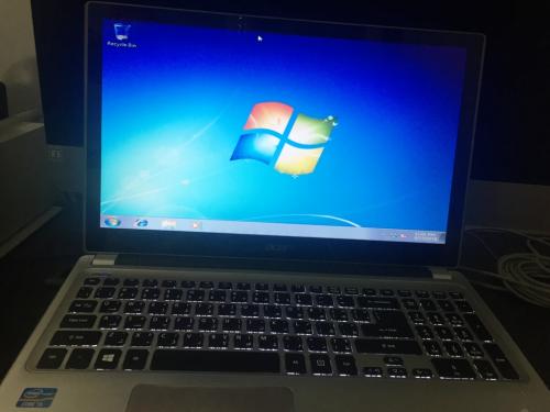

Hello Phillpower2,
It works. Thanks so much and also to Rkinner.
I was able to install windows 7.
Thank you for the fast and reliable replies.
