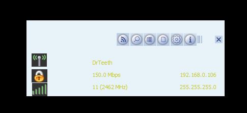

Since turning off Networking makes a big difference you probably need a newer Network Adapter.  You can right click on Computer and select Manage then sdelect Device Manager.  Click on the arrorw or plus sign in front of Network Adapters and you should see the adapters.  We only care about the one you use.  Right click on it and Update Driver.  This seldom works but it might.  If Windows says you have the best adapter then
Right click on it and select properties then click on the Details tab.  Change Property to Hardware IDs.  Click on the top one then right click and copy.  Paste that into a reply.  Sometimes you can just read the name of the adapter instead then go to your PC maker's website and see if they have a newer driver available.

The device driver was up to date but here is the top one PCI\VEN_1814&DEV_5390&SUBSYS_F0511814&REV_00

I found a driver on an HP site for your network adapter:
http://ftp.hp.com/pu...500/sp60464.exe
Appears to be much newer than what you have.  See if it will install.

#40
  • 24,731 posts

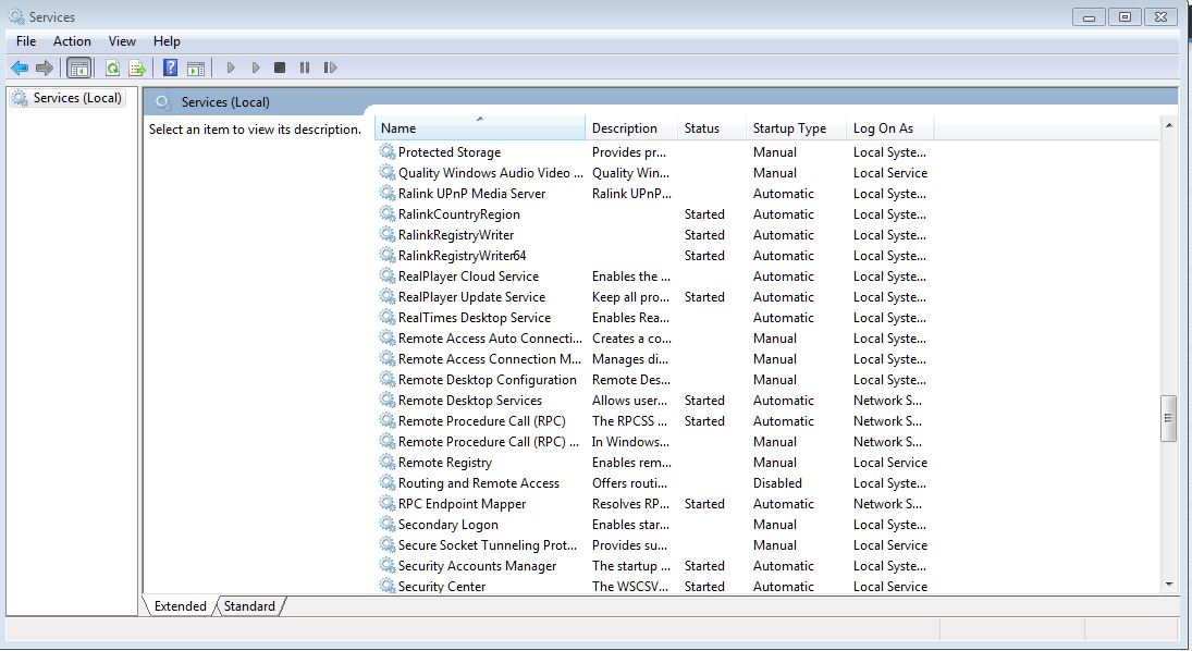

I think your strange window is from Ralink Media Server which is apparently the Ralink version of the Windows Zero Config/WLAN service which controls your Wireless.  If you go into Network and Internet Settings there is usually an option to let Windows control the wireless.  Then you can stop the Ralink Media Server service (search for services.msc and hit Enter then right click on the service and select Properties then change the Startup Type: to Disabled.  OK.
There was a Ralink Media Server error in VEW so it probably couldn't start at all before the upgrade.
#41
BrianR1976
BrianR1976
  • 355 posts
Ignore what I said about not finding it.
Edited by BrianR1976, 01 November 2018 - 02:42 PM.
#42
BrianR1976
BrianR1976
  • 355 posts
I disabled the Media Server. I will reboot and run Latency again.
