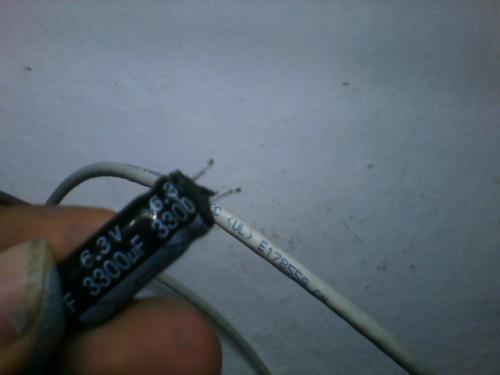

I think I just found part of the problem. There was a bad cap (See picture), I replaced it but the PC is still freezing. I'm 50% sure there are some other(s) bad cap(s).
At the moment I don't have a tester so I have to wait until I get one, then I'll post back the results.

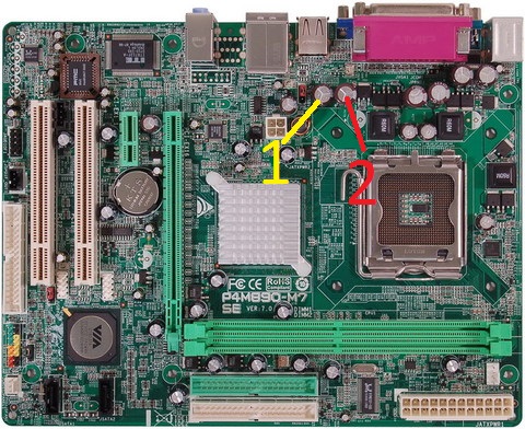

Hello. Sorry if I'm being annoying, but there's an important update:
I just replaced another bad cap next to the first one and the PC has been running for 3 days without freezing. One more thing: The CPU-GPU-RAM detection problem is still present, I have to manually set the processor base clock to 200Mhz on every boot in order to make the mainboard correctly detect the CPU, GPU and RAM hardware. I guess there's another bad cap somewhere.
I attached a referential photo so you can see the replcements; #1 [See the previous photo], #2 recently replaced.

So what's up with your mainboard now, is everything okay?
Friedrich Schnellinger
  • 38 posts
More or less, buddywiser. I have to manually set the base clock on the BIOS setup on every boot, otherwise, it would run very slow, as it would detect only 1.0GHz instead of 2 and randomly decrease DIMM speed.
It keeps detecting the PCIe lane widths as "2X" or "4X", but as long as I set the base clock to 200Mhz, the there is no problem. I've been playing heavy games for this PC, such as Skyrim, Euro Truck Simulator 2, UDK 2009 Example Game and some others. No random freeze, no extreme lag.
Resuming:
*Changing those caps solved the freeze problem.
*Setting up the base clock on every boot solves the performance/lag problem
*The CPU/RAM/GPU detection problem remains unsolved
