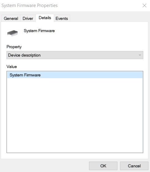

I have done that but the result I get when clicking on Properties Details is
#62
  • 24,748 posts
Click on the little down arrow to the right of Device Description and a drop down menu will appear.  Select Hardware Ids.  Then you should see some new info.
Mine says:
UEFI\RES_{7039436b-6acf-433b-86a1-368ec2ef7e1f}&REV_C
#63
BobScott49
BobScott49
  • 66 posts
I should have seen that
UEFI\RES_{ce07a014-23aa-4ae5-a7ad-021849fec1bb}&REV_F110000

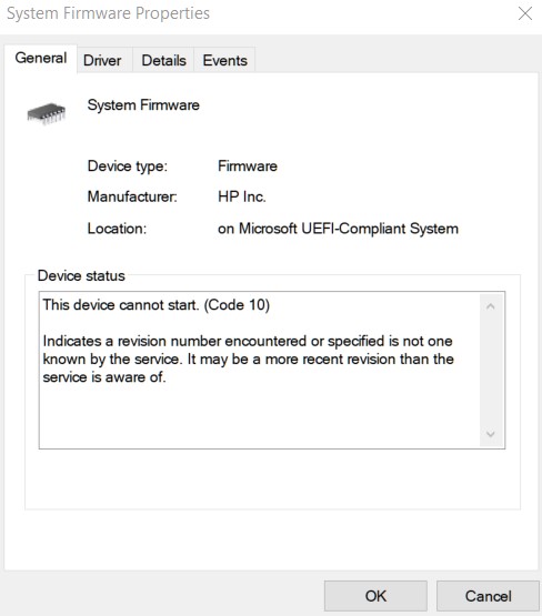

#64
  • 24,748 posts
I have the same driver on my travel laptop but with a newer rev.
Looking at the HP driver support page
https://support.hp.c.../model/22757794
the only one that has anything to do with UEFI is
HP PC Hardware Diagnostics UEFI     7.4.0.0 Rev.A    41.1 MB    Sep 4, 2019
Look under Diagnostic(3)
See if that fixes the flagged Firmware entry.
Also
go into regedit.exe
navigate to:
HKEY_LOCAL_MACHINE\SYSTEM\CurrentControlSet\Services\GuardWareProxy
Right click and Export to your desktop, call it GWP.  Then close the registry editor and right click on GWP.reg and Edit.  This should open it in notepad.  Edit, Select All, Edit Copy now go to a reply and Ctrl + v to paste it.
#65
BobScott49
BobScott49
  • 66 posts
 installed the update but still getting the same

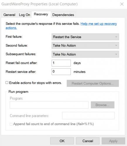

#66
  • 24,748 posts
Try right clicking on the yellow flagged device.  Then Update.  See if windows can find an update for you.
Can you search for
services.msc
then hit Enter
Now find
GuardWareProxy
and right click and select Properties.  Then go to the Recovery tab and make a screen shot.
#67
BobScott49
BobScott49
  • 66 posts
I tried that and it said I was using the most up to date driver

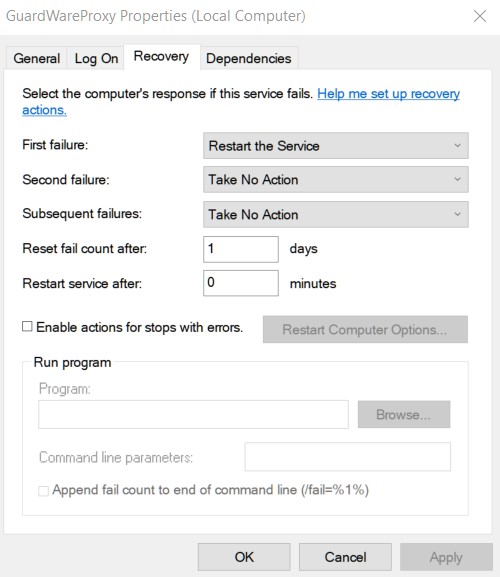

#68
  • 24,748 posts
Can you search for
services.msc
then hit Enter
Now find
GuardWareProxy
and right click and select Properties.  Then change the Startup Type: to Automatic ( Delayed Start) then Apply?  Does it accept the change?  (you may need to check the driver in Autoruns and MSCONFIG first.)
Go back into Device Manager and right click on the yellow tagged HP Firmware then Properties then the Details.  Change Property to Inf Name.  Report the file name.  Mine is c_firmware.inf  what is yours?
Then go to regedit again and navigate to
HKEY_LOCAL_MACHINE\SYSTEM\CurrentControlSet\Services\UEFI
Right click and Export to your desktop call it UEFI.
Close regedit and then right click on UEFI.reg on your desktop and Edit then Edit, Select All then Edit Copy then move to a reply and Paste.
#69
BobScott49
BobScott49
  • 66 posts
GuardwareProxy accepted the change in Services
In Device Manager the filename on the firmware is oem8.inf

Can I see oem8.inf, the same way you posted c_firmware.inf?  Should be in C:\Windows\INF
Also go to Device Manager and rightclick on the yellow tagged entry and Uninstall then reboot.  Does it come back?

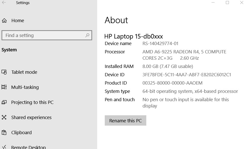

Does it seem to boot faster with the extra RAM?
Have we rechecked everything for the Guardware?

After uninstalling the yellow tagged item and rebooting, it came back
Everything is rechecked for Guardware
I don't see any appreciable difference with the extra RAM.  If anything it feels a bit slower rebooting but that may be my imagination.
[Version]
Signature   = "$WINDOWS NT$"
Provider    = %Provider%
Class       = Firmware
ClassGuid   = {f2e7dd72-6468-4e36-b6f1-6488f42c1b52}
DriverVer   = 08/30/2019,15.21.0.0
CatalogFile = delta.cat
PnpLockdown = 1
[Manufacturer]
%MfgName% = Firmware,NTx86,NTamd64,NTarm
[Firmware.NTx86]
%FirmwareDesc% = Firmware_Install,UEFI\RES_{%RES_GUID%}
[Firmware.NTamd64]
[Firmware.NTarm]
[Firmware_Install.NT]
CopyFiles = Firmware_CopyFiles
[Firmware_CopyFiles]
InsydeSystemFirmware.bin
[Firmware_Install.NT.Hw]
AddReg = Firmware_AddReg
[Firmware_AddReg]
HKR,,FirmwareId,,"{"%RES_GUID%"}"
HKR,,FirmwareVersion,%REG_DWORD%,%BIOS_VER%
HKR,,FirmwareFilename,,InsydeSystemFirmware.bin
[SourceDisksNames]
1 = %DiskName%
[SourceDisksFiles]
InsydeSystemFirmware.bin = 1
[DestinationDirs]
DefaultDestDir = %DIRID_WINDOWS%,Firmware ; %SystemRoot%\Firmware
[Strings]
; localizable
Provider     = "HP Inc."
MfgName      = "HP Inc."
FirmwareDesc = "System Firmware"
DiskName     = "Firmware Update"
; non-localizable
DIRID_WINDOWS = 10
REG_DWORD     = 0x00010001
RES_GUID      = CE07A014-23AA-4ae5-A7AD-021849FEC1BB
BIOS_VER      = 0x0F210000
