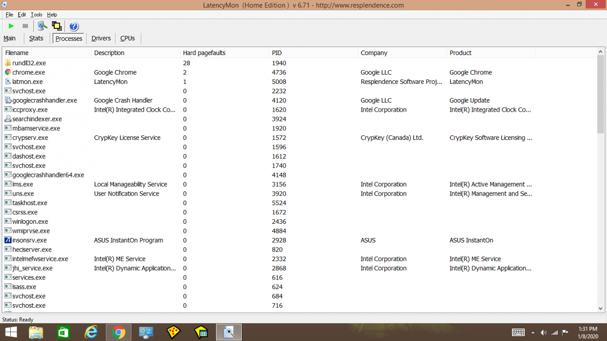

Also can you rerun Latency Monitor for 20 seconds then go to the Processes page and click once or twice on the Hard Pagefault column header to sort  things by the processes with the most pagefaults then take a screen shot (save it as a .jpg) and attach it to a Reply?

I wonder about Rundll32.exe
It doesn't show in the Process Explorer log tho it did show in the FRST log.  Rundll.exe is used to load a .dll.  Just wonder which one.  See if you can see it in

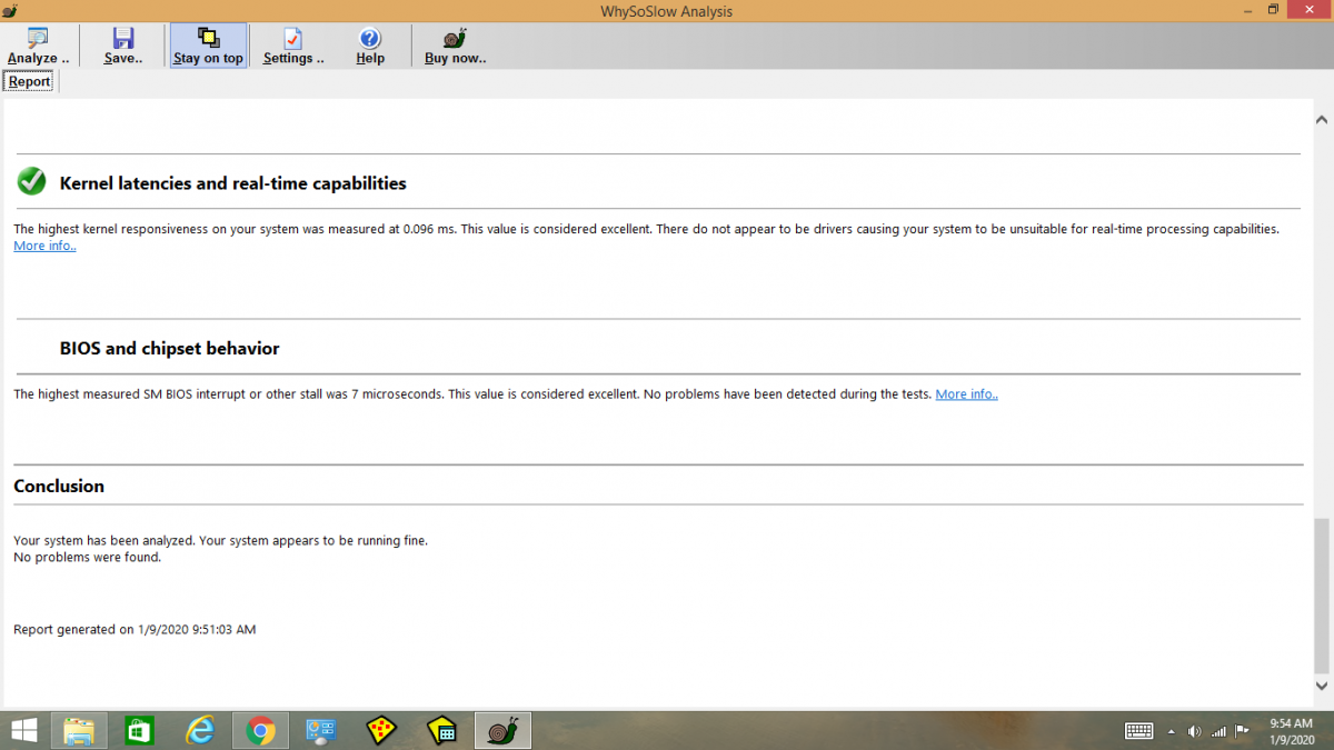

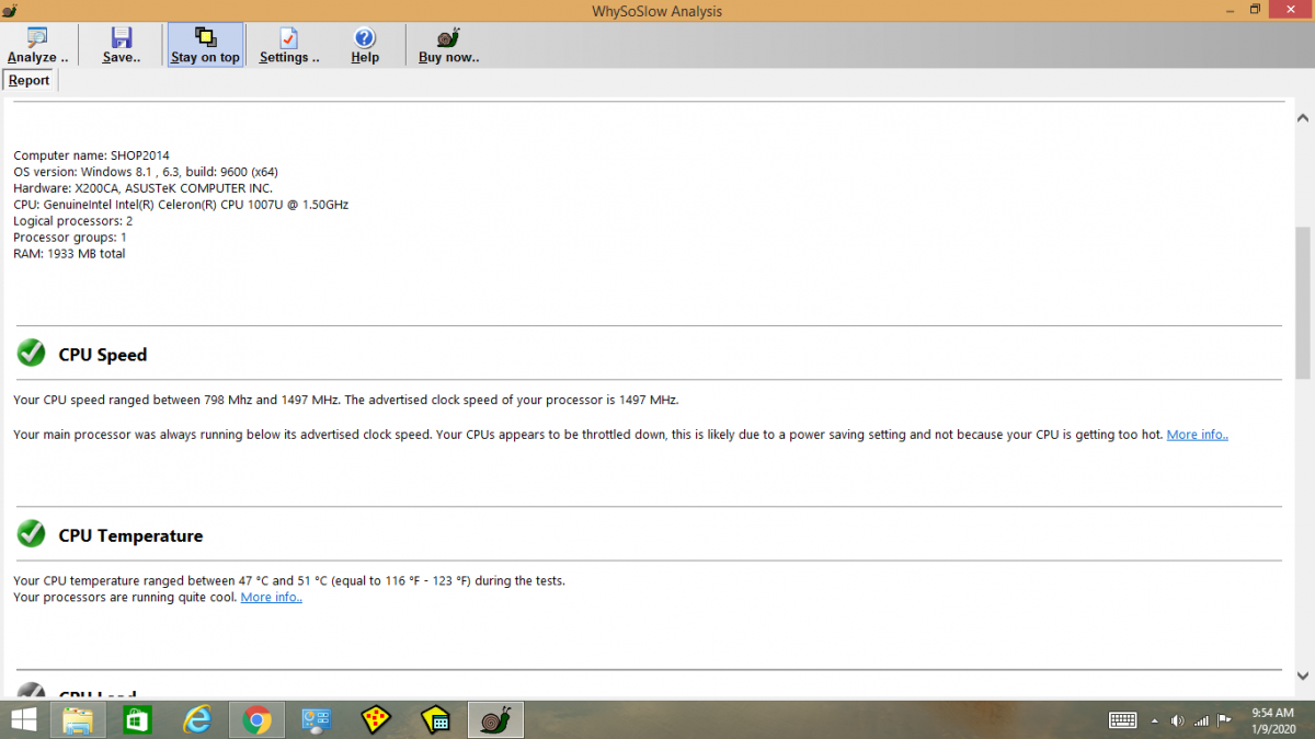

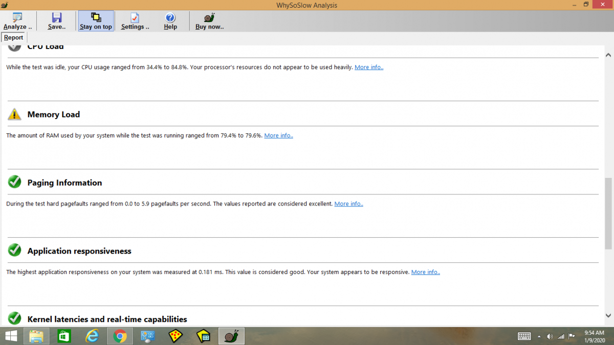

Try WhySoSlow:
The Download is on
Look under System Monitoring Tools for WhySoSlow 1.0  then click on
Download free home edition
Save the file then right click and Run As Admin.  Follow the prompts. Let it run for a minute (watch the Time Running indication at the bottom) then hit Analyze
Then when a new window appears hit Analyze again.   Once the report appears scroll down and see if it complains about anything.  You can Save the report but it saves as WhySoSlowOutput.htm which the forum won't let you attach.  You can either zip it up or rename it to WhySoSlowOutput.txt then attach it.

I tried changing to a .txt file, still would'nt let me attach, but took screenshots of the results

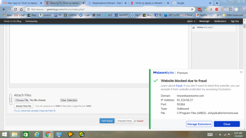

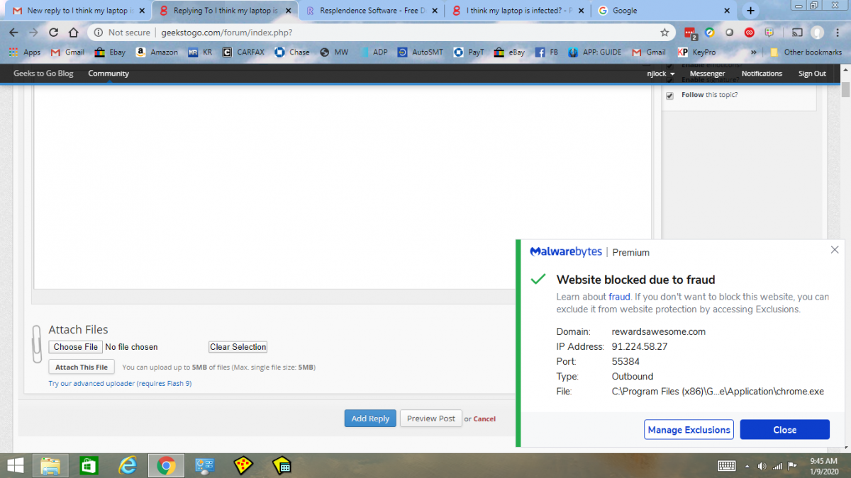

also I was getting a popup from a blocked page, do I need to be concerned about that?  (screenshot.2)

G2G.com doesn't offer https so we often get flagged.  I've complained to the admin many times but the forum software doesn't offer https and changing is a major project.  That being said I have no idea who  rewardsawesome.com are.  Perhaps one of the advertisers that you see if you are not logged in.
You might try setting your Power Setting to High Performance:
https://tunecomp.net...-power-options/
see if that speeds things up a bit.  You can also go into your BIOS and look for things like Speed-Step, ECO something, Quiet something, or Power-Saving and disable any you find.

ok, did the power plan thing, I wasn't able to access the bios? I tried f2, f10 f12, etc ( from restart)
thx for your help again definitely a huge improvement!
