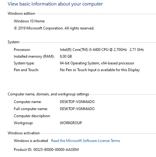

Thank you for replying again, sorry for the delay, i'm back at work now & not as much time is freely available now.
Graphics card was removed, we hoped the problem would be power supply
I have a 300w power supply hooked up (removed from an old Dell PC i have) with the 24 to 8 pin adapter cable now. When i restarted it after fitting the 'new' PSU i left the room for about 30 mins, came back & the PC screen was frozen up
Just to refresh the problem occured (maybe coincidentally) when Dell sent an automatic BIOS update, if i remember correctly the PC wouldn't even switch on so i replaced the motherboard, no MB's were available from Dell so i used one from China (but Dell is stamped on it)
Just a question to rule something else out, I didn't use thermal paste when refitting the processor, would this be the cause?
Edited by gpl98a1, 21 June 2020 - 05:31 AM.
