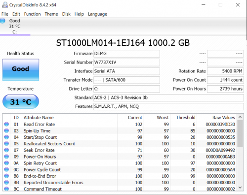

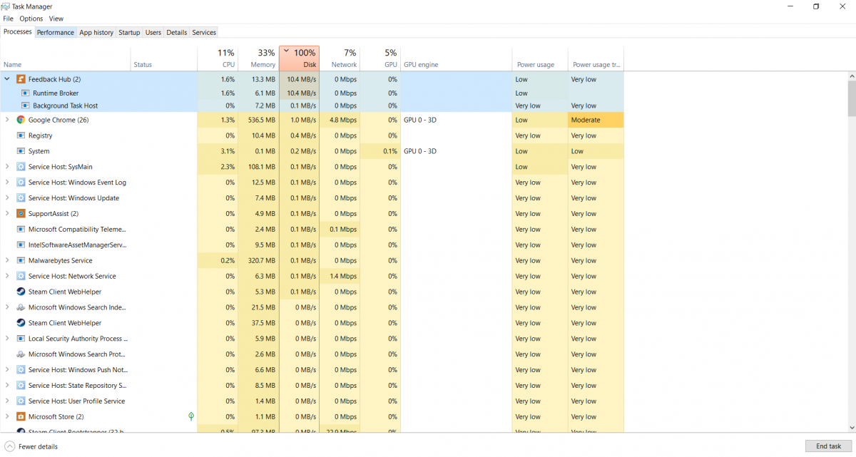

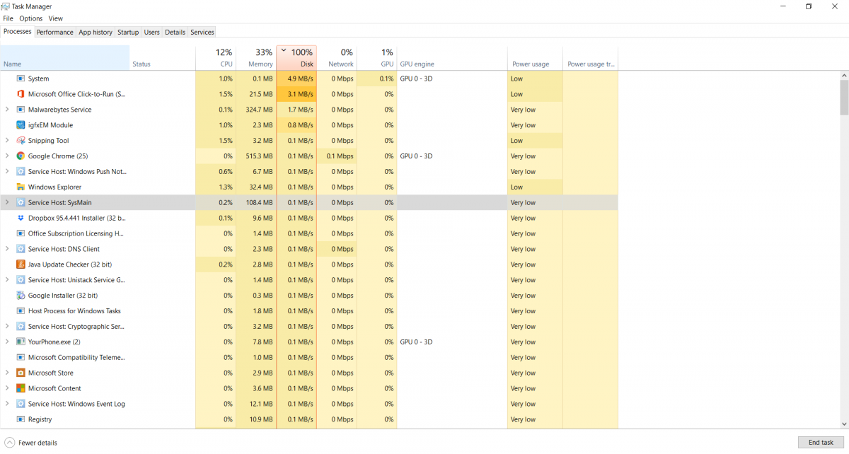

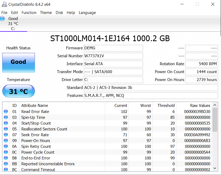

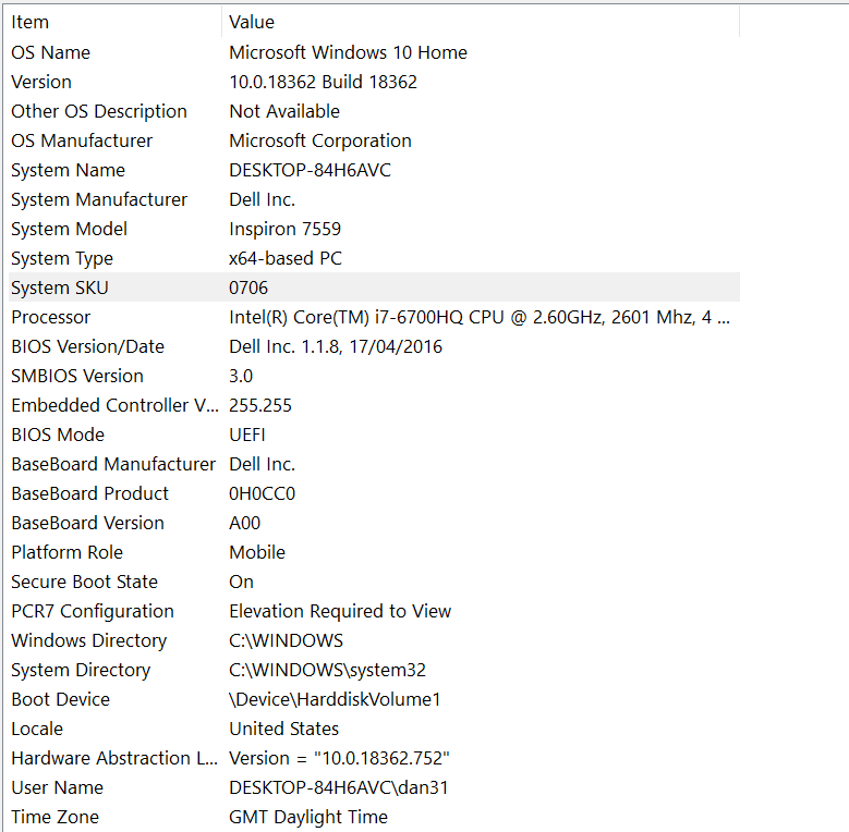

Good afternoon,
I've been finding recently that on task manager disk is showing at 100% due to 'System'. I've recently upgraded from 8GB RAM > 16GB.
Please let me know if there is anything I can do to rectify this.

Hello Wolf,
Any problems with the drives performance, any odd noises at all?
Lets take a look shall we;
Can you open Task Manager to full screen, click on the Disk & Processes tabs, give things a couple of minutes to settle down, grab a screenshot and attach it to your next reply for us.

Hi Phil,
Thank you kindly for responding. Annoyingly it is now showing as minimal disk usage.
Basically the reason I bought the additional RAM is to try and have more stability/performance whilst gaming. Occasionally the laptop will just randomly shutdown. I think this may be an issue with the battery cutting out. I had the battery replaced about 10 months ago as it wouldn't hold a charge for more than 10 minutes. However only after the short period of time this battery has declined rapidly. (On this note, I'm not the most technical person when it comes to hardware, I've had a visual inspection and the battery appears to be connected correctly).
The occasional random shut downs haven't particularly been a problem, I haven't really noticed any strange noises as such, just occasions when the fan will kick in pretty fast then slow down again. When disk does hit 100% the system slows right down and I've got to wait a few minutes for things to start working again.
Thank you,
Wolf

Hi Phil,
Thank you. Please find attached the screenshot.
Wolf
  • 25,130 posts
As you can see for yourself the HDD is fine.

Thank you Phil,
Managed to catch it today where it has frozen up
see screenshot.
Cheers,
Wolf
Edited by Wolfman360, 18 April 2020 - 06:45 AM.
  • 25,130 posts
Can I ask what the computer was being used for at the time.
We can see high CPU and memory usage as well, if it happens again before we are done can you check what is using the CPU and RAM at the time.
