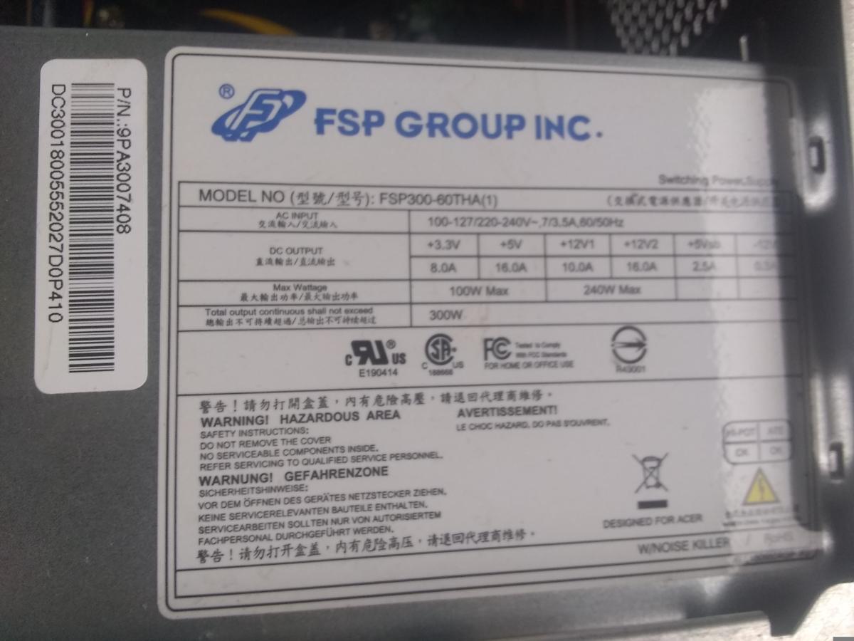

2. PSU: FSP 300-600tha(1) (see attached photo)
No picture attached and I cannot find that PSU on the database, can we have the pic + can you confirm that we have the correct PSU model information.

Here is photo:
Edited by daniel.karakas, 02 June 2020 - 11:20 AM.
  • 25,113 posts
Thanks for the pic  :thumbsup:
Lets see how things go for now but any further problems we will check the temps and voltages, btw, in case you are not aware, that PSU is labelled as 300W when it can only produce 240W which you can see is clearly printed on it 240W Max
