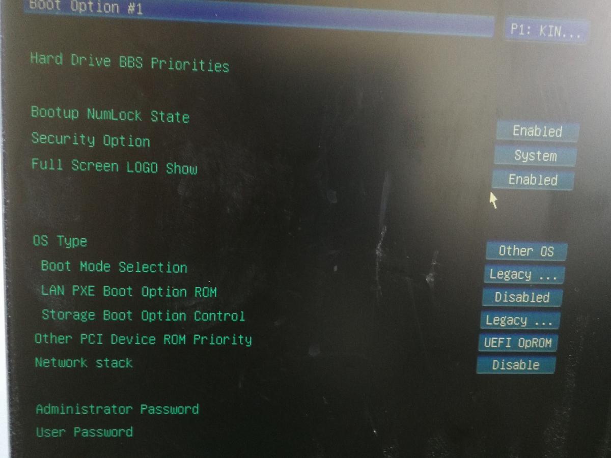

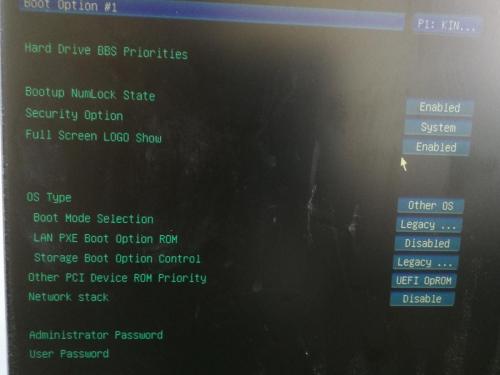

Look at pages 22 & 23 of the manual.  You will see OS Type:  The default appears to be Other OS but you may need Win 8 or Win 8 WHQL as that turns on CSM Support.  Then below it is :
Boot Mode Selection where you can select Legacy Only or Legacy First

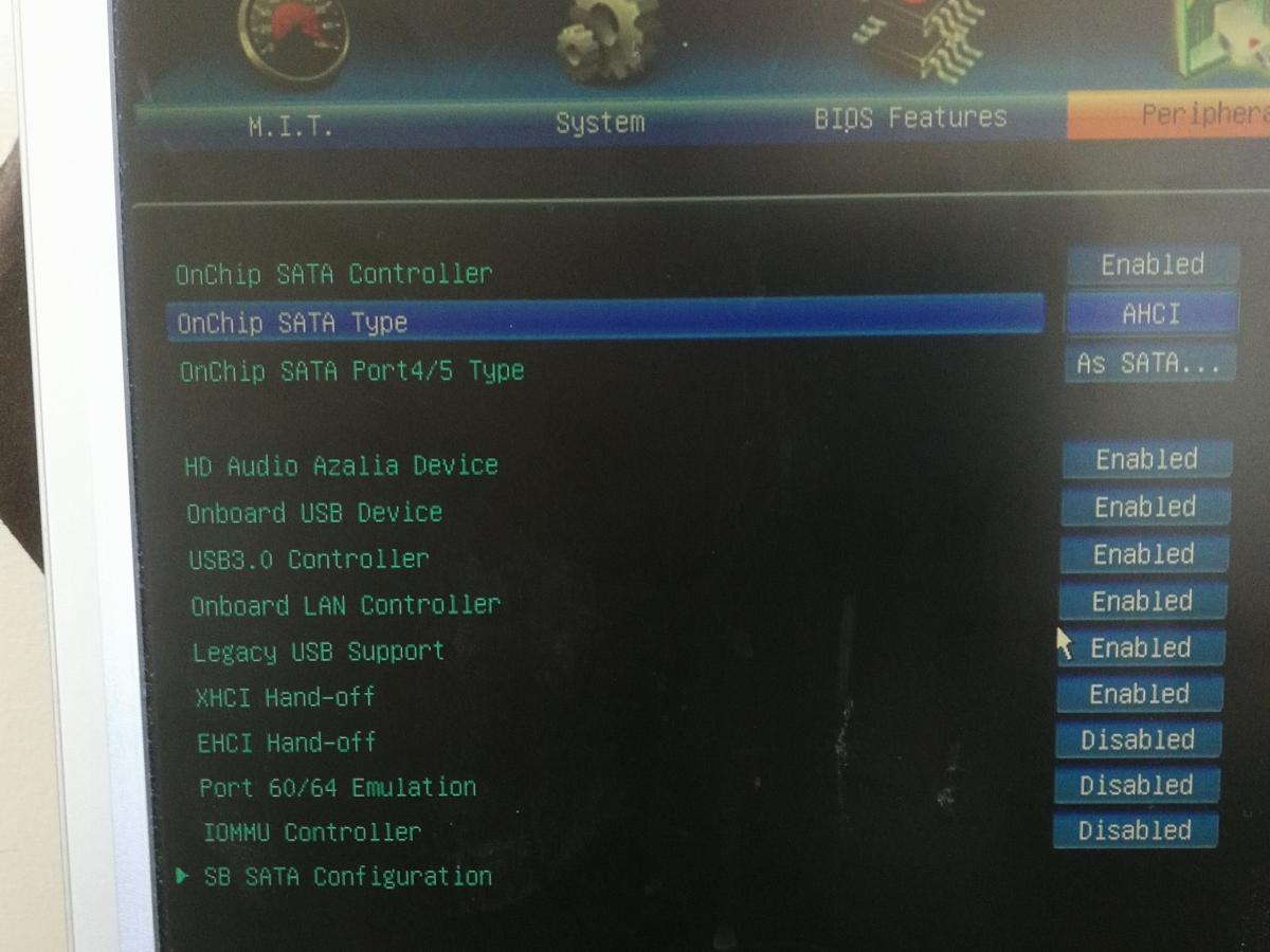

  • 228 posts
Both AHCI and Legacy only enabled but the problem stays...

  • 24,731 posts
Try changing OS Type (in first picture) to Windows 8

  • 228 posts
OS type changed with CSM support set to always and still nothing...

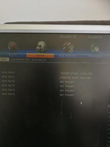

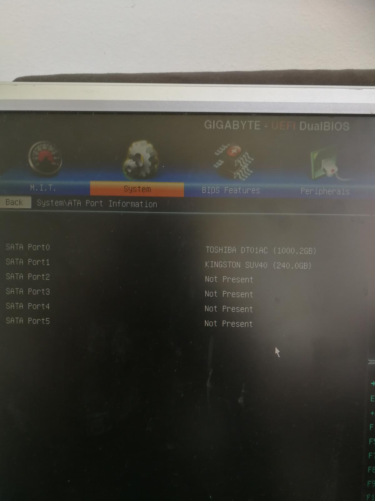

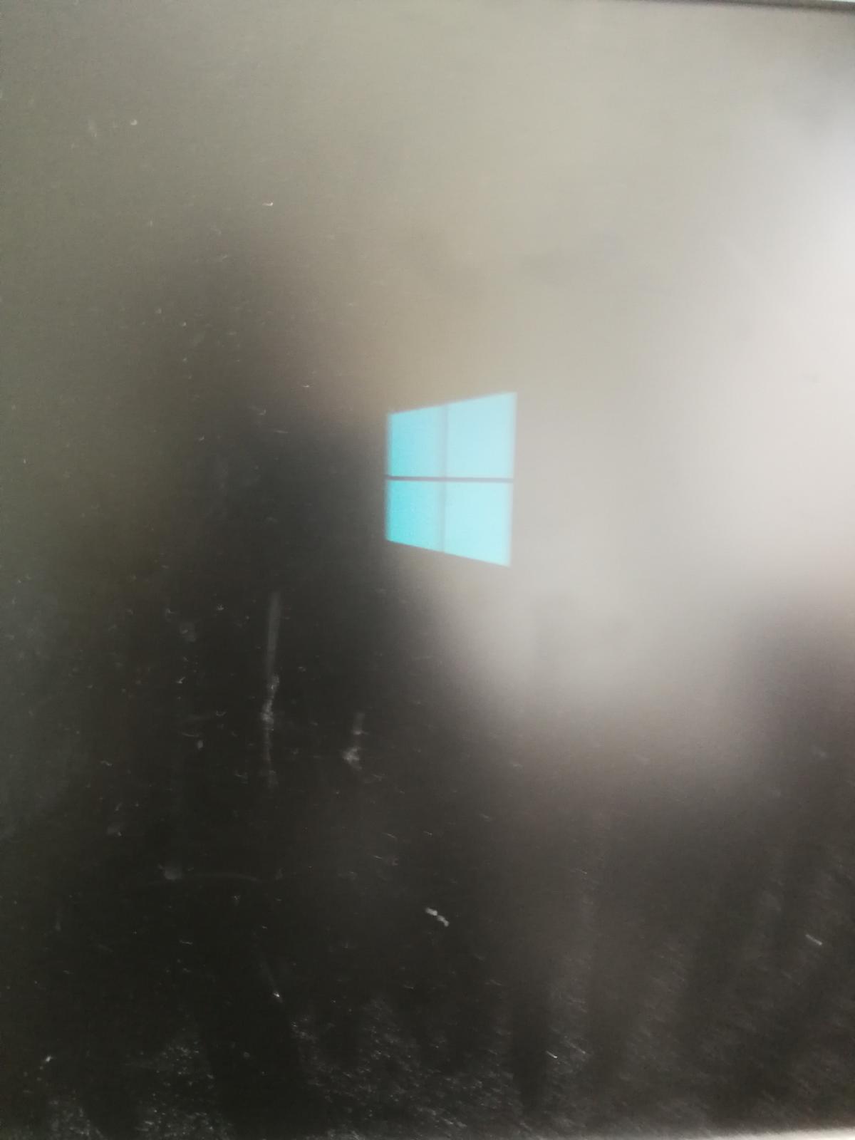

  • 228 posts
I guess it does,in BIOS I can see both but I noticed that BIOS automatically sets Toshiba as 1st boot option even if I set Kingston as #1.
Under ATA Port Info are named both disks.

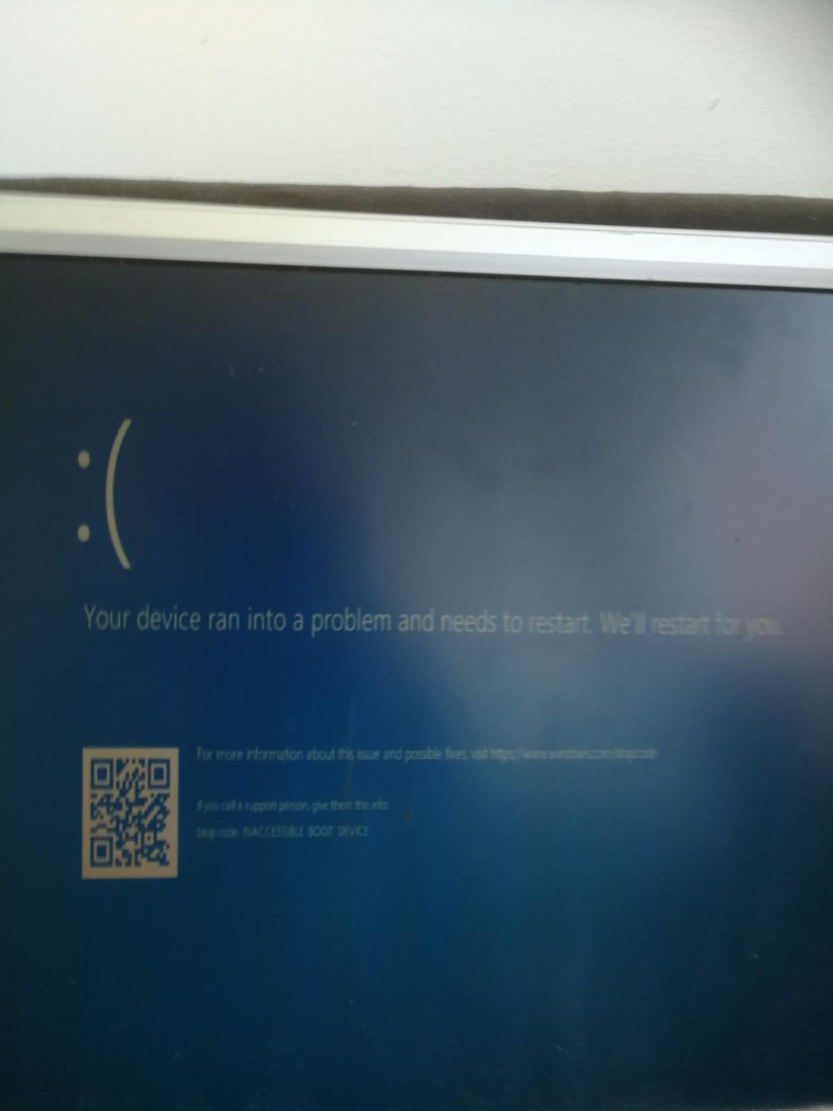

RAID is not the right one, it gives me blue screen (please see photos).

  • 24,731 posts
Thought we had the Toshiba disconnected until we got this sorted out.
If you swap the SATA connections to the hard drives that will make the Kingston show first in that last picture.

It appears that the RAID option got us closer to a boot than the other option.  Are there any options that appear when you select RAID?

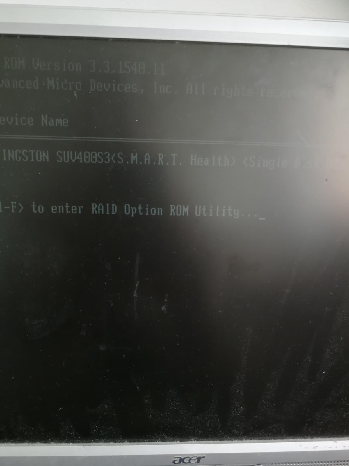

  • 228 posts
I just find out that SATA port0 may be damaged, I can't connect it on Kingston, on other two ports I can do that easily.
No options when I select RAID, on restart I got this text on screen and if I don't press anything that blue screen appears

  • 24,731 posts
Leave the Kingston where it is then and don't plug anything into the bad slot.   Examine the bad slot with a magnifying glass and make sure there aren't any bent pins or foreign objects in the slot.
It says there is a RAID option utility if you hit CTRL F.  Try that.  You want RAID 0 if that's not the default.  RAID 0 is supposed to be quicker than no raid so whoever set up this thing may have used it to try and speed up the PC.  Since you apparently did not build this PC is there any chance of asking the original builder how he set up the BIOS?
