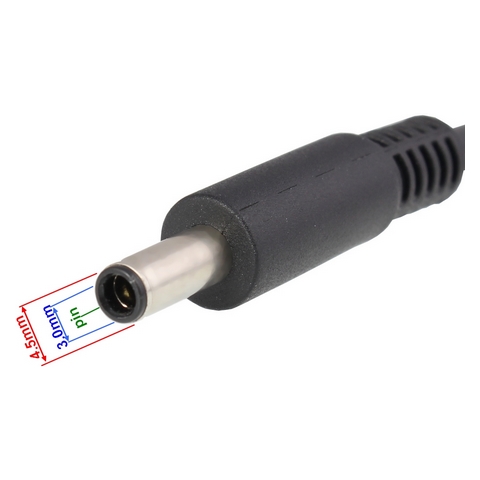

#53
  • 24,735 posts
Does the Dell power adapter have a center pin in the connector that plus into the Laptop?  Some HP laptops had the center pin and if it broke the laptop would still work but would be super slow.
#54
piotrzyna
piotrzyna
  • 47 posts
Power adapter plug included.
And as for the power supply socket, I do not know what to say, although it may also be worn out during so many years of its work.
Then I have to obtain an additional power supply and replace the power socket.
However, at present I do not have the means due to my illness. If I organize something, I will let you know and unfortunately it must remain as it is.
