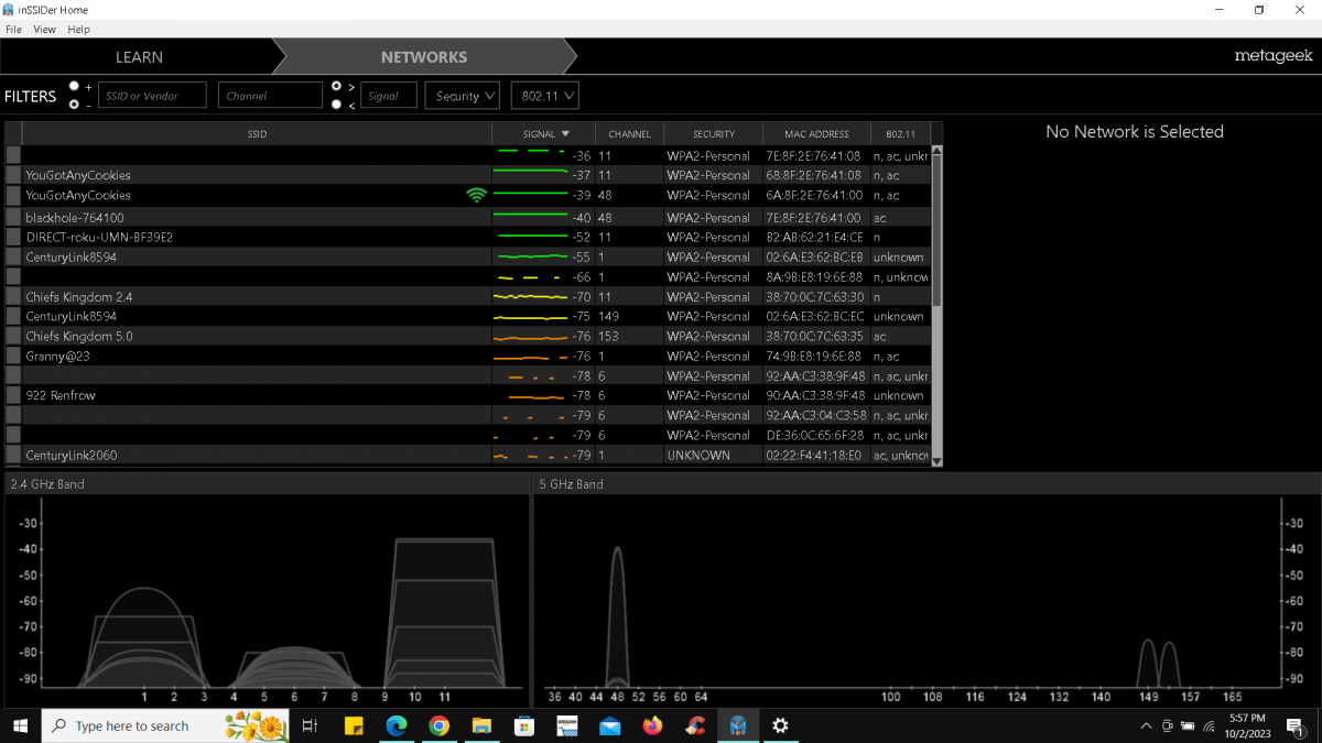

How do I find the best channel for the network the laptop is on?
I ran the inssider program and I'm seeing two channels...I'm attaching a screenshot, the network name is YouGotAnyCookies.
Do I need to change something?
The other computer in the house doesn't have wi-fi so I can't run the inssider on it.
I don't understand why this is a network error when it just started recently, we haven't made any changes to the router.

Looks like you are in an apartment building or somewhere with a lot of close neighbors who all have routers.  What usually happens if a close neighbor changes Internet providers and gets a new router which operates on a different channel which unfortunately is the same that you are using.  Since your other computer has an Ethernet cable you can temporarily move the laptop next to it and use its cable to connect to the laptop and see if that helps.  If it does then you really need to change channels.
There are two different bands used in WiFi these days.   The older 2.4 GHz band uses channels 1-11 and the newer 5 GHz band uses 36-165.  Speccy claimed you were using channel 11 but Inssider says you are now on channel 48 (along with blackhole-764100 which is almost as strong) .  I expect since both of your routers bands use the same name that the PC gets confused and sometimes connects to one and sometimes the other.  They really should have different names so you (and the PC) can tell them apart.
You definitely want to use the 5 GHz band as the 2,4 GHz band is too busy.  I would rename the 5GHz band to YougotanyCookies5 and  move it from channel 48 to channel 36.  Inssider doesn't show anything currently on 36.  (When you get to the channel assignment on your router it will probably be set to Auto.  You will need to change Auto to Manual before it will let you select a channel.).  Once you Save the changes and reboot the router you will need to tell the PC about the new preferred network.
If you have other devices that use only the 2.4 or if the router only lets you use one name I would move the 2.4  to either channel 4 or 8.

Changed the name on the router two different bands and put the 2.4 on wireless channel 8, seems to be working better.
I'll let you know if something changes. Anything else you would suggest fixing or working on?
Thank you for you help and time to fix this, I really appreciate it!

I did just now try to plug the cable from the router into the laptop, and it doesn't seem to be doing it. Webpages seem to load much quicker with no error messages.
  • 24,734 posts
I'd try moving the channel to 36 on the 5GHz band and then use it.  See if that helps.  The 2.4 band is just really busy.
BKMart501
BKMart501
  • 16 posts
Moving the laptop to 5GHz seemed to have corrected the problem with loading the the websites.
