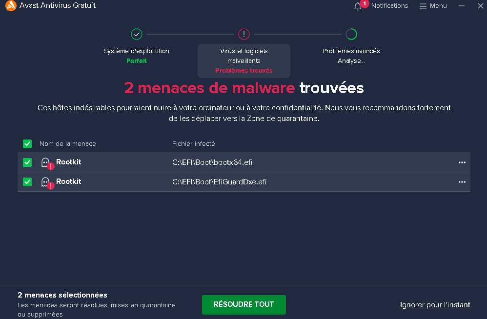

Hello,unfortunately,it is still here.Waiting for your instructions

Yes, we didn't expect them to go away, but I just asked.
Tomorrow I'll be back to you with a new set of instructions, about upgrading/flashing the BIOS.

As I wrote here:
In fact, we can't say what those detections by Avast are (bad or harmless). The "EfiGuardDxe.efi" shown on the Avast screen could be used not only by malware but some non-malicious software to bypass Windows locks. It could be that you installed it manually (eg. together with a game patcher or something like that). From what I see in your logs, this is something possible. Right?
In case they are bad, you can't target that by normal programs and reinstalling Windows won't help either. To remove an infection inside UEFI firmware flashing / upgrading the BIOS is the solution. But let's leave that at the moment. Now, we are going to clean the operating system, and later see what to do with the BIOS.

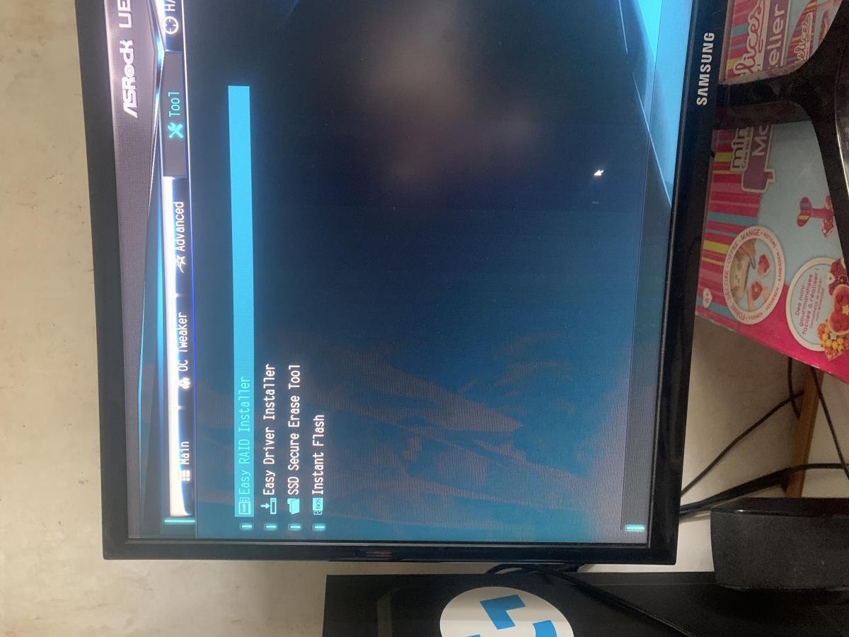

1. Enter UEFI Settings on boot.***
2. Go to the similar interface like shown here (Tool menu): https://www.asrock.c....asp?cat=BIOS10
3. Instead of "Instant Flash" select "Internet Flash" and let the upgrader automatically search for a newer BIOS. Follow dialogs.

Hello,i do not have that option.
Here is a picture

So in this case "Instant Flash" to be used.
1. Download version 7.00:
https://www.asrock.c.../index.asp#BIOS
2. Then follow instructions:

Hello,i ve done it and avast sill detects them,is it normal?

Check Avast's detections and let me know.

Hello,it is still here.Waiting for your answer.
