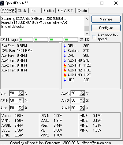

Let's check your temperatures first.  Hopefully Speedfan will work for your system.
Go to:
Click on Download Latest Version for Windows (3.09MB)
A new window will appear trying to get you to download something else (probably Winzip).  On the bottom of the window click on:
Save the file then go to your Downloads folder and right click on the file and Run As Administrator.  Once it installs there will be a shortcut on your desktop.  Right click on it and Run As Administrator.
You will get a tip screen the first time it runs.  There is a box to check to tell it to not show it again and a way to close the tip but I do not remember exactly how to do it.
Once it is running:  On the General tab (if it works for your computer and language) it should show you several temperatures.  What is the highest temperature shown (in C)?
 Hit Configure then click on the highest temp and check Show in tray.  While still in Configure hit Options and change the Icon Text color to yellow and the Icon Background color to blue (the point is to make it easier to see/  Feel free to use different colors that work for you.)  Now Minimize Speedfan.
Win 10 hides icons by default so: Settings, Personalization, Taskbar, Select which Icons appear on Taskbar,  then turn Speedfan ON.  You should now see the highest temperature that you selected in the area down by the clock.
With no other programs running what is the highest temp you see?  Play a game, watch a video or do a virus scan.  How high does it go?  We want it to stay under about 65.  70 and over indicates it is overheating which can cause lots of problems.

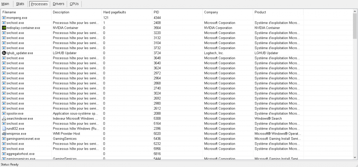

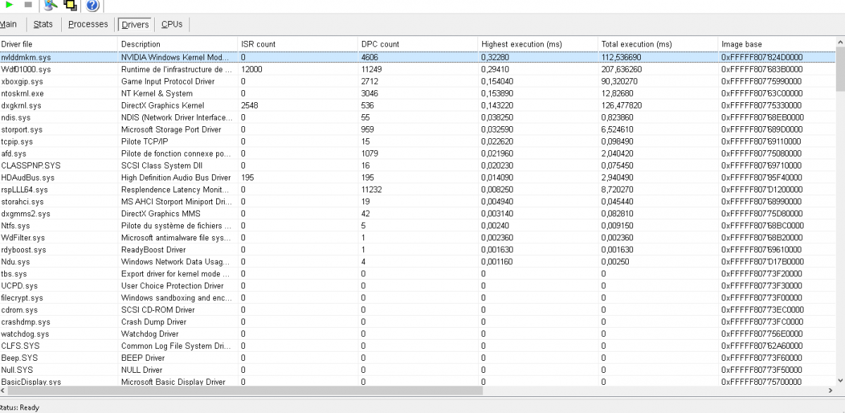

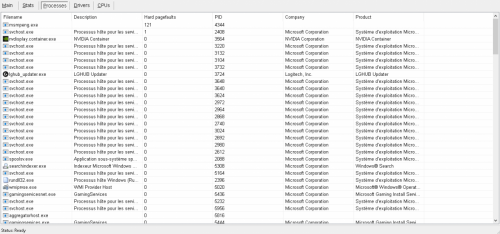

Hello,thank you for your answer.As it doesnty present itself as you said, i sent a screenshot of the main tab in SpeedFan.
I have temperatures over 110degrees on things calleed AUXTIN1,AUXTIN2 and AUXTIN3.
I ran the memory test and no errors were detected.
After running the Who crashed analyse,i put the results on a notepad file wich i called "whocarshedlog".It is in this reply.
About Process Explorer,i put the txt file below too,called"log.txt".
about LatencyMon i did the same "latencymon.txt".
I also put the drivers tab screenshot as well as the processes one.
i wish you a good day or evening or even night(idk where you re from),and thank you for your help. :)
Edited by bambidbl, 11 April 2024 - 11:32 AM.

I think Speedfan is picking up some bad info (it hasn't been updated in about 8 years) but the CPU and GPU temps look OK.
Latency Monitor shows Wdf01000.sys is very active.  You might try
Way 1: Disable High Precision Event Timer
on
https://www.minitool...gh-latency.html
The High Precision Event Timer isn't used much any more so it shouldn't hurt anything but you can go back and reenable it if
it causes a problem.  Please tell me if you notice something not working after the change.
Please rerun Latency Monitor again after making the change and let's see if the drivers page changes.
Process Explorer doesn't show any real problems though Interrupts are a bit high.  (A sign of a poorly written driver)

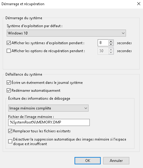

WhoCrashed says you have a bad driver but it needs more info.  In Windows, go to
Settings, System then on the right side of the screen click on Advanced System Settings.
That will take you to the old Control Panel =>System window.  Near the bottom of the window find
Startup and Recovery
and click on its Settings.
This will bring up a new window.  About 2/3 of the way down find
Write debugging information
Click on the box just below (Default says Kernel Memory Dump)
A menu will open up.  Select
Complete Memory Dump
then OK. OK.
Then wait until it crashes again and rerun WhoCrashed.  Hopefully it will tell us which driver is the problem.

It doesn't look like you configured your System for Complete memory dump since WhoCrashed is still complaining.

Little update,i crashed again with a different code (KERNEL_DATA_INPAGE_ERROR)
I believe i understand that whocrashed and minitoolbox will give info about it som i m sending you new logs.
