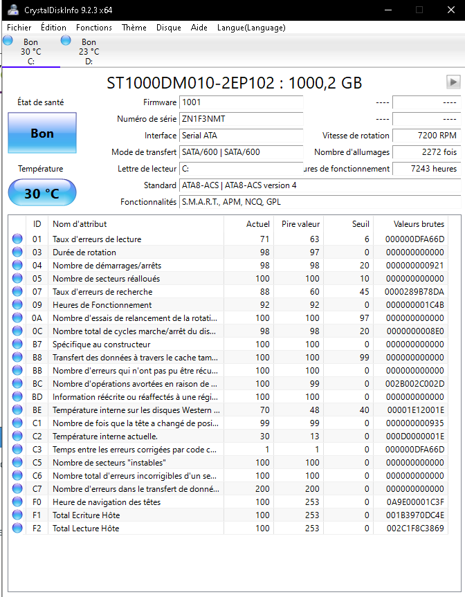

( 2 ) Download and run CrystalDisk info standard edition from here
Run the program, grab any screenshots and attach to your next reply for us.

Hello,i followed the instructions of the reply #13 of this topic and some xbox services got updated automatically.
I put the screenshot of crystaldiskinfo in this post.

The drive as can be seen has a clean bill of health.

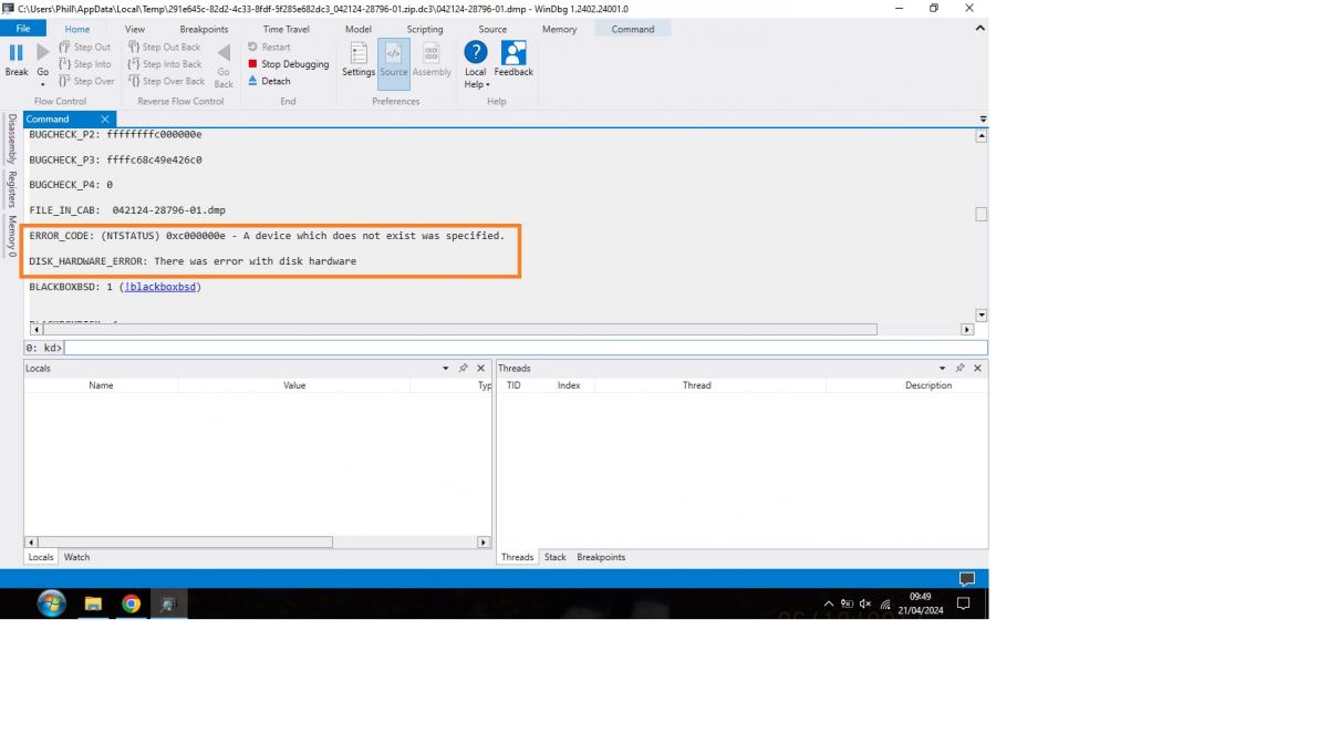

Hello,i got a bsod with the code "KERNEL_DATA_INPAGE_ERROR"
i put the dump file below in this reply.

  • 24,800 posts
This latest crash was 100% related to a HDD, see the attached;

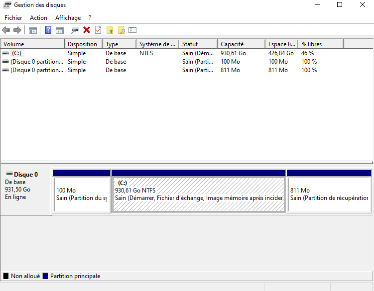

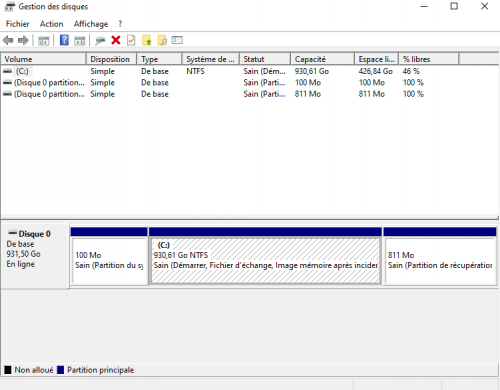

Can you upload an expanded screenshot of Disk Manager for us.
Access Disk Management via Run.
Press the Windows+R keys to open Run, type diskmgmt.msc in the empty box then press OK.
Click on the ALT key + PRT SCR key..its on the top row..right hand side..now click on start...all programs...accessories...paint....left click in the white area ...press CTRL + V...click on file...click on save...save it to your desktop...name it something related to the screen your capturing... BE SURE TO SAVE IT AS A .JPG ...otherwise it may be to big to upload... then after typing in any response you have... click on Attach Files tabs...desktop...find the screenshot..select it and click on the upload button...then on the lower left...after it says upload successful...click on add reply like you normally would.
Once you have taken and uploaded the screenshot of Disk Management, disconnect the external USB HDD and keep it disconnected for an extended period of time while using the PC as much as you can to see if you get any more BSOD.

Hello,i only have one disk running on my pc and everything windows included is on it.Do i really need to disconnect it?
