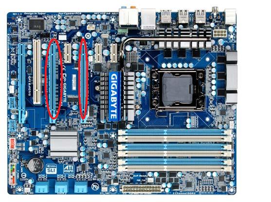

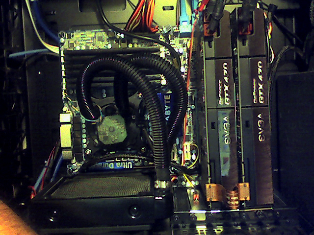

Now, the details of what I DID do that involved the graphics cards. Never had two video cards before, so I get the machine, plug my HDMI wire into one of the cards in back, and start my journey. Thing has crashed DAILY since I got it in Dec 2010. Daily. Sometimes after it would crash it wouldn't come back up. So, I would hit buttons (like the CLEAR CMOS button) just to try and get something. Usually it would come back up. A couple months ago though, no go. Wouldn't come back up after a crash. Now at this point, I must tell you that this was the first computer I EVER had that had no video signal until Windows came up. For all of those months I would start up, and my monitor would go to sleep due to no signal until Windows came up. I thought it strange since all my others had some sort of splash screens come up where you could hit keys and go into BIOS, etc.
So, when it wouldn't come back up a couple months ago, I changed video cards my HDMI wire was plugged into. So it eventually came back up and when it did I suddenly for the first time since I owned it saw a screen pre-Windows. It was a big, colorful GIGABYTE screen, where now I could in fact press buttons to go into BIOS. So it seems I had my HDMI wire plugged into the wrong video card for several months.
Anyway, that's the change I spoke of above. But like I said above, it didn't start right after that. At least I don't think it did. It seems like there was some time between that event and the first event of it coming up with code 43 errors. And my bad memory (so I may be wrong) keeps insisting the event that occurred around that time was a Windows Update. But I don't see how a Windows Update could possibly affect that so I guess my memory is wrong there.
Again, sorry for the length. I know you guys aren't speed readers too and I'm asking so much of your time in reading. So sorry.

YOUR motherboard I believe - which slots are the two graphics cards in now please.
From your motherboard details
if you are installing two PCI Express graphics cards, it is recommended that you install them in the PCIEX16_1 and PCIEX16_2 slots.
Edited by Macboatmaster, 06 November 2011 - 01:01 PM.

I opened up the case and it's hard to tell because the GPU's are so huge they actually take up quite a bit of space so it's hard to tell where they're actually plugged into, but I THINK I've circled the two places where they are plugged into.
And THANK YOU SO MUCH for your help. Sure wish I could buy you a beer. Or a cup of jo. Or something.
I will put the case back together and fire it up and see if I can run checkdsk and check those other things for you. Give me a couple minutes. LOL, I always take so much caution when opening and closing the thing it takes longer than what it probably should. Be back in a minute.
EDIT: Actually looking at that photo again, it doesn't really look like mine. At least something looks very different. The GIGABYTE thing is even very different. I don't think I circled the right areas because I don't think that's my motherboard. I'll see if I can snap a photo of my motherboard but the lighting my be bad.

OldFatGuy
OldFatGuy
  • 54 posts
Well, it's hard for me to get a good shot of it. LOL trying to take a pic with the SNAPSHOT component of my laptop's webcam is clumsy. Holding the laptop in the air and pointing the screen where I think it's at is hard, plus the lighting is bad, plus it's so crowded in there it's hard to see anything for sure, but I don't think mine is the same one as the photo.
Here's mine, FWIW. Can't really tell anything by this though.
