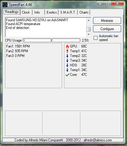

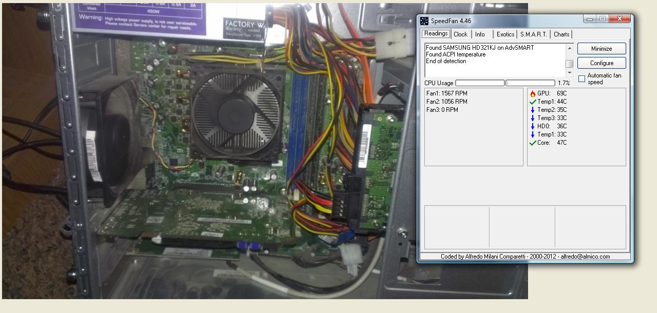

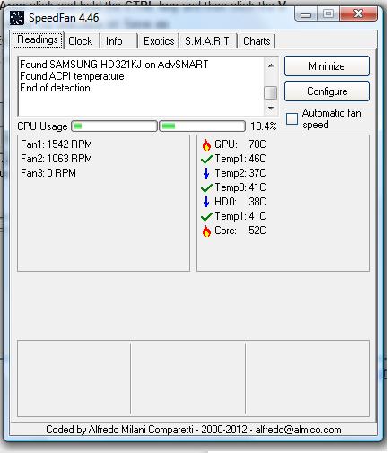

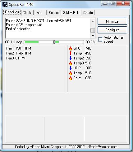

here are my speed fan results
1st one is Out of of Cabinet, side off
2nd is back in cabinet, side off
3rd is start up after a couple hours off, out & open.
Attached thumbnail(s)
  • Attached Image: outofcabinet.jpg
  • Attached Image: incabinet.jpg
  • Attached Image: startup.jpg

Yeah you have a heating issue for sure.

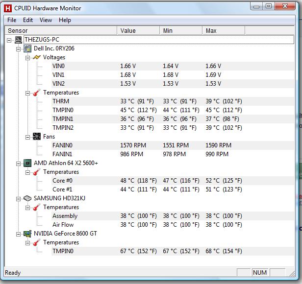

Please do the following for me also.
Please download and run Hardware Monitor
Installation (setup version only)
HWMonitor is a hardware monitoring program that reads PC systems main health sensors : voltages, temperatures, fans speed.
The program handles the most common sensor chips, like ITE® IT87 series, most Winbond® ICs, and others. In addition, it can read modern CPUs on-die core thermal sensors, as well has hard drives temperature via S.M.A.R.T, and video card GPU temperature.
Get a screenshot of the sensor window for me please.
#13 ZUGtastic
  • Group: Member
  • Posts: 73
  • Joined: 24-May 12
Posted 29 May 2012 - 08:31 PM
here ya go
  • Attached Image: pctemp.jpg
#14 rshaffer61
  • Group: Moderator
  • Posts: 32,408
  • Joined: 28-February 09
Posted 29 May 2012 - 08:40 PM
Yeah it looks like the video may be running a little high. Might double check that fan to be sure.

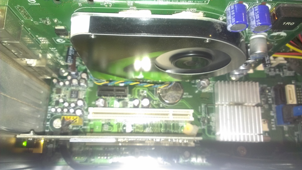

#15 ZUGtastic
  • Group: Member
  • Posts: 73
  • Joined: 24-May 12
Posted 29 May 2012 - 08:47 PM
I assume your talking about this one??? Its running
  • Attached Image: IMAG0062.jpg
