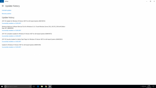

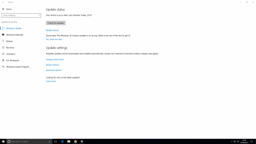

You seem to be missing Windows 10 updates, is it updating ok.

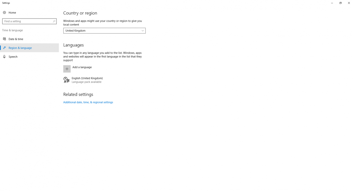

Something off in Speccy;
TimeZone
TimeZone: GMT
Language: English (United States)
Location: United States
Format: English (United Kingdom)
Currency: £
Date Format: dd/MM/yyyy
Time Format: HH:mm:ss

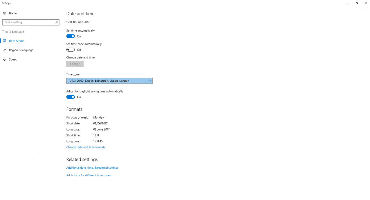

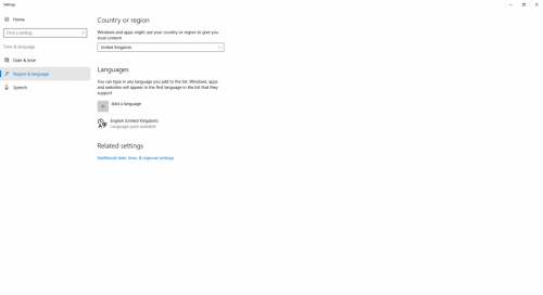

Any idea why your TimeZone is set for the UK but your location is shown to be the US  :headscratch:

Windows update says everything is up to date
I'll uninstall mbam and check again for updates
Iansville
Iansville
  • 23 posts
heres whats showing under updates
TimeZone
TimeZone: GMT
Currency: £

Ive absolutely no idea why the TimeZone is set for the UK but my location is shown to be the US but I have changed it
Where do we go from here?
Is this fixable or not
Edited by Iansville, 09 June 2017 - 07:33 AM.

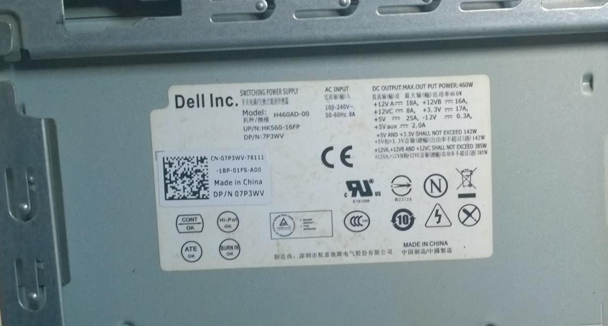

What is the brand and model name or number of the PSU.

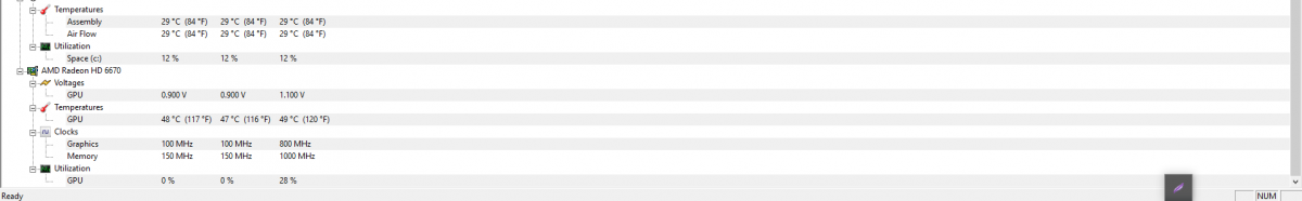

The voltage readings for your MB look on the low side (what I have highlighted in red) the readings could be anomalous but we should check them to be on the safe side
Voltage
CPU CORE: 1.044 V
MEMORY CONTROLLER: 1.512 V
+3.3V: 2.808 V
+5V: 2.782 V
+12V: 10.992 V
-12V: -8.880 V
-5V: -8.880 V
+5V HIGH THRESHOLD: 2.782 V
CMOS BATTERY: 1.524 V

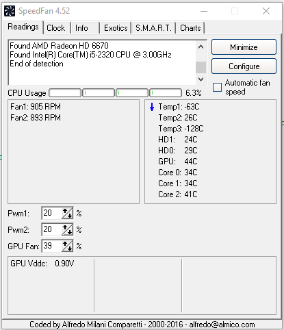

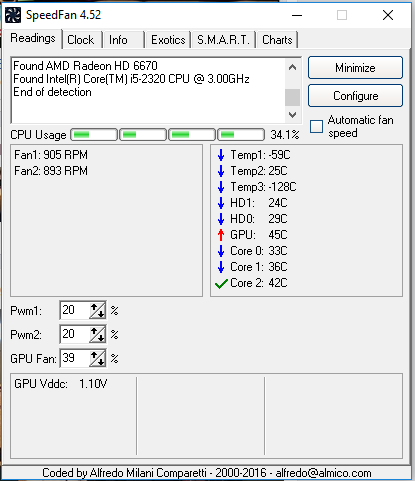

Please take expanded screenshots and only use the method below to attach them.
Download Speedfan from here and install it.  Once it's installed, run the program and post here the information it shows.  The information I want you to post is the stuff that is circled in the example picture I have attached.
Iansville
Iansville
  • 23 posts
1st screenshot is after the test had run
2nd is after I refreshed a web page
Edited by Iansville, 10 June 2017 - 06:25 AM.
  • 25,122 posts

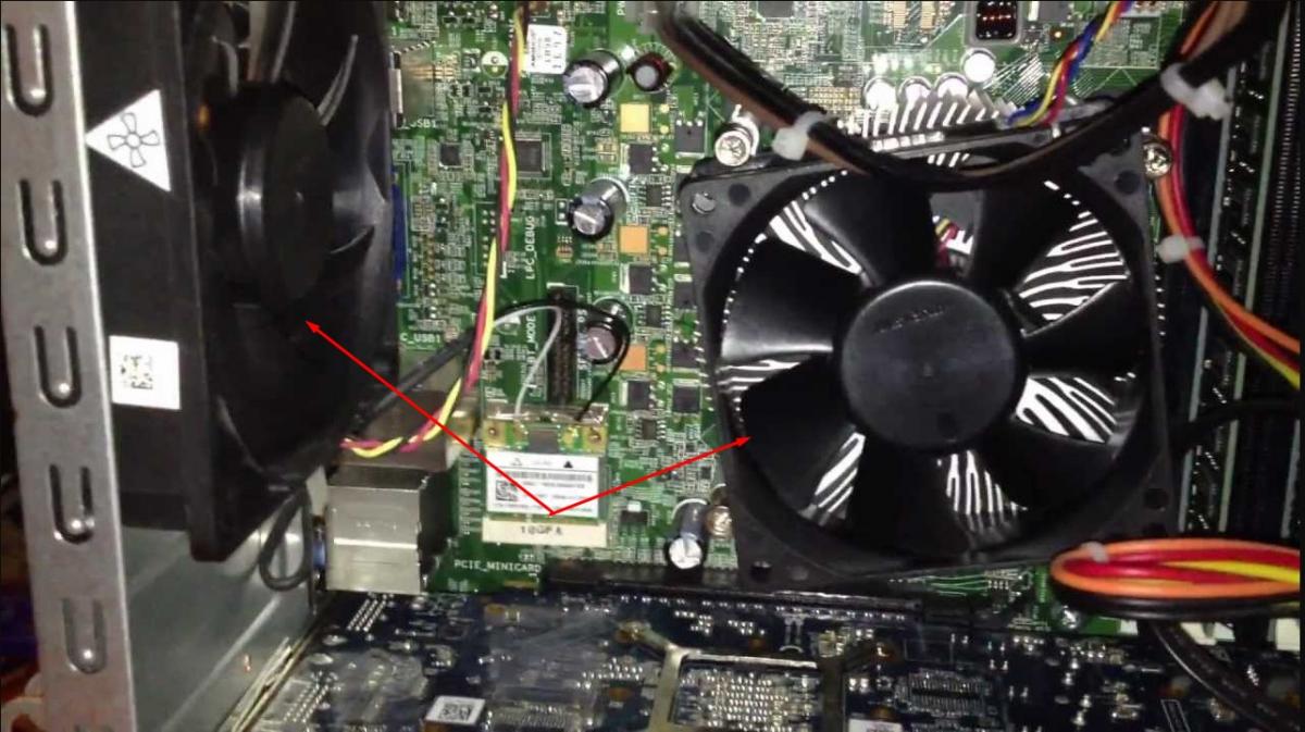

  • 23 posts
Its the stock PSU
Ive managed to get a readable pic
In getting that pic Ive noticed that these 2 fans are both running
Edited by Iansville, 10 June 2017 - 01:29 PM.
  • 25,122 posts
Good pictures and they do help  :thumbsup:
The CPU usage after a refresh looks high but if it settles down quickly it is normal as long as it only takes seconds.
No high temps being reported and the inside of the case is nice and clean, both good but the voltage readings reported are not helpful, it could be the Dell BIOS interfering with HWMonitor but unfortunately we have no way of knowing for sure, most MB BIOS allow you to check the temps and +3.3, +5 and +12V readings but OEM computers such as Dell and HP have very little to no such information available, below is my canned info for checking just in case;

One thing that I did notice is the combined output on the +12V rail of the PSU which says 385W, your video card requires a 400W output PSU with 27 amps on the +12V rail, card manufacturers often overstate the power requirements for their products to cover their own backs and an underpowered PSU would normally result in overheating and/or instability such as BSOD, you are having trouble with neither which suggests that your PSU is ok, the VCore voltage for the CPU also looks good in HWMonitor which suggests that power spikes are not an issue.
To summarise, everything looks good with your software and other than you having an older video card that could be getting tired there looks to be nothing wrong with your hardware either.
