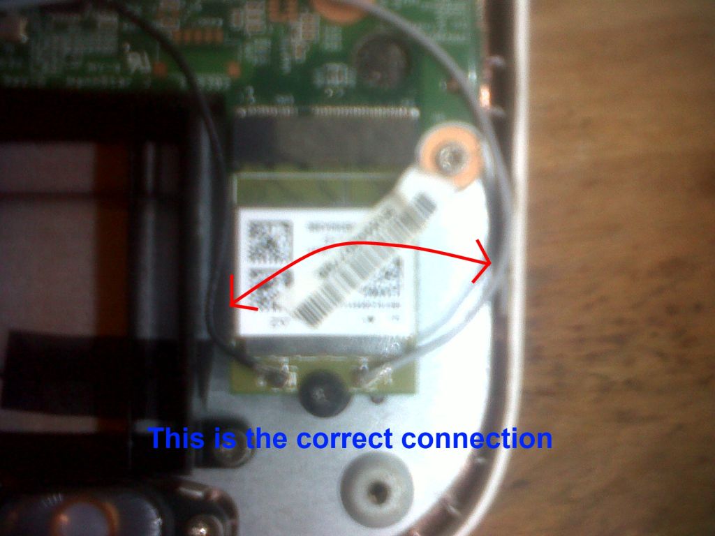

I tried all solutions there and it didn't work. Then I decided to perform a simple test to check hardware; I booted HBCD>Parted Magic, checked the Wi-Fi networks and they weren't detected either. In that case, a Windows misconfiguration is discarded.

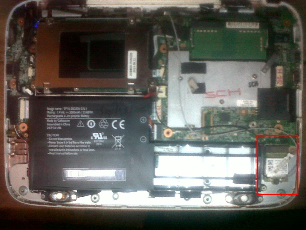

I opened some other laptops and noticed they had the antenna cables connected otherwise, so I inverted the cables and it worked.
So, the gray cable goes where it says "1 MAIN" and the black cable goes on the other side "2 AUX".
I guess I connected them wrong the last time I opened this laptop.
I took 2 photos (Crappy quality, I know)
