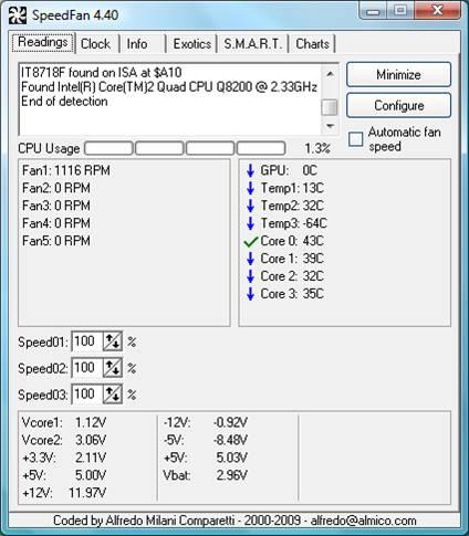

I ran Sandra Lite and here is a scrnshot of the processor module test
and for comparison here is the same for Speedfan
Are the differences significant?

On SandraLite please see my screnshot.
Click on Mainboard. Scroll on window that opens, to voltages and check against previous readings as the only voltage on your image is the CPU core voltage.
If the voltages on Sandra Lite are nearly the same as Speedfan you do not need to post them unless of course you so wish
Please keep Sandra Lite for the time being on your computer
I will come back to you later on the - voltage readings on speedfan.

Your previous screenshot of Sandra Lite was processors.
I have never known SandraLite not to include voltages on the Mainboard screen, but it does depend what SandraLite can read.

Finally - I still have a slight concern regarding your voltages on speedfan, on the -12 and -3.3
If you DO start to re-encounter errors in addition to Memtest etc I would consider a PSU test.
The old idea of a mutimeter job - is not worthy of trying for that possible fault.
The best test is - try with a known good PSU if possible.
