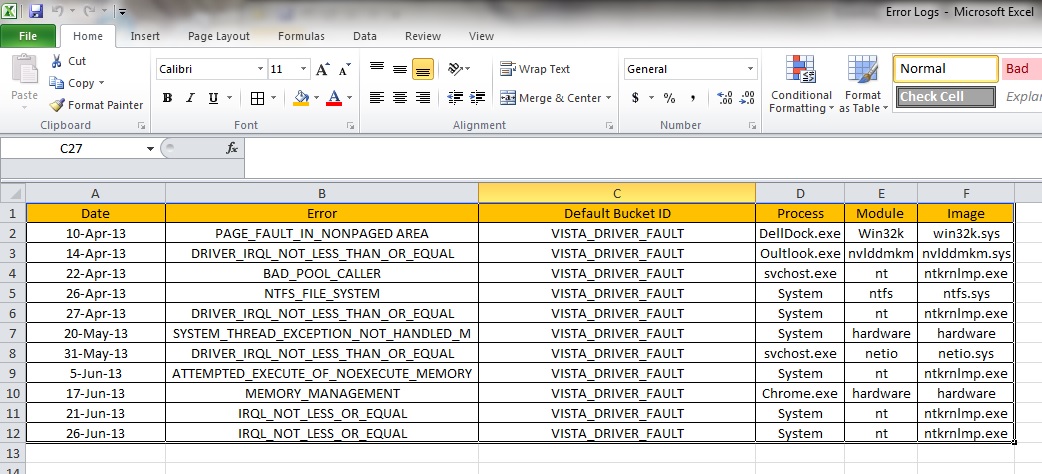

After reading the Dell tutorial on Windows Debugger, I compiled this:
Date Error Default Bucket ID Process Module Image
10-Apr-13 PAGE_FAULT_IN_NONPAGED AREA VISTA_DRIVER_FAULT DellDock.exe Win32k win32k.sys
14-Apr-13 DRIVER_IRQL_NOT_LESS_THAN_OR_EQUAL VISTA_DRIVER_FAULT Oultlook.exe nvlddmkm nvlddmkm.sys
22-Apr-13 BAD_POOL_CALLER VISTA_DRIVER_FAULT svchost.exe nt ntkrnlmp.exe
26-Apr-13 NTFS_FILE_SYSTEM VISTA_DRIVER_FAULT System ntfs ntfs.sys
27-Apr-13 DRIVER_IRQL_NOT_LESS_THAN_OR_EQUAL VISTA_DRIVER_FAULT System nt ntkrnlmp.exe
20-May-13 SYSTEM_THREAD_EXCEPTION_NOT_HANDLED_M VISTA_DRIVER_FAULT System hardware hardware
31-May-13 DRIVER_IRQL_NOT_LESS_THAN_OR_EQUAL VISTA_DRIVER_FAULT svchost.exe netio netio.sys
5-Jun-13 ATTEMPTED_EXECUTE_OF_NOEXECUTE_MEMORY VISTA_DRIVER_FAULT System nt ntkrnlmp.exe
17-Jun-13 MEMORY_MANAGEMENT VISTA_DRIVER_FAULT Chrome.exe hardware hardware
21-Jun-13 IRQL_NOT_LESS_OR_EQUAL VISTA_DRIVER_FAULT System nt ntkrnlmp.exe
26-Jun-13 IRQL_NOT_LESS_OR_EQUAL VISTA_DRIVER_FAULT System nt ntkrnlmp.exe
It's all over the map!

That is why I am looking at RAM initially .. I do not feel that this is software orientated

Sorry, not formatted. Here's a better image
