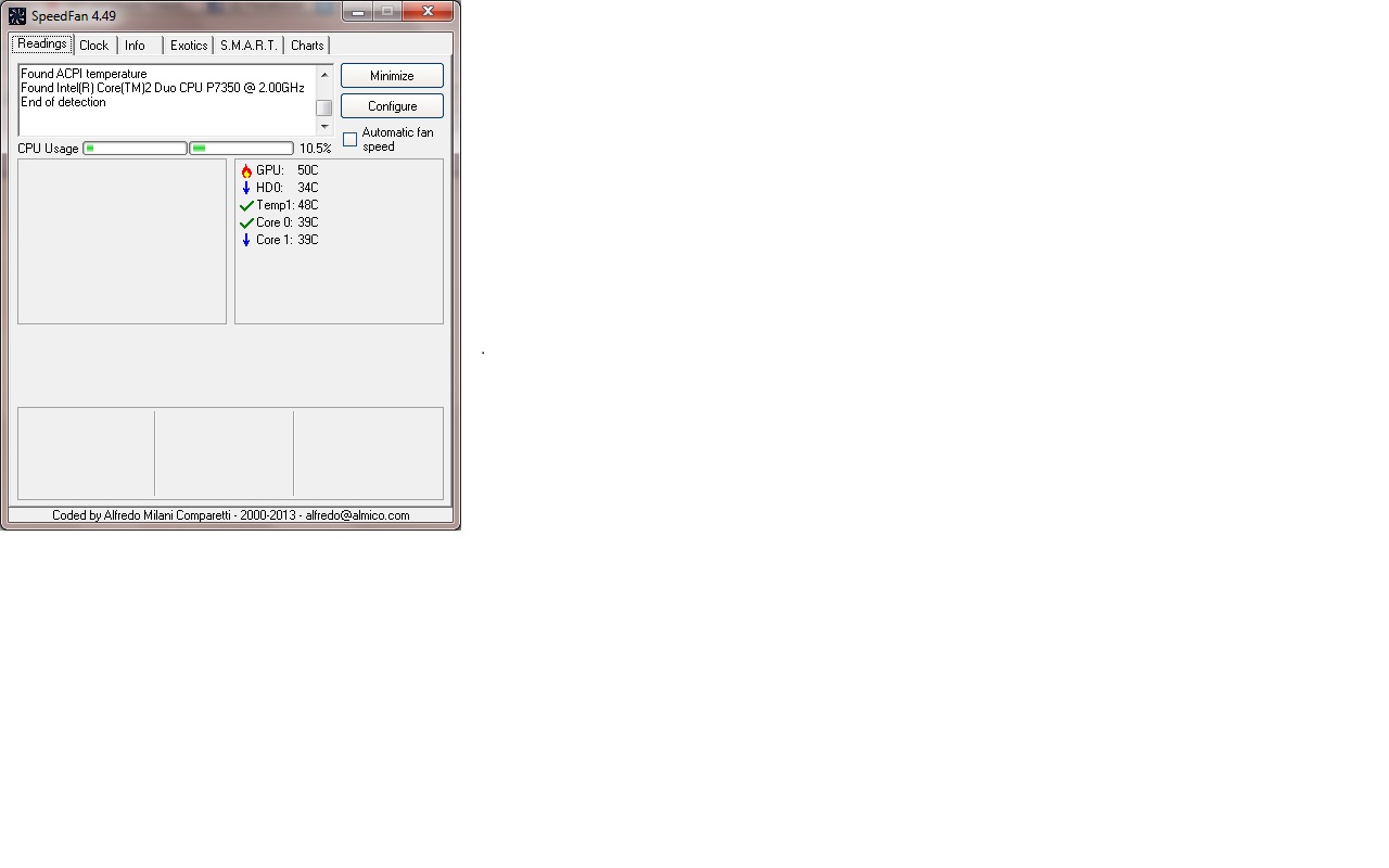

Just for general purposes please do the following.
elsavako
elsavako
  • 84 posts
here it is... strangely no info on fans!
thanks! Anna

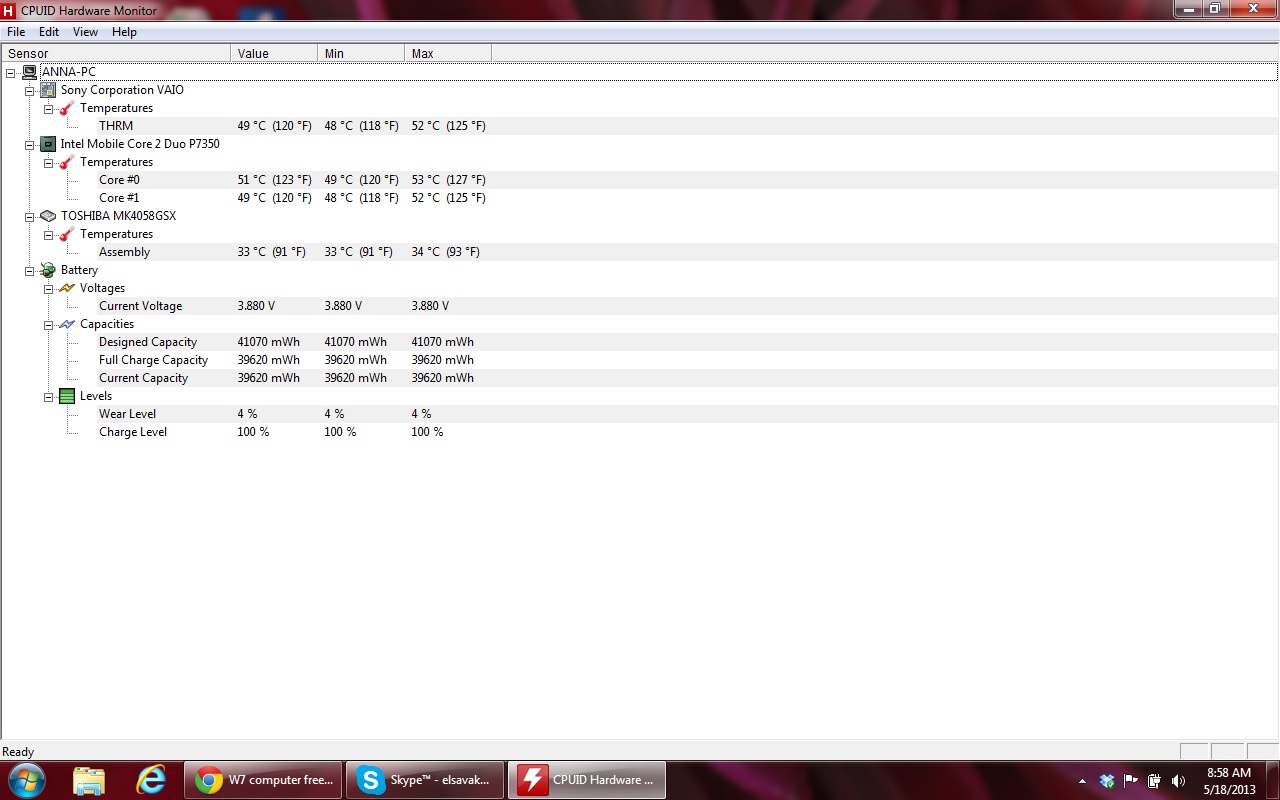

Doesn't surprise me at all being a laptop. Lets try a different program and see what it shows.
Please download and run Hardware Monitor
Installation (setup version only)
HWMonitor is a hardware monitoring program that reads PC systems main health sensors : voltages, temperatures, fans speed.
The program handles the most common sensor chips, like ITE® IT87 series, most Winbond® ICs, and others. In addition, it can read modern CPUs on-die core thermal sensors, as well has hard drives temperature via S.M.A.R.T, and video card GPU temperature. Please get a screenshot of the sensors window and post it in your next reply.
elsavako
elsavako
  • 84 posts
Hi, here it is (attached)

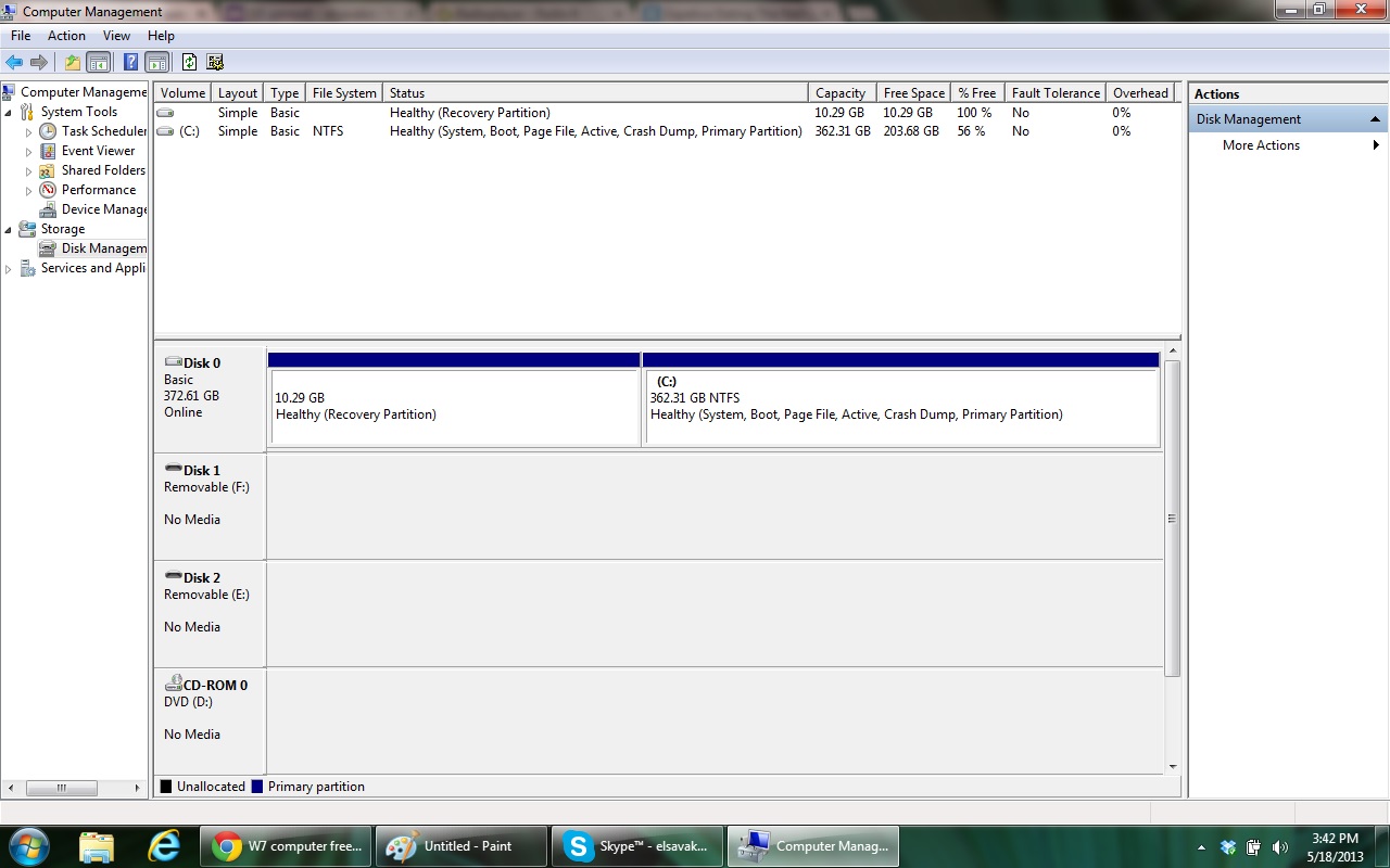

Thirdly can you do the following.
Go to Start then to Run
Male sure the window is open all the way on the top right so I can see all the info it has.
Save as file type JPEG or PNG and save it to your Desktop
Make sure the window is open all the way so I can see everything on the top right window.
Attach it to your next reply

1. Attached the screenshot
