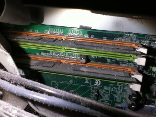

Can you get some pics of the inside of the system so Sleepydude and I can see how bad it is please.

Well, this is not at all my specialty, but I think there are 2.
Here is the photo, but I think it is correct.
and on the one at the top it is written 512MB
Ok, from the photo I can see the machine needs cleaning!
To clean the PC you should disconnect from power and use a compressed air can.
