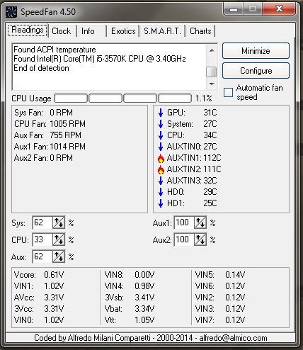

Ok, so when the freezing happens its mainly during video. I tend to watch alot of Twitch streamers and I play RuneScape at the same time. It helps make the time go by. The audio is coming from the motherboard but video is set to come througfh a graphics card I bought, the Nvidia GeForce GTX 760, via a HDMI cable.
Recently during videos I've been having like half a second freezing but it only ever happens during video playback. I've had my PC on for hours playing music, looking at website, playing RuneScape on its own and nothing. But video definately seems to be the glitchy bit. Should I take out the video card and see if I get the same thing?

Download Speedfan and install it.  Once it's installed, run the program and post here the information it shows.  The information I want you to post is the stuff that is circled in the example picture I have attached.

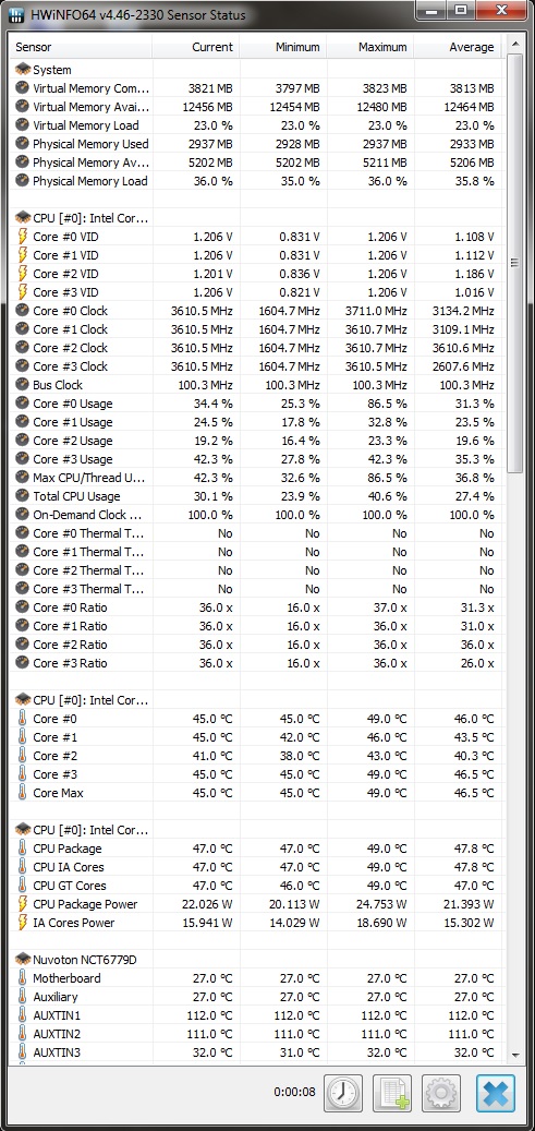

This is speedfan test. AUXTIN1 and 2 results worry me.

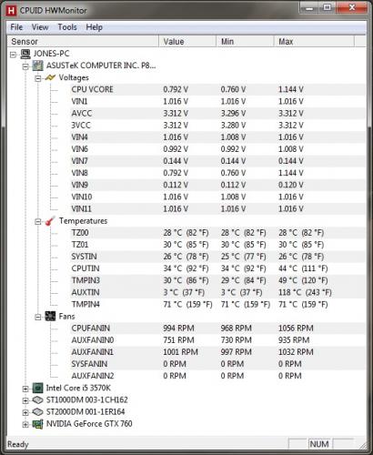

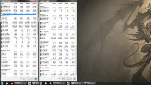

Before I could reply, I lost picture on my monitor, it just went blank on me. The PC itself didn't restart but just lost picture, monitor is still good. Here is HW thingy results:

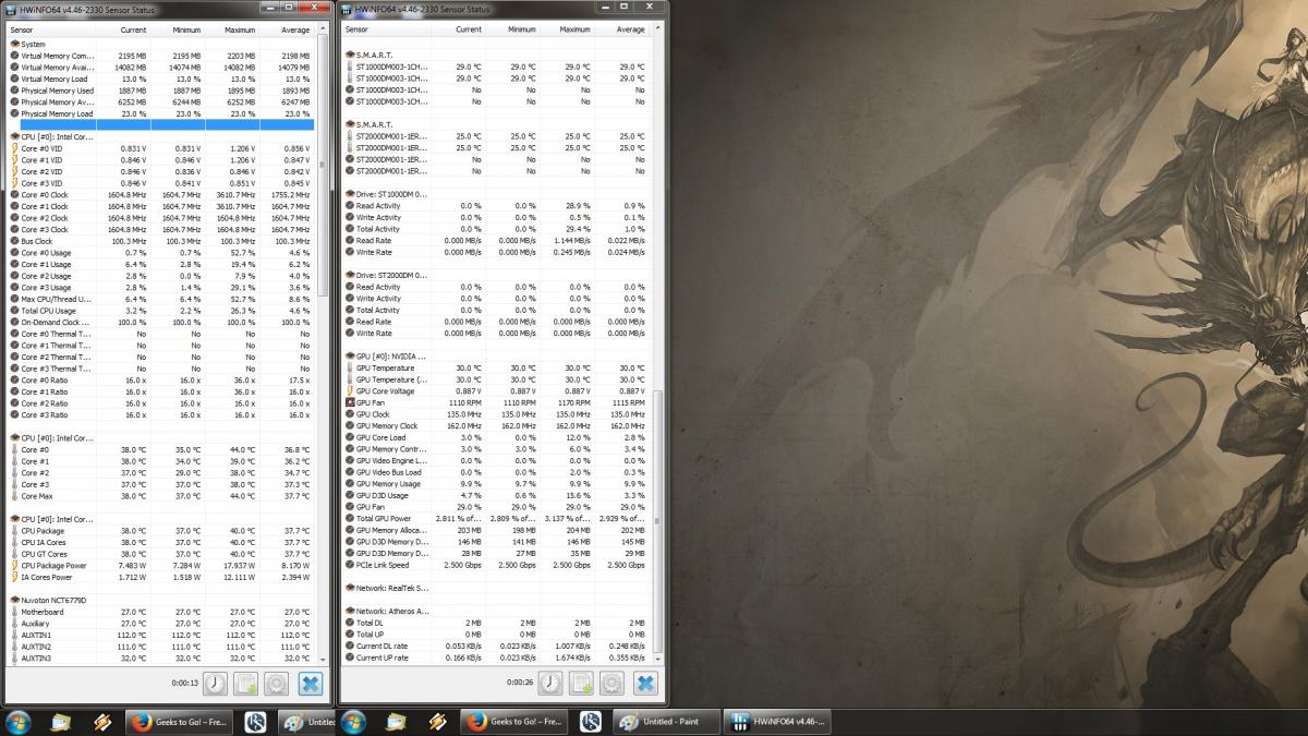

  • 99 posts

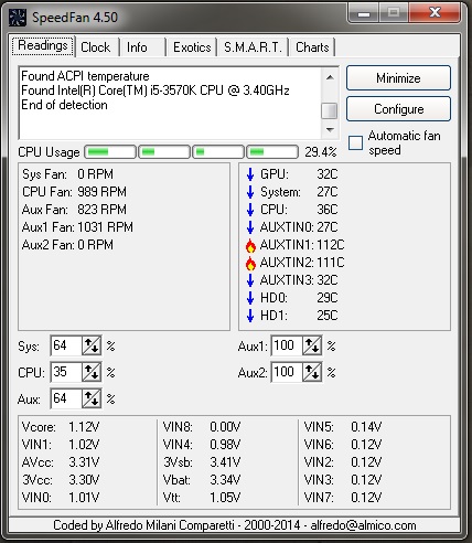

The same programs under load. HW doesnt seem to wanna run a second time to get the other half of results.

Getting the buzzing without video now, its just getting worse and worse. Like during music and sound effects on windows.

AUXTIN is the power supply  temp sensor if there is one and agreed those readings are very high.
Sorry but that is not the HWMonitor info that is needed, see attachment for example;

Here it is. Should I be worried about doing what I normally do and keeping activity to a minimum?
Edit: pic2 is after a few minutes of doing my usual gaming and viewing streams

Sorry to be a pain but as post in my reply #22 attachment we need an expanded screenshot of HWMonitor so that we can see the details for (the GTX 760 in particular) all items of hardware.
If you have a small desktop fan and it is safe to do so (no children or pets around) take off the side of the case and direct the desktop fan towards the inside of the case to see if the temps come down any, if no desktop fan let us know as we need to try and get those temps down somehow.

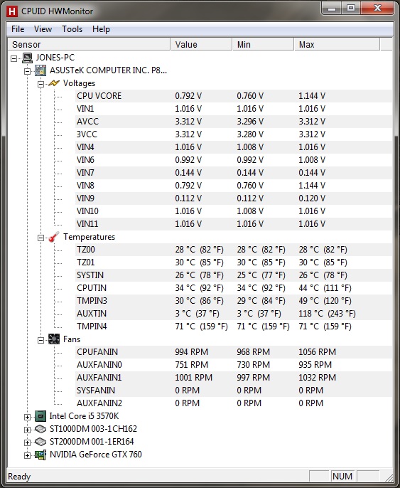

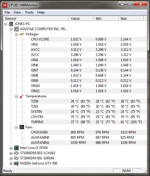

Does the location of the PC tower matter? Mine was in a confined desk which hides the tower completely out of sight. I have moved the tower to above the desk and CPUTIN and TMPIN3 dropped 10C.
Edit: Should SYSFANIN and AUXFANIN2 be running?

The location of the computer itself + where in the case the chassis cooling fans are located has an awful lot to do with how high the temps will reach, for the most effective cooling there should be a fan at the front of the case to draw in cool clean air and an exhaust fan at the rear of the case to expel the hot air, good internal cable management and an unrestricted airflow around the case is also a must, if you do not have this the internal heat cannot escape and so gets hotter and hotter.
CPUTIN is a CPU MB temp sensor and TMPIN 3 is a MB sensor near the GPU.
How many internal case fans do you have.
BTW you need to click on the + signs to get the HWMonitor information for the hardware items at the bottom of your screenshot, the CPU, GTX 760 and HDDs etc.

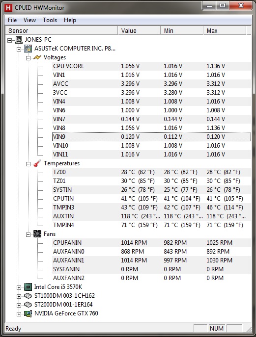

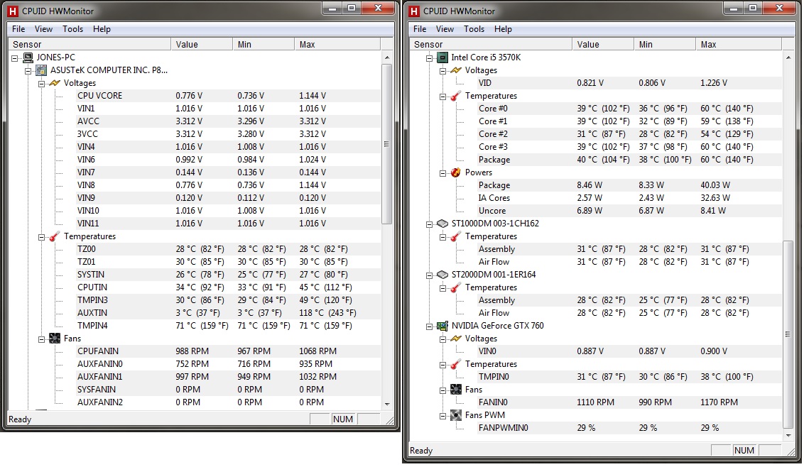

I have 5 fans inside the case itself, 1 in the front, 1 in the back, 1 on top and 2 side fans.
The wires inside the case maybe need re-doing? Its a bit of a mess inside the case at the moment and have tried to keep some of the cables out the way to prevent them from getting in the way. I do have cable ties so I think it'd be quite the challenge to see what I can do to make it a bit neater.
I made an attempt with the help of an extension cable to get my fan on the tower with a panel open but I dont think it done much good but having the tower on top of the desk has definately reduced the temperatures as you said.
Still been running the HWMonitor thing, had the case panel open then closed it back up, the temps went up a little but it settled again.
Edited by agent_numpty, 23 November 2014 - 09:09 AM.

You have a good cooling fan arrangement and excluding the MB your hardware temps show that it is being cooled efficiently, the MB inc chipset/s are not though, tidying up the internal cables and permanently improving the airflow should help with this, hopefully no long term damage caused by excessive heat will have been done.
Apart from the CPU your MB only has two 4 pin fan headers that monitor + can control the fan speeds, try increasing these fan speeds to a bearable noise level to drop those temps further.
1 x CPU Fan connector(s) (4 -pin) Monitored and manually controllable.
2 x Chassis Fan connector(s) (4 -pin) Monitored and manually controllable.
1 x Power Fan connector(s) (3 -pin) Monitored if the PSU is connected to it but fan speeds not controllable.
