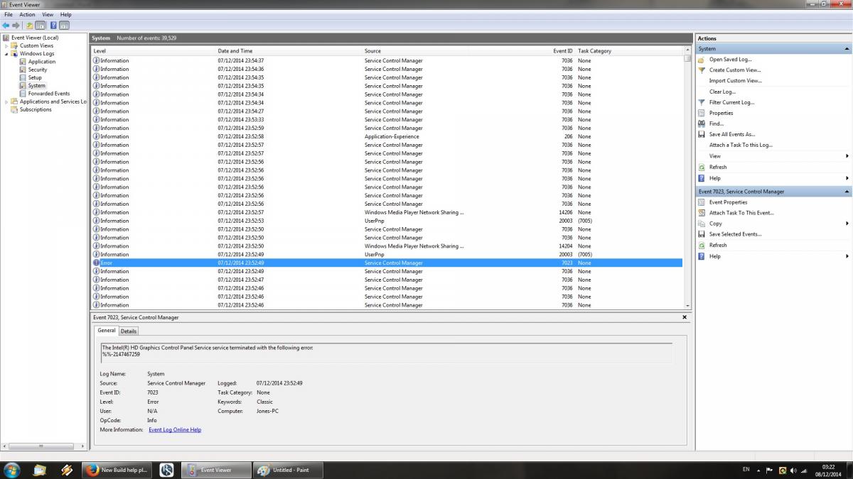

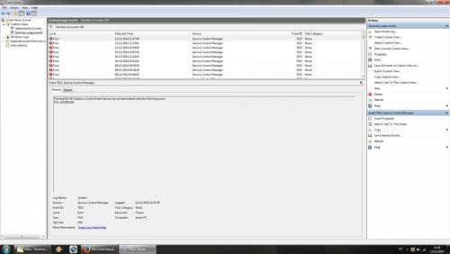

agent_numpty
agent_numpty
  • 99 posts
I've only included 2 screenshots (the ones about taking screenshots when opened initially were useless as there would be no errors showing). I've highlighted the errors that happened around the time of the PC freezing.
Small update: Thought the clue was the Intel HD Graphics Controller, have looked on Intel's website. Have downloaded and installed the latest drivers. Will let you know later if that has any effect.
Edited by agent_numpty, 07 December 2014 - 09:49 PM.

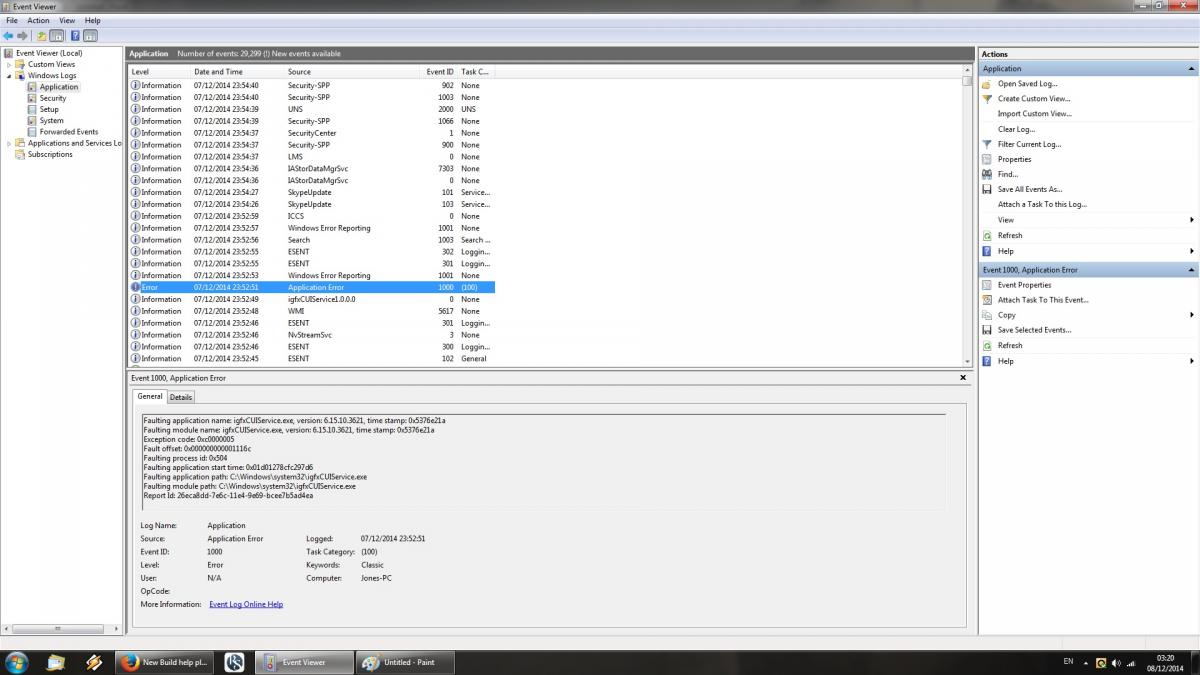

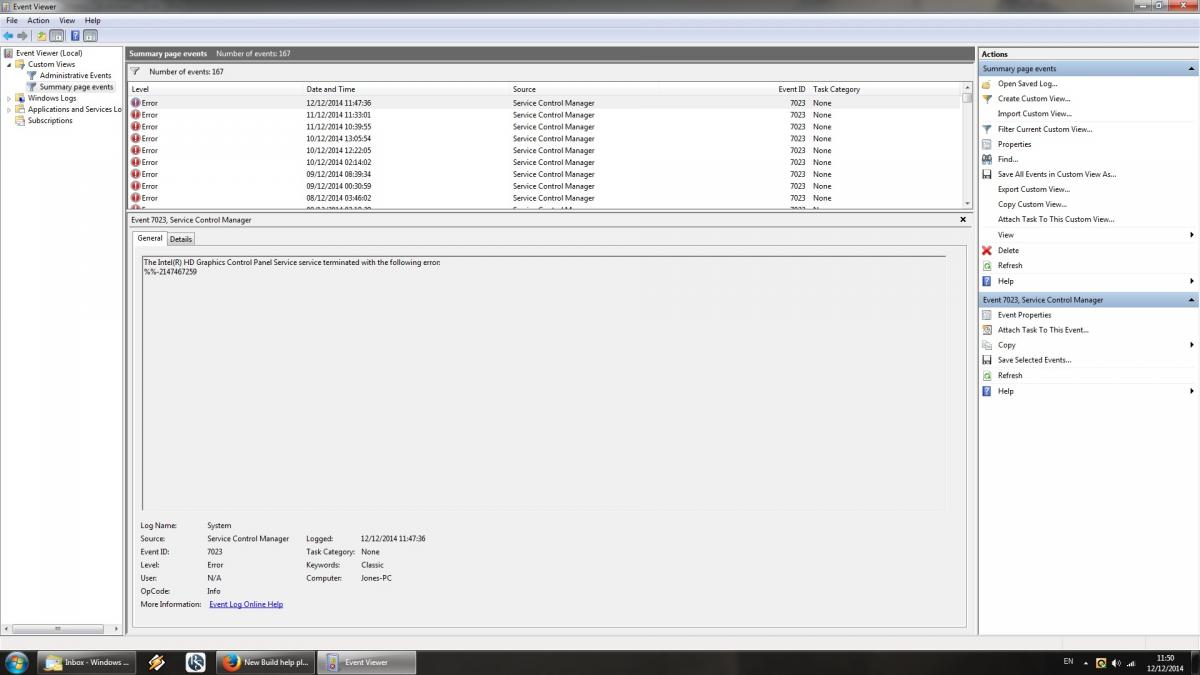

Here's the 2 screenshots again:

Updating from the manufacturers website is the right way as they often tweak a driver, especially MB ones.  I asked because if you had updated the drivers for the Control management from the Intel site, it may be a different ver. number and not tweaked.
Looking a screenshot #2, Error, time stamp 11.47,36. a request was made to start a Service, this failed.
Screenshot #1 show the Service called, which failed, time stamp 11,47, 38.   The service is igfxCUIService.exe.
This appears to be part of the integrated graphics, a call to start it, but as you are using the add on GPU, there is a conflict.   There are a number of solutions, the simplest that works for many is,
> Enter BIOS, > Ai Tweaker, > EPU, > select Disable,.
Go, > Advanced Menu, > Graphics Configuration, > Primary Display, > select PCIe.
Go, > Exit, > press F10, > confirm Yes.
Are you still getting the errors reported?
