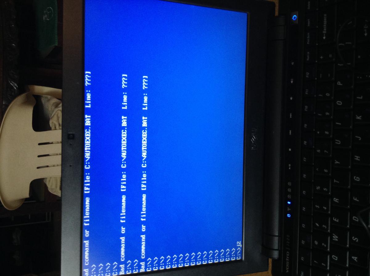

Elton yu
Elton yu
  • 159 posts
So it passedeverything except for the hdd thing,then after the diagnostics this came out
iammykyl
iammykyl
    Tech Staff
  • 7,659 posts
Well that is some progress, at least we know it is the HDD.  Don't know what the message mean.   A Log would have been generated, but as you can't access the HDD, not much good.
