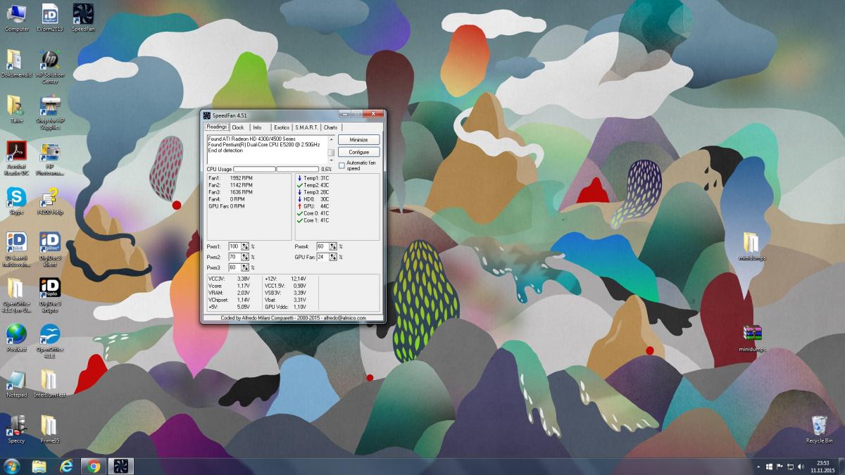

Rounding errors are caused by unstable voltages so we should check your PSU output,
Please take expanded screenshots and only use the method below to attach them.
Download Speedfan and install it.  Once it's installed, run the program and post here the information it shows.  The information I want you to post is the stuff that is circled in the example picture I have attached.
rei158
rei158
  • 136 posts

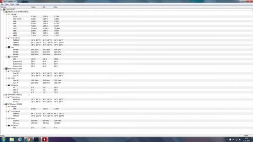

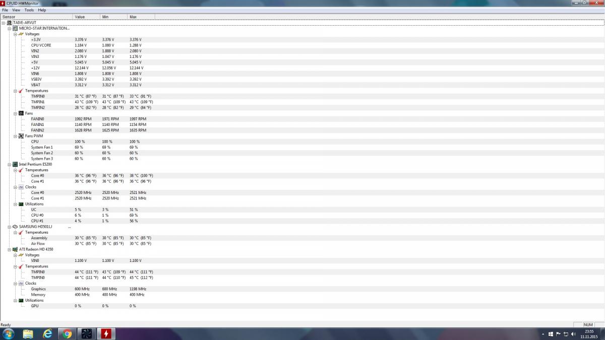

Here they are.
Sorry that SpeedFan picture isn't zoomed in enough :D
Edited by rei158, 11 November 2015 - 03:58 PM.

One of the memory slots is showing too high of voltage but other than that everything else looks ok, before suggesting any hardware check that involve opening the case we should take a look at the drivers, this can be long winded sometimes but at times can be quite quick, please read the following thoroughly before proceeding;

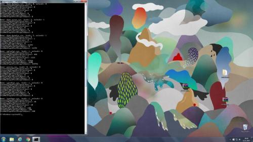

Is this normal? It is frozen. Or it should boot to desktop and verify in desktop?
Also there was no option for ddi and concurrency.
EDIT:
It was a freeze I guess. Restarted and it just booted like normal. Then I went through making those verifier options again and rebooted. It just booted up normally, queried the verify in cmd, it gave some long texts, but didn't look into it much. I haven't reset the verifier yet and will be going to sleep. Will be back at the same time tomorrow.

Have you checked whether or not DV is running by following the steps included in my reply #19
- For Driver Verifier status
--- select last option, 1st screen -or-
--- type verifier /query (in a cmd/DOS screen)
Can you upload only the last two dumps for us to take a look at while you check to see if DV is actually running.

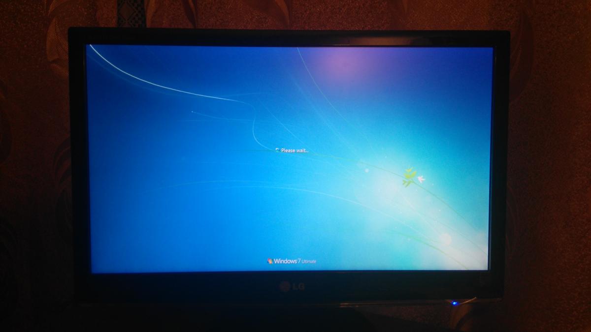

That last answer was poorly written: both instances traced back to the same folder, but
there is only one csrss.
In Safe Mode only, I kept the computer running for 10 minutes, all seemed fine.
Then went to Safe Mode with networking and on first boot it crashed in "Please Wait" welcome screen
and gave 0x101 BSOD.
Then I tried again booting from Safe Mode only, no problems.
Now I am writing this in Safe Mode with Networking and it booted up normally.
Included the BSOD file just in case.
