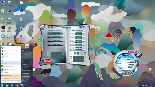

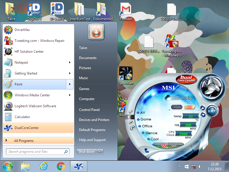

Well, I attached the external GPU for this part as it was too hard and frustrating do deal with the lagginess of this application.
Made some screenshots of the monitors it had.

Everything looks ok in the screenshots.
Final things that I can suggest before you need to visit a tech.
Try an alternative PSU.
Upgrade the BIOS to one of the two latest ones available from here
Remove the CPU, clean off the old thermal paste and reapply a good quality compound such as Arctic Silver 5  or similar.
