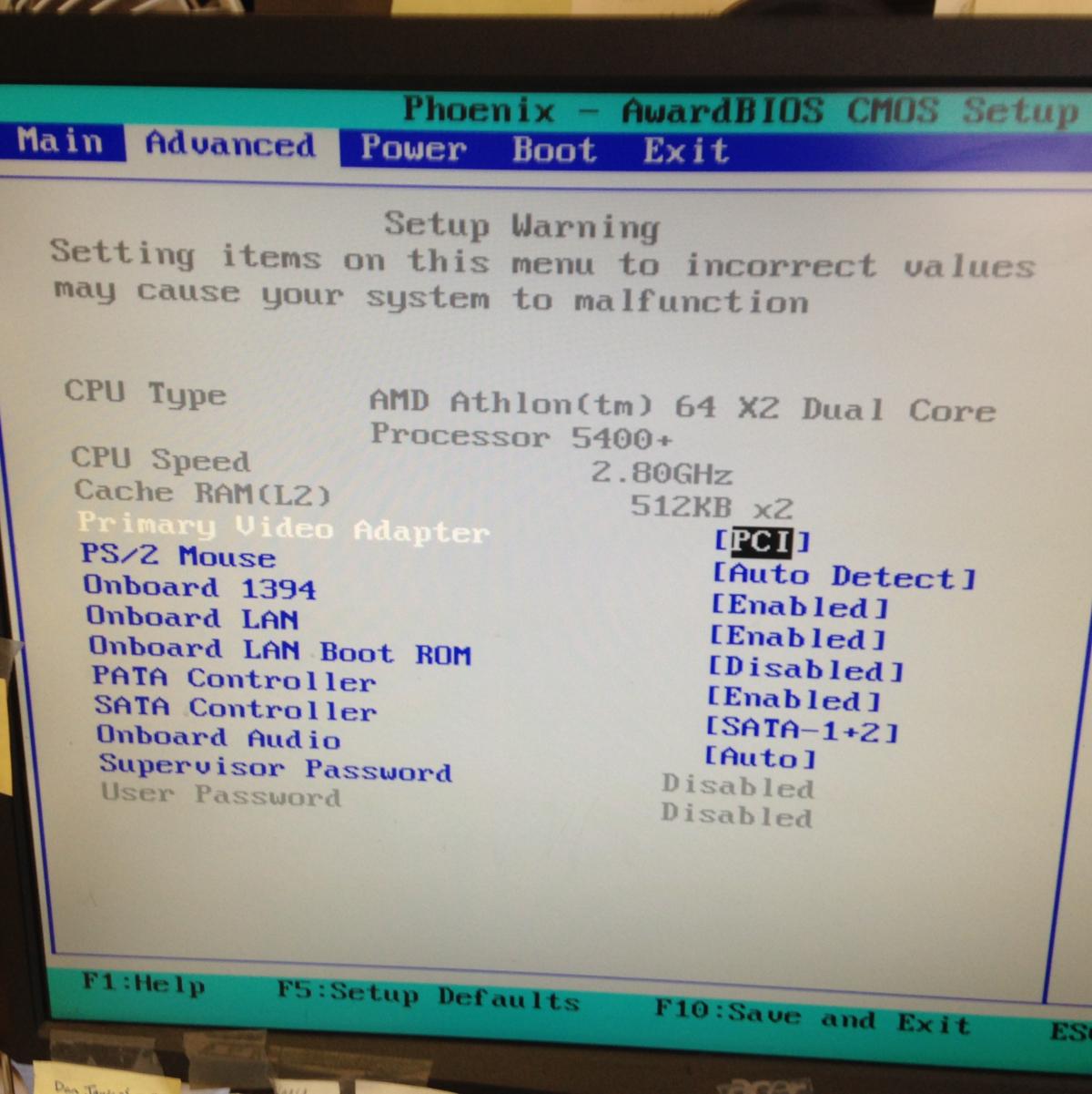

  • 117 posts
it is different, see attached image - perhaps i'm in the wrong place?  This was accessed via F10 during start-up
There is no image attached! If you don't have any similar settings then probably the BIOS doesn't have options to change that and in that case the problem is something else.

  • 117 posts
Hi...do not have the vista disc or any repair disk for the machine - reattached the file

  • 4,978 posts
Yep there is no option to change in your case.
