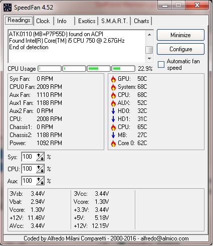

I tried running the Auto OC Tuner Utility, then restarted my computer and let it idle for a few minutes. Here's my latest Speccy snapshot:
http://speccy.pirifo...pqHngF6DQYRnXQF
And here's the SpeedFan report:
Memory usage is still >50%, although system temps are quite a bit higher. I also had to move my computer b/c my toddler kept getting into it, but I can't see any reason why that would affect the temps, so I imagine that's due to the overclocking. Is there anything of note that jumps out at you here?

  • 25,101 posts
Thank you for the update dvd7e  :thumbsup:
The AI program is making things hotter so I suggest that you disable it asap.
Cost and convenience wise you are only left with having the PSU tested now, the high temps are effectively frying your hardware which unfortunately may have already suffered long term damage, the MB itself is the only other thing that controls voltages going to such items as the CPU, RAM and PCI-E/PCI slots by way of voltage regulators (VRMs) and MOSFETS, if faulty they generally are not a cost effective repair.
