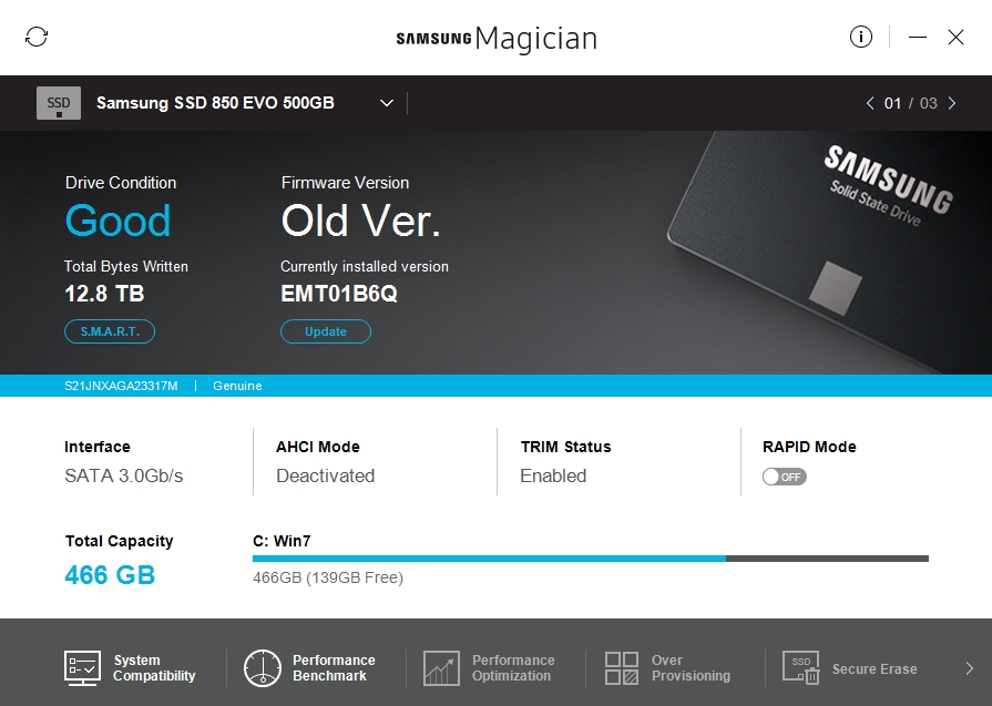

Can you find this page in Samsung's Magician?
I'm thinking your firmware is not up to date also it shows the speed of the SATA interface.
#382
hmp3
hmp3
  • 612 posts
My PC was built late 2008, maybe it my Mobo doesn't support 6gb/s or AHCI?
#383
  • 24,734 posts
Go ahead and update the firmware.  Perhaps that will make a difference.

Also go into device manager and open IDE ATA/ATAPI Controllers
Right click on the controller you see and select Properties.  See if it is working properly and if you can update it.  Also
then click on the Details tab.  Change Property to Hardware IDs.  Click on the top one then right click and copy.  Paste that into a reply.
You probably told me already but what make and model PC is this?
#386

Appears your mobo can only do 300 on the SATA.  Expect it could do ACHI but that would require a BIOS setting  change then you would probably need to reload Windows.
Didn't find instructions for your P6T but for a similar mobo:
https://docs.oracle....iakd/index.html
You might look in your BIOS setting and see if you have similar options.  The lack of ACHI and the SATA 1 interface explains the slowness of the drive and probably the problems with Page Faults since because the drive is slow the impact of a page fault will be much greater.

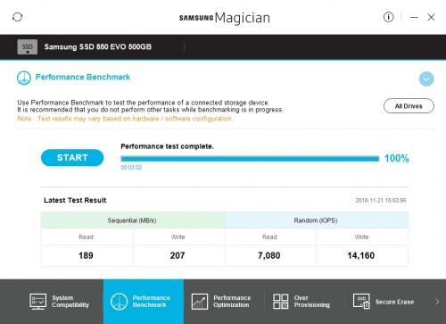

Okay I just performed the fw update on samsung magician. Restarted noticeably slower.
System tray notified me that the ata controller has installed. Restarted noticeably slower.
Disabled network & AV, terminated most non-system programs loaded in system tray.
Clicking Safely Remove still takes just as long to display the notification window. Scanner still shows the usb 2 warning.
Performed Magician Benchmark:
