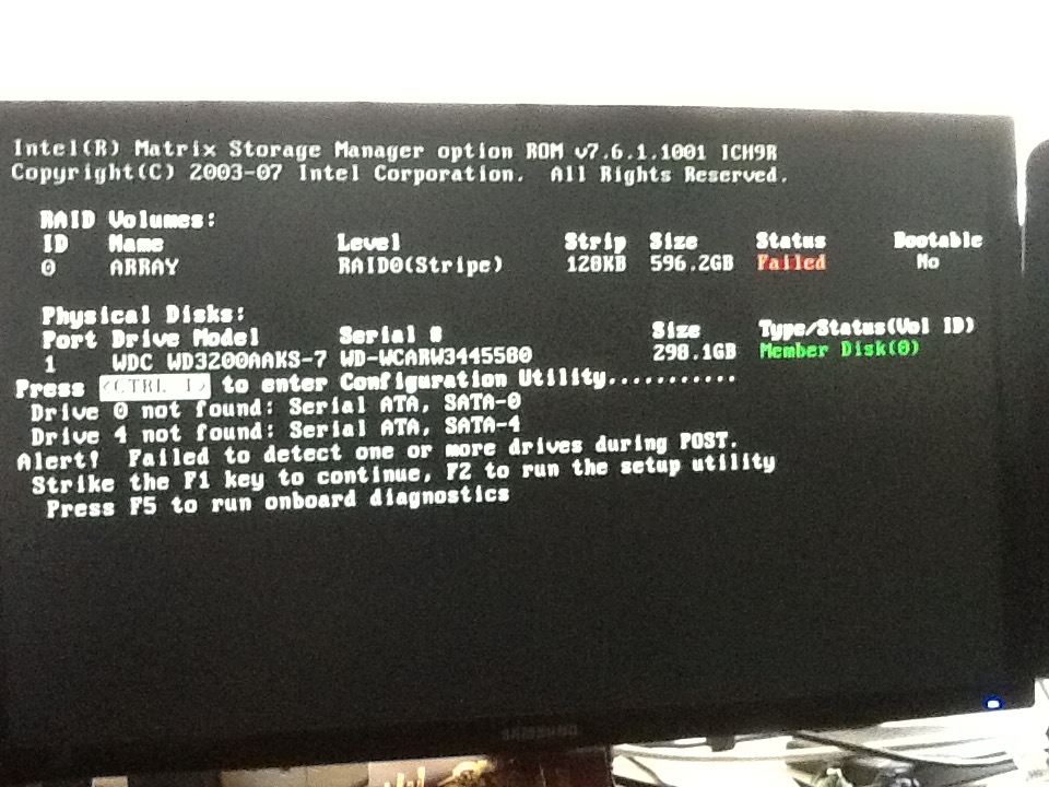

I have the above system, and until a power cut yesterday it was working well,
Since the powercut it will not boot, I get a notification: RAiD0 (Stripe), strip 128kb,Size 596.2 GB, status Failed,bootable No.
Anyone any ideas what this means. The Os is windows10 and clean installed after a replacement PSU was fitted.
As a by the by I have run all of the internal system tests and all seems Ok, unless of course I missed something.

The screen I have up shows the following regarding the drives,
Port 1 drive: WDC, Model:WD 3200AAKS-7, Serial: WD-WCARW3445580, Size298.1GB, Type/Status (Vol ID) Member Disk (0)

Iv attempted to attach a photo of the screen I'm on but not shure if it worked so will try againimage.jpeg

  • 25,099 posts
Hi Jim,
May be obvious to you, this PC has two 500GB drives, and both are origional,
Is it possible that you have two HDDs, one a 1TB partitioned into two and the second a WD drive detailed below.
Your screen shot shows that what appears to be your C: drive (Drive 0) has been changed to RAID somehow and the HDD connected to SATA port 1 is a 320GB Western Digital Caviar Blue drive, you can confirm the latter here Dell p/n: KX795
This unfortunately may mean that you will have to reinstall Windows  :(
Is there any data on the boot drive that you would like to try and secure.
In case you are not aware, the HDD passed the diagnostics test because it was tested for functionality and not that the OS was bootable.

  • 25,099 posts
Hi Jim,
So what do we do now?
Reinstall Windows 10 I`m afraid, on brand name computers that have been upgraded from one or more OSs this does tend to be inevitable at some point with OEMs such as Dell and HP etc.
Two things that I suggest you do regarding the clean install;
Download and save to a USB thumb drive the latest version of drivers from here
When you install Windows, install it to its own partition, make the partition at least 256GB, this will allow for the present OS and the many future updates.
After the clean install, see how the computer behaves, you may not need to install any drivers from the USB device if the generic Windows drivers work ok, any problems though and you need to install the Dell drivers you need to do them in a set order else you will get issues, see info here
