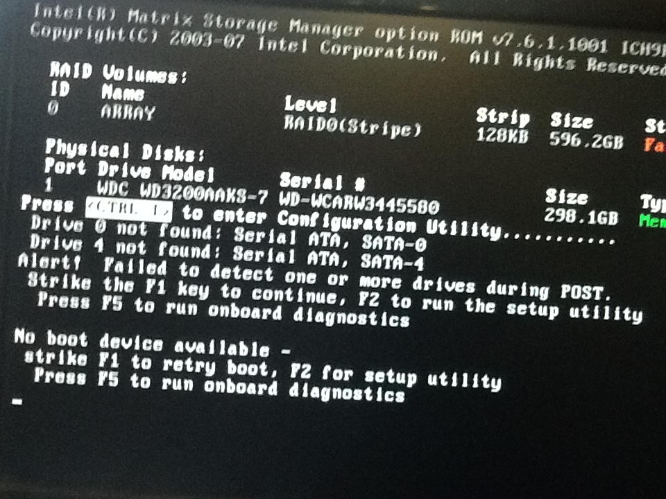

No, the reason why the larger drive will not boot is because there is no RAID software on the drive so Windows cannot read the drive, the drive is unbootable atm.

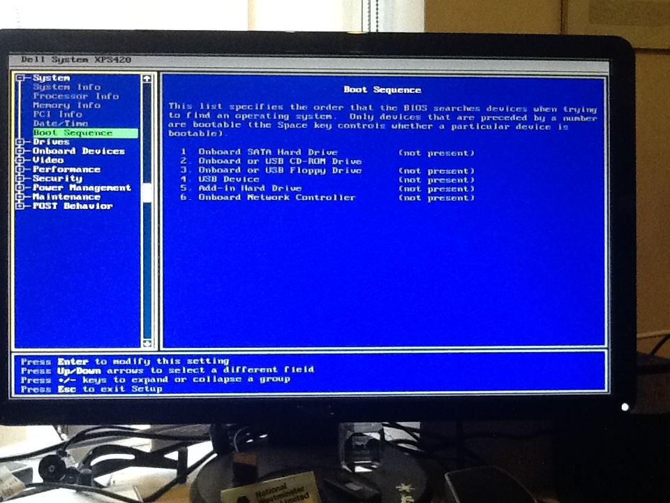

Going back to the XPS, as per your text I have put the usb in the port and nothing happened, so on the screen was a statement, hit F2 for set up and up came the screen. Iv used the up and down arrows just to see the effect but have not gone any further. This is the first time iv been this far inside any program.image.jpeg

To boot from your USB device you need to move it to position 1, save and exit.
Did you notice that the BIOS says that there is no SATA device presently connected to SATA port 1.

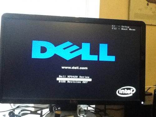

CPU is presumed to be working as when power is switched on the PC progresses to the DELL boot screen (photo1) therefore startup protocols must be running and to a point be effective.
On boot up PC hangs at DELL boot screen and then the following screen is accessed after the F1 key is pressed (photo 2).
And on pressing the F2 key the following blue screen , after scrolling down to the drives list (photo3).
A number of attempts have been made to reorder the boot sequence without success and rebooting from a USB pen drive with the current Windows 10 ISO has also failed.
Presumption is that if all other elements are working then the problem may lie in the Hard drives, either one, or both, if this is so replacement of the hard drives is a possibility but, which type, replace like for like, or add one or two Seagate Barracuda 1TB drives?
However why does the system display that non of the drives can be found?
How or why does the system display RAID 0 and what precisely does this mean, and how can this affect the operation of the unit in the future?
