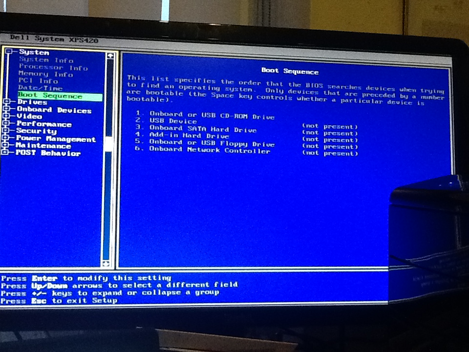

Ok, so iv been back a step, removed and replaced the CMOS battery reset the date/time and rebooted, all OK to the usual point, when it went to the blue recovery screen.
All power off, began moving the  SATA connections around the MB, all came up with drive 1 not detected, repeated the process with the seagate drive, same result, returned the drive connections to their original positions on the MB then disconnected the seagate, rebooted, back to the blue recovery screen, cant seem to get past that now.
any further thoughts?
Have you any thoughts on Mr Mccoys comments#48?
The kit, physically seems ok but I cant confirm this, Iv also taken a look at that error code, seems it can be caused by a power failure, so Im beginning to consider its not something Iv done inadvertently.

Can I ask what happens if you try swapping things around and powering up without the USB thumb drive inserted, we need to consider the possibility that it is the media on the thumb drive that is at fault, the USB method goes so much smoother on newer and non OEM brand computers like Dell.
Do no harm to do what Darrin suggested in his reply #48 but if my memory serves me right it was the Seagate HDD that flagged up being RAID enabled whereas it is the WD Caviar that you have been trying to install Windows 10 to from your USB thumb drive.
Is burning a Windows 10 ISO to a DVD still an option for you.

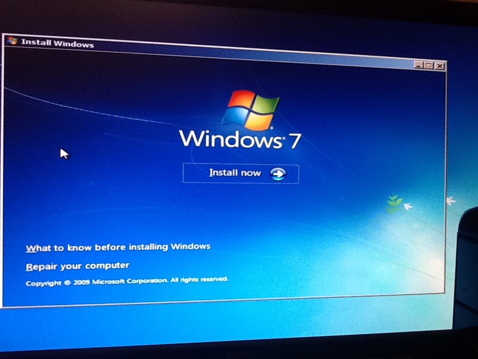

As a follow on from the above , I ran out of ideas, so in a fit of frustration (a common side effect of the illness) I went back to the boot order and moved the CD ROM to the top, then rebooted the system, just as the DOS screen came up I put in my W7 DIsc and lo and behold the screen you can see now. I am tempted to go to the repair your computer element but I would rather consult first.
Bets regard
jim

  • 25,099 posts
You cant repair anything Windows 10 related using a Windows 7 disk.
If you have the product key for it and it is not already in use you could try installing Windows 7 but as I asked is burning a Windows 10 ISO to a DVD still an option for you.

Done, DOS screen
No boot device available
1 does GTG have any for of live chat?
2 I propose to disconnect the seagate as we seem`d to make more progress when it was disconnected

  • 25,099 posts
Would put the Seagate to one side for now and connect only the WD.
